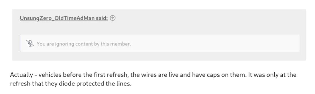

And if the wires were live, don't you think it would have shorted, triggered all sorts of errors and caused power drain long ago?
Actually - vehicles before the first refresh, the wires are live and have caps on them. It was only at the refresh that they diode protected the lines.
Just some edification for folks in case maybe someone gets a used '22 early '23 and comes by this post.
Obviously that is not the case for the OP with a '25 model.

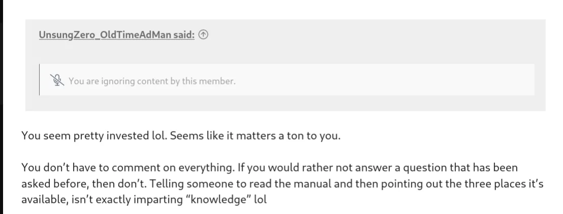

You seem pretty invested lol. Seems like it matters a ton to you.
You don’t have to comment on everything. If you would rather not answer a question that has been asked before, then don’t. Telling someone to read the manual and then pointing out the three places it’s available, isn’t exactly imparting “knowledge” lol
Why reinvent the wheel over and over. Rivian spent a bit of time putting together and maintaining an "owner's guide" with all sorts of useful information. Guiding people to that rather than answering one specific question might impart WAYYYYyyyy more wisdom than just that simple answer.
The part that frustrates people into not wanting to answer every little question is that most of these things can be found with a simple search.... which for this takes you right to this exact question that was asked previously....
