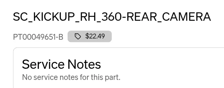

You didn't get this from me:
PT00049651-B
Rivian R1T R1S R1T rear bumper camera wiring harness 1000008388
