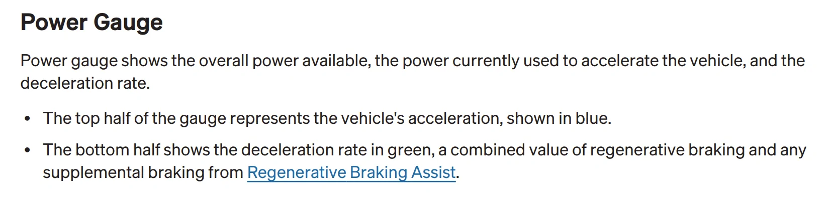

One note: the "Regen" section of the meter isn't purely regen... Use ACC or HA when a sudden slowdown occurs and the vehicle is using active braking and observe the meter. I think you'll be surprised.
Rivian R1T R1S Regen or Friction? How Highway Assist Actually Slows You Down 1758894876776-09
That's a good call it! I know that meter definitely lies, I've noticed as much when regen assist is turned on as well. That's why I wanted to look at how much the brake pedal was physically moving
