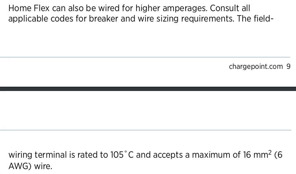

This detail is key for the OP. The ChargePoint Home Flex can accept a maximum of 6 AWG so 4 AWG into the ChargePoint is not an option. This is also why hard wiring the ChagePoint for 48A charging requires 6 AWG THHN instead of NM-B (Romex).
Edit: I am most definitely not an electrician so not sure about compliance on this but it may be possible to run 4 AWG to a junction box near the charger and then run 6 AWG wire to the Home Flex from there. You'd definitely still be limited to a 60 A breaker in this scenario but if you needed more in the future, it would only require rewiring between the junction and the charger (likely to happen anyway if future EVSE comes with a pigtail) and swapping the breaker as opposed to replacing an entire 80 ft run.
There are a couple of options for this wire size issue. In all cases the breaker must be rated for the #6 wire, not the #4:
1) As you mention, install a box and pigtail the #4 to #6. For this size wire, do it right by using the butt splice or split bolt , not wire nuts. This could possibly be done inside the EVSE if space permits.
2) If running #4 stranded wire THHN/THWN, you could remove a strand or two so that it just fits tightly under the #6 sized terminal. Yes, we could debate that removing too many strands will reduce the effective wire to less than #6. If that is concerning, just do #1 above.

So I am new to the EV world. Getting my truck delivered next week - I have decided to get the Chargepoint Home Flex (NEMA 14-50) EVSE installed in the garage. THe panel is on the opposite side to the garage and so we have about a 80 Feet run. The electrician is going to install a 50Amp breaker with the 14-50 outlet and 6/3 wire.
My question is - will that be too much of a drop in the voltage with the 80' run and hence extra charging time? OR is it not that big a difference?
Many thanks in advance!
THanks
RS
Dont use any size bigger than 6 awg wire from instruction manual! My electrician used 4awg and now my charger isn’t working properly and cutting off.

It's not very common for household breakers to be 90C rated though.
Just talked with a member of charging team at Rivian and he said nothing other than 6 AWG wire is supposed to be used. My electrician installed with 4 and 2 gauge wires and my charger has been cutting off after about 10min of charging.
