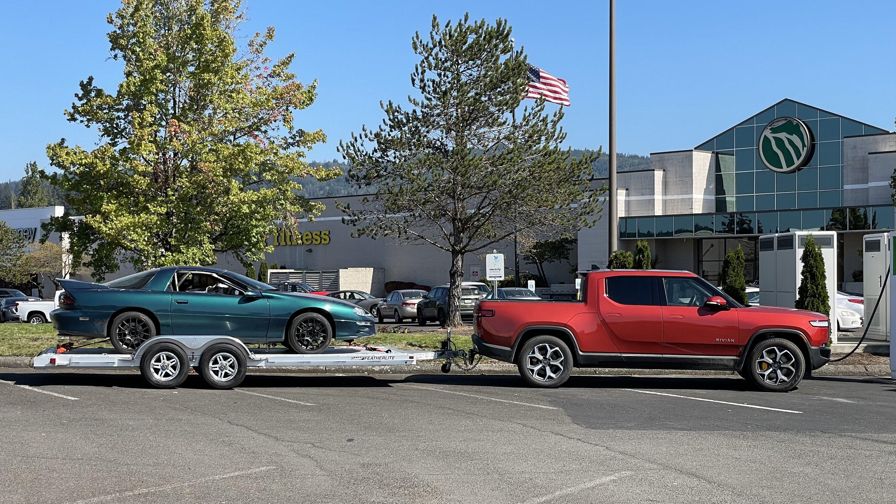

I did another trip from between Seattle and Portland pulling a car hauler. I figured I’d share more data.
- R1T with 21s, with aero caps removed.
- 18’ Featherlite 3182 aluminum trailer (1450 lbs empty)
- 2001 Camaro with no side windows (so presumably extra drag). Full interior removed, but with a cage installed. I have no idea what it weighs at the moment.
- 70mph mean highway speed, down I5. Some city mixed in for charging, etc.

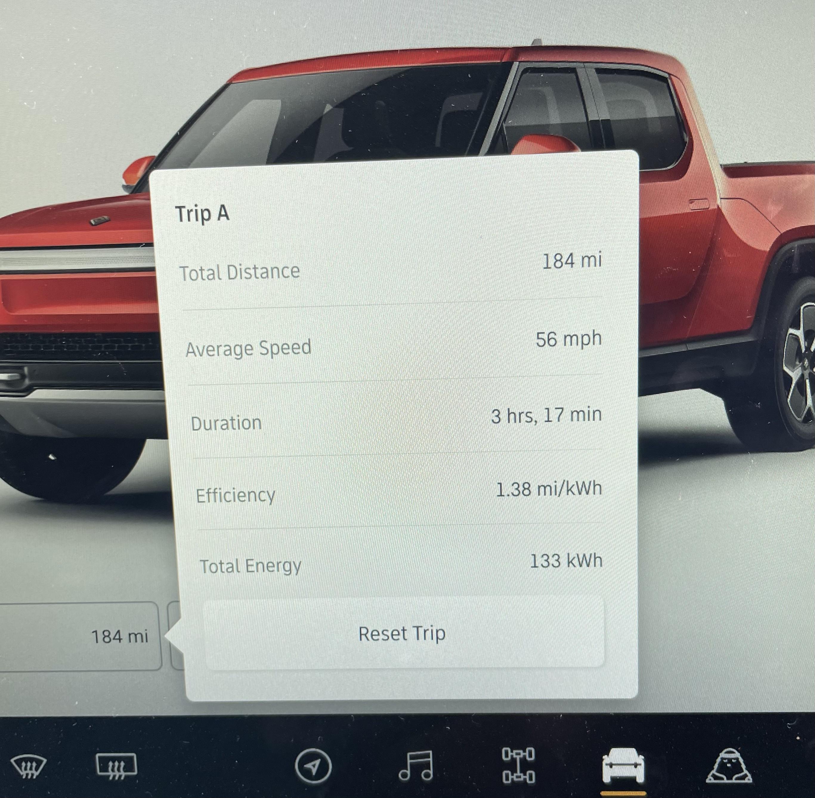

Here’s the efficiency on the way out. This is trailer only. No car. Suspension was in Low setting.

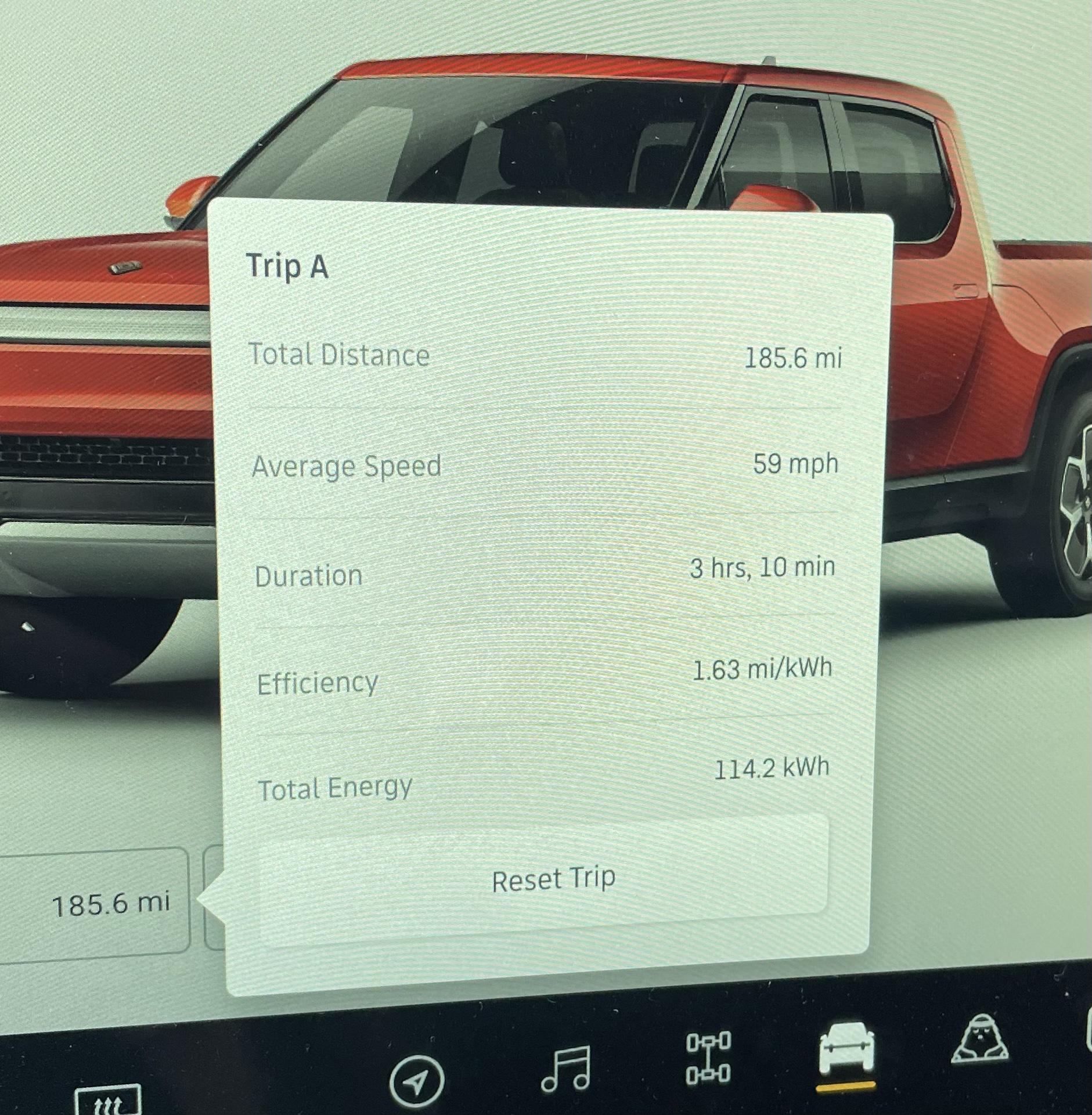

And the way back, with the car in tow. Standard ride height

The rig:
Rivian R1T R1S Another car towing report -- pulling trailer with R1T on 21s 6E168531-FFB7-4285-9ED9-D10282FC6EDE

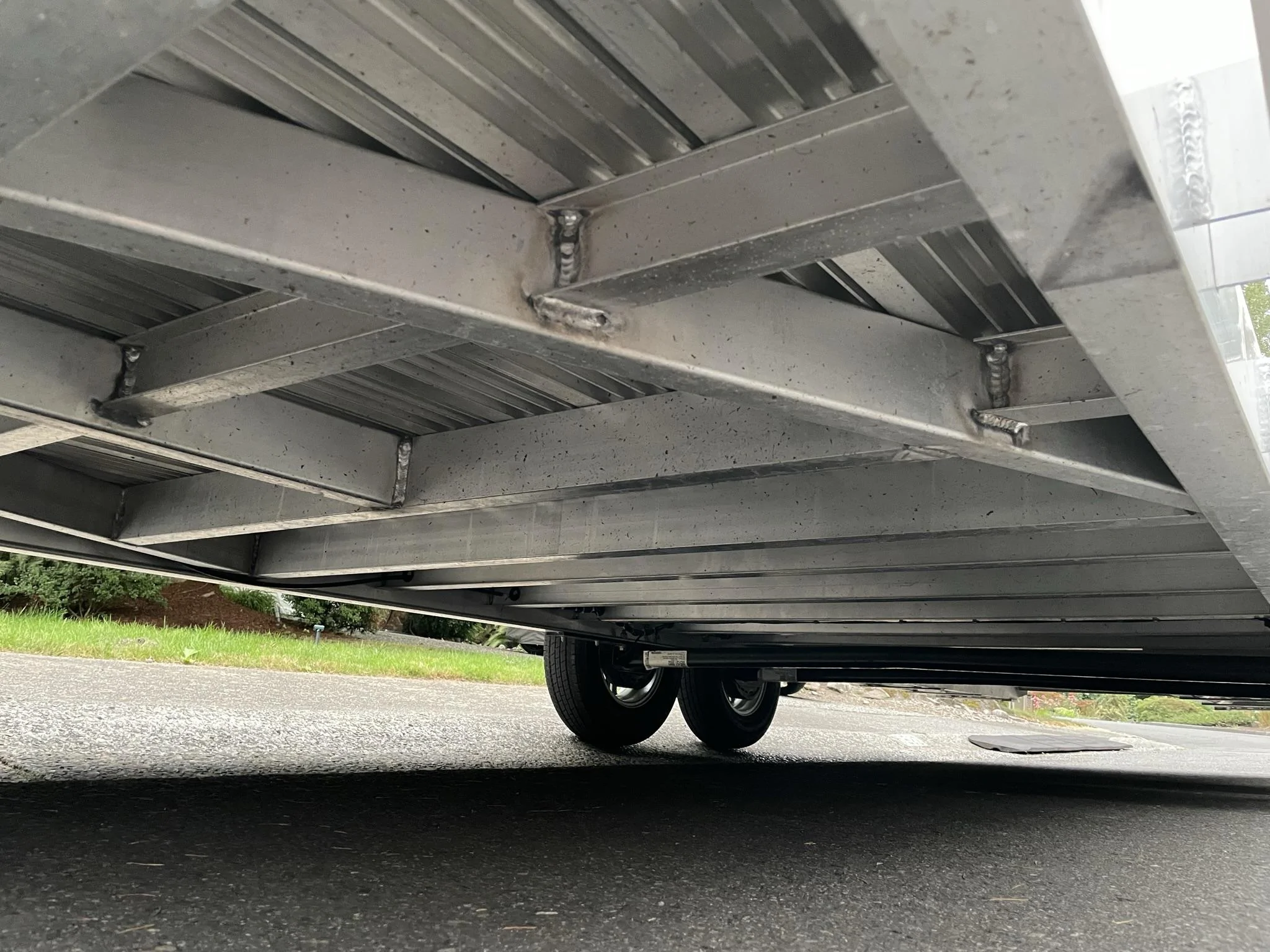

And what the trailer looks like underneath. I suspect this is hurting drag a lot.
Rivian R1T R1S Another car towing report -- pulling trailer with R1T on 21s ADFEBDA3-2818-4270-8E17-6DE8A4C537FF

Those are decent efficiency numbers, only a 30 to 40% range hit (though it looks like you didn't have much left "in the tank" on that second leg). Very helpful data points for folks like me who are planning to tow. If I could be sure that the range hit with my teardrop camper would be closer to 30%, I could live with the Large battery and not have to continue to wait for the Max.
