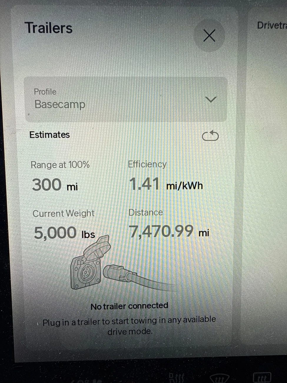

I have an Airstream Basecamp X. I drive a Gen 1 Quad with the large pack. My travels have been in Washington, Oregon, Idaho, Montana. Elevation from 5’ to 8,883’. I usually drive between 55 and 60.
Here are the results.
Rivian R1T R1S Towing + Efficiency: Please post your experience! imag
The 300 miles is a bit optimistic 😆

300 / 1.41 = 212kWh. Must have done a battery swap with a Silverado EV.
Could it be that the range reflects the fact that the screen also says "No trailer connected"? If so, I'd say it may be a bug. What would happen if you plugged in your trailer? Would the range then decrease to what it may be with the trailer?
Any way you slice it, 300 miles is more than optimistic if you're getting 1.41 mi/kWh!

If memory serves correctl, I think it still says the same thing when the trailer is plugged in. The Nav system is fairly accurate though. I drive for around 2 hours or so before charging which suits me well as both the dogs and I have to pee.
