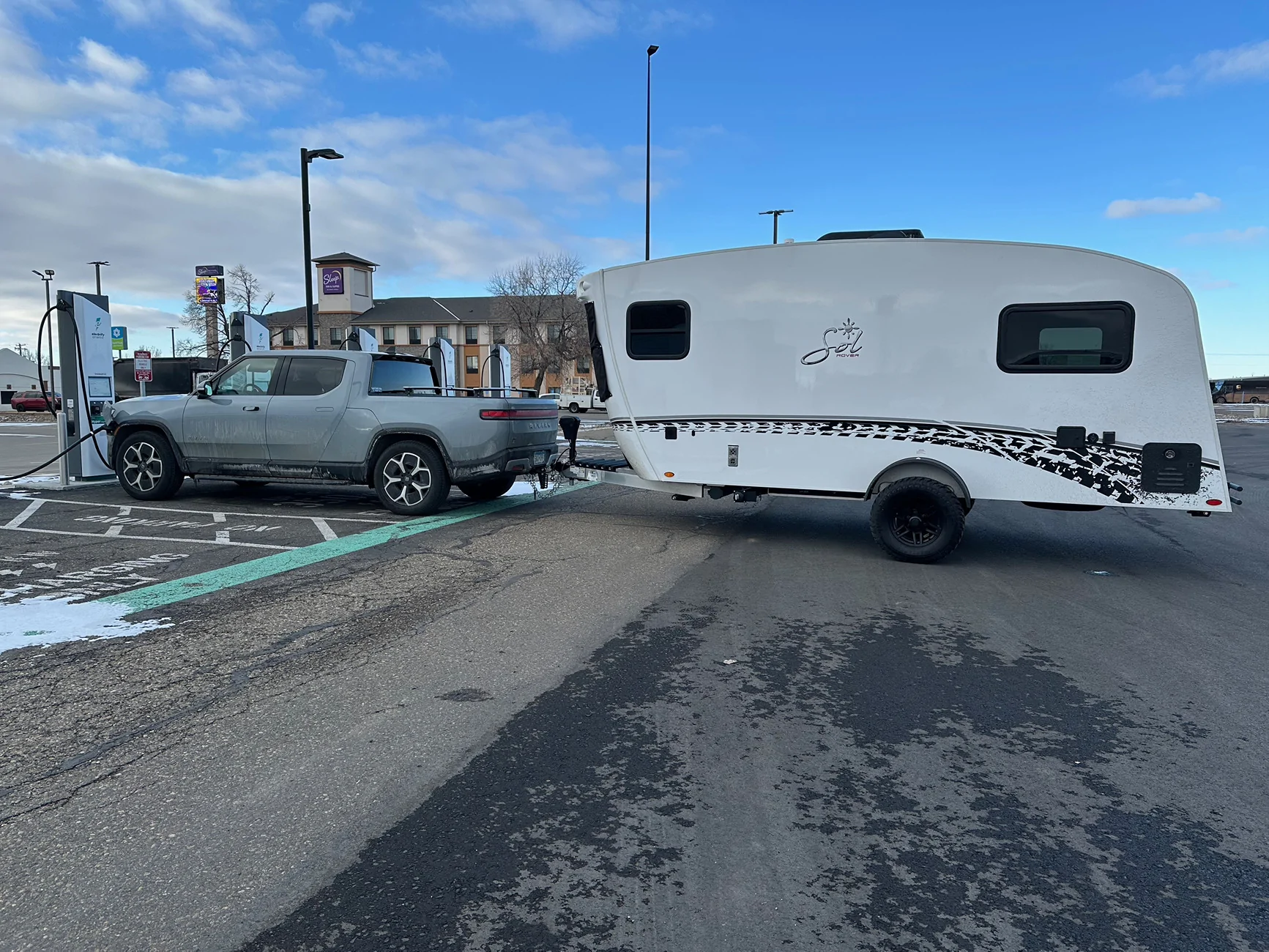

We decided to upgrade our RV from our InTech Flyer Explore to an InTech Sol Dusk. Basically, I'm not doing motorcycle track days anymore, and so I don't need a toy hauler. That, and we wanted a bathroom and a king-sized bed. The Dusk fit the bill, so we started looking for one. The Dusk came out in 2024, so there weren't many used models to be found. We noticed a 2025 (last year) model for sale in Billings, Montana and I decided to got get it and tow it back with my '23 R1T.
So, I charged up to 100% Thursday night, and left home at 5 AM. I took I-94 up to Fargo, ND, then across North Dakota to Glendive, MT, then turning southwest to MIles City and then Billings. I used a combination of Tesla and Electrify America on the way out, and running 75 MPH in MN and 80 MPH in ND & MT netted me 1.46 miles per kWh. Temps started at 7 F, and rose as I got closer to Montana, ending up at 25 F when I got to Billings. I didn't have any issues with charging on the way out.
I spent the night in Billings (the RV place I was buying from comped me a hotel room), and decided to charge up to 90% before going over to pick up the trailer. With finance, trailer walkthrough, and the dealership re-winterizing the Dusk, I didn't get out of the dealership untll noon. I decided to top up to 100% before leaving Billings, as the first leg of the return trip from the Tesla Charger in Billings to the EA station in MIles City is 139 miles. I was pretty sure I could make it, so I decided to leave at 97% as the truck was charging very slowly. I started out at 60 mph, but ended up slowing down to 55 mph to make sure I'd make it. I arrived at Miles City with 5% charge remaining, got plugged in recharged.
I won't bore you with the rest of the trip - here's a quick table showing the distance, efficiency and energy I charged up to. Some of the charging is more than I need to get to the next town, mostly because I would sleep in the back seat of the truck while charging.
Billings MT - MIles City, MT: 138 miles, 1.13 mi/kWh, added 111.6909 kWh(EA)
MIles City MT - Glendive MT: 75.1 miles, 0.89 mi/kWh, added 98.2131 (EA)
Glendive - Dickinson MT: 96.8 miles, 0.99 mi/kWh, added 120.2753 (Tesla)
Dickinson - Bismarck ND: 98.5 miles, 0.91 mi/kWh, added 129.0202 (EA)
Bismarck - Jamestown ND: 101.6 miles, 0.89 mi/kWh, added 126.8679 (EA)
Jamestown - Fargo ND: 91.8 miles, 0.76 mi/kWh, added 108.9677 (Tesla)
Fargo - Fergus Falls, MN: 59.7 miles, 0.87 mi/kWh, added 40.4137 (Tesla)
Fergus Falls - Alexandria, MN: 49.8 miles, 0.93 mi/kWh, added 96.5812 (Tesla)
Alexandria-Monticello, MN: 91.7 miles, 1.00 mi/kWh, added 38.9614 (Tesla)
That was enough to get me home to Maple Grove. Overall, on the way back I got 0.97 miles per kWh. Total cost for the trip was $540.25 in charging, with Tesla & EA memberships. I'm aticipating getting around 1.0 - 1.1 miles per kWh once the weather warms up.
Man, there is something about the InTech that I love. We currently have a 2022 Basecamp 20x and while I like it, I keep looking at the InTech trailers. How do you like it so far?

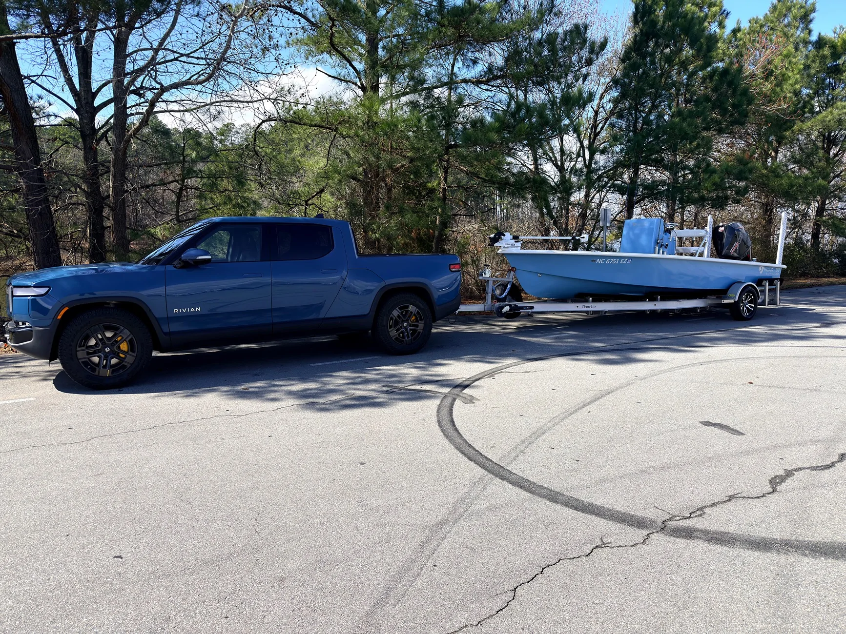

I finally have a long tow with my bay boat to report back on. I have an Egret Moccasin 210, it's a 20'11" bay boat on an all aluminum low profile trailer. Total package should be around 2800lb's. For the South East, the 21' bay boat/flats boat is a very popular foot print.
My dog, 5 year daughter, and I loaded up the truck and drove down I-40 from Raleigh, NC to Wilmington, NC on Sunday. I set the Nav for the destination (151 miles) and set the cruise for 65 mph (speed limit is 70mph) and decided to do whatever the truck told me to do. After self reprogramming the route a few time, the truck decided on one stop at a Tesla super charger for 12 minutes. While this is a bummer because even my old 4Runner could make this trip, I shrugged and told the kid she gets to have a little extra time watching Elena of Avalor. Charging went just fine access to the far right super charger.
When he trip was done, I averaged 1.1 mi/kWh at 65mph. Temp was upper 50's with a small cross breeze. I'm not sure if my tires, temp, wind, or a combo were what was holding me back on this trip.

Most likely is was aerodynamics messing with things - the big flat vertical objects cause a lot of air/wind resistance which will cut down on the distance you can tow.
I'm guessing you may get .2 mi/kWh more if you were to slow down a little bit more - it doesn't seem like a lot, but it adds up. 100%-0% at your efficiency would have gotten you 144-ish miles, but at 1.3 mi/kWh, that number shoots up to 170 miles. This all doesn't take into account terrain, etc., but it give you a good idea of A) just how big these batteries are, and B) how much just a little more efficiency can get you.

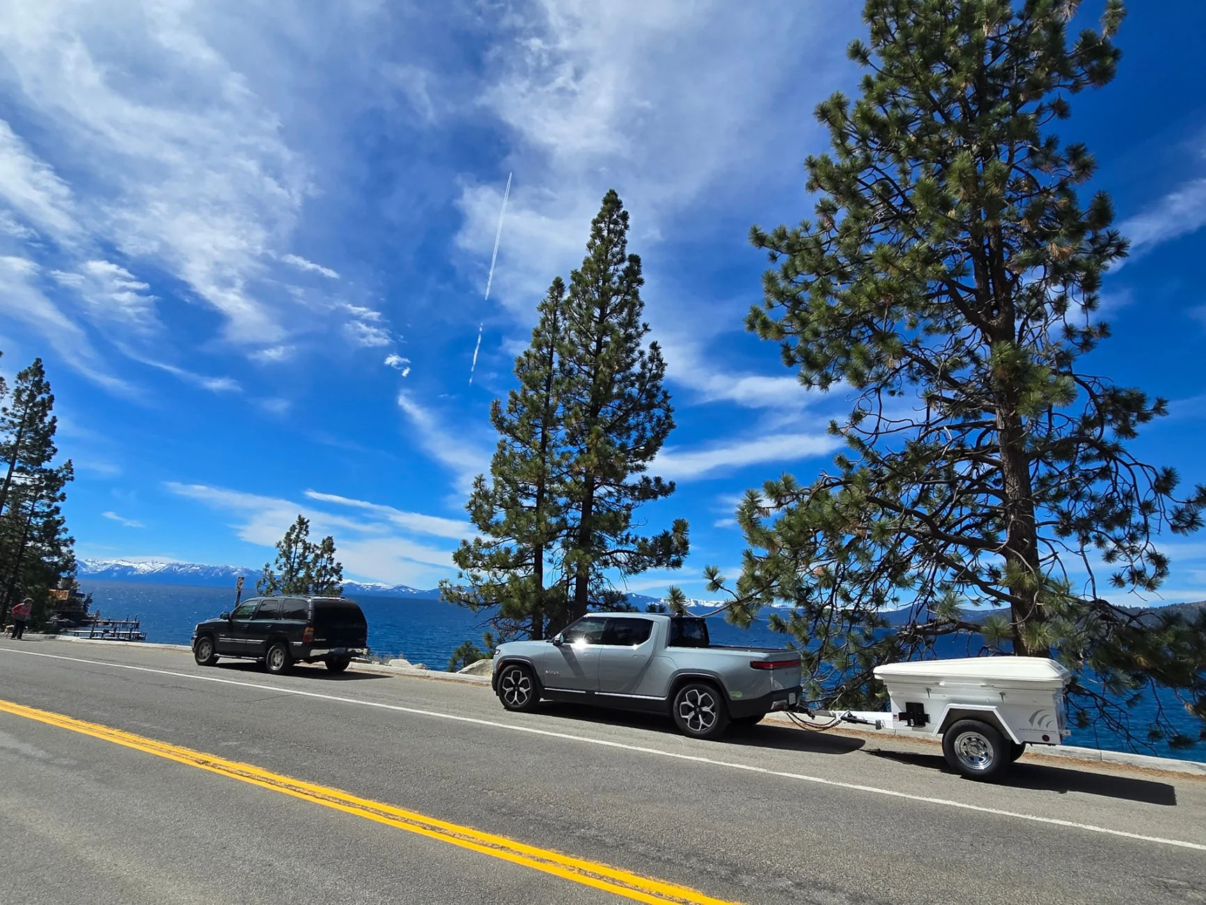

I just got back from a 1350 mile trip to Death Valley pulling my jeep trailer with a rooftop tent mounted on top. It weighs a little over 1000 pounds. We went over several passes as high as 8300ft and were as low as 260ft below sea level. I had several days where we drove into Death Valley and the A/C had to deal with temps up to 105.
My average efficiency for the entire trip was 2.12 mi/KWh. Efficiency with the trailer on was 2.1. The trailer rides in the slip stream of the R1T. Most of the driving was in California where speed limit with a trailer is 55mph. I generally drove 60mph with the trailer on. There was also some light off road driving.
