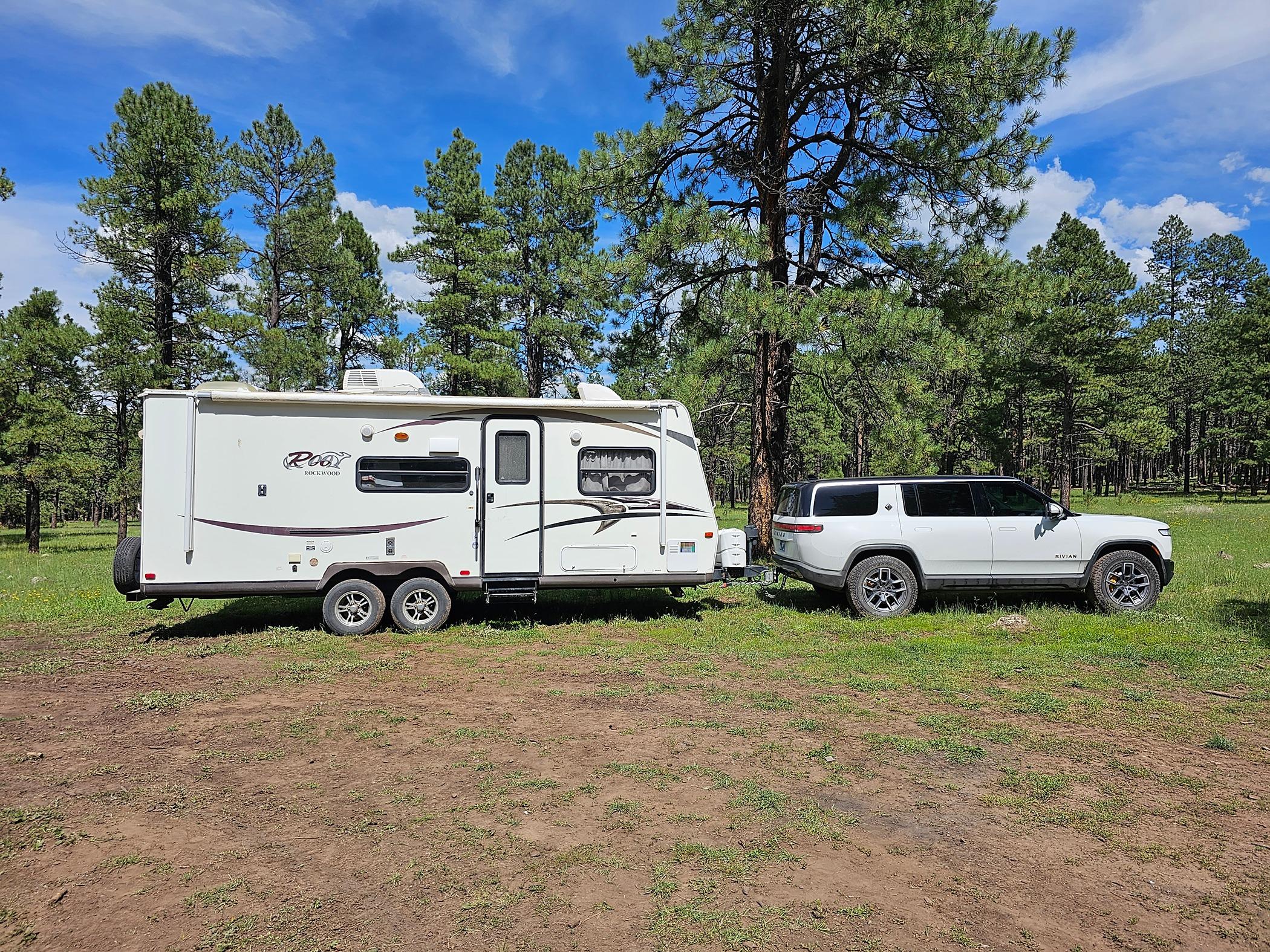

I just followed the installation instructions in the package and it worked out really well. I couldn't be happier with the set up
I had bought the Anderson for my 22' Tundra as my old Bar type would make the Tundra feel like a roller coaster from the bouncing. Everyone on the Tundra forums suggested the Anderson because of the Tundra's car like suspension, and It appears yourself and a few folks on here are using them and happy. I know that for 1 of the charges I plan on using as I head to the Oregon coast will be a trailer disconnect and I'm happy I won't have to deal with the bars. I also appreciate the tip on the kneel function. I'm vertically challenged and have torn ACL/MCL so the kneel feature will be used. I would probably forget about it and drive myself nuts every time the truck kneeled down. :p

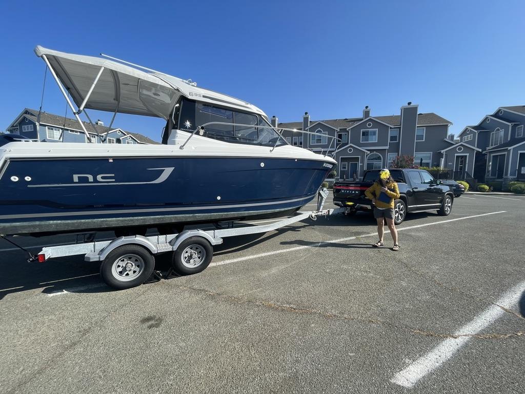

Thanks, everyone. That is great info and confirms my belief that WDH is a must have thing if you tow anything meaningful.
Rivian R1T R1S WDH for towing travel trailer 1716348968609-1o
Well, I consider this baby meaningful even if it's less than 5000lbs and towed without a WDH. ?
