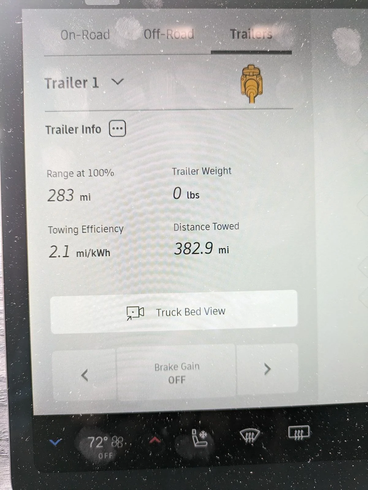

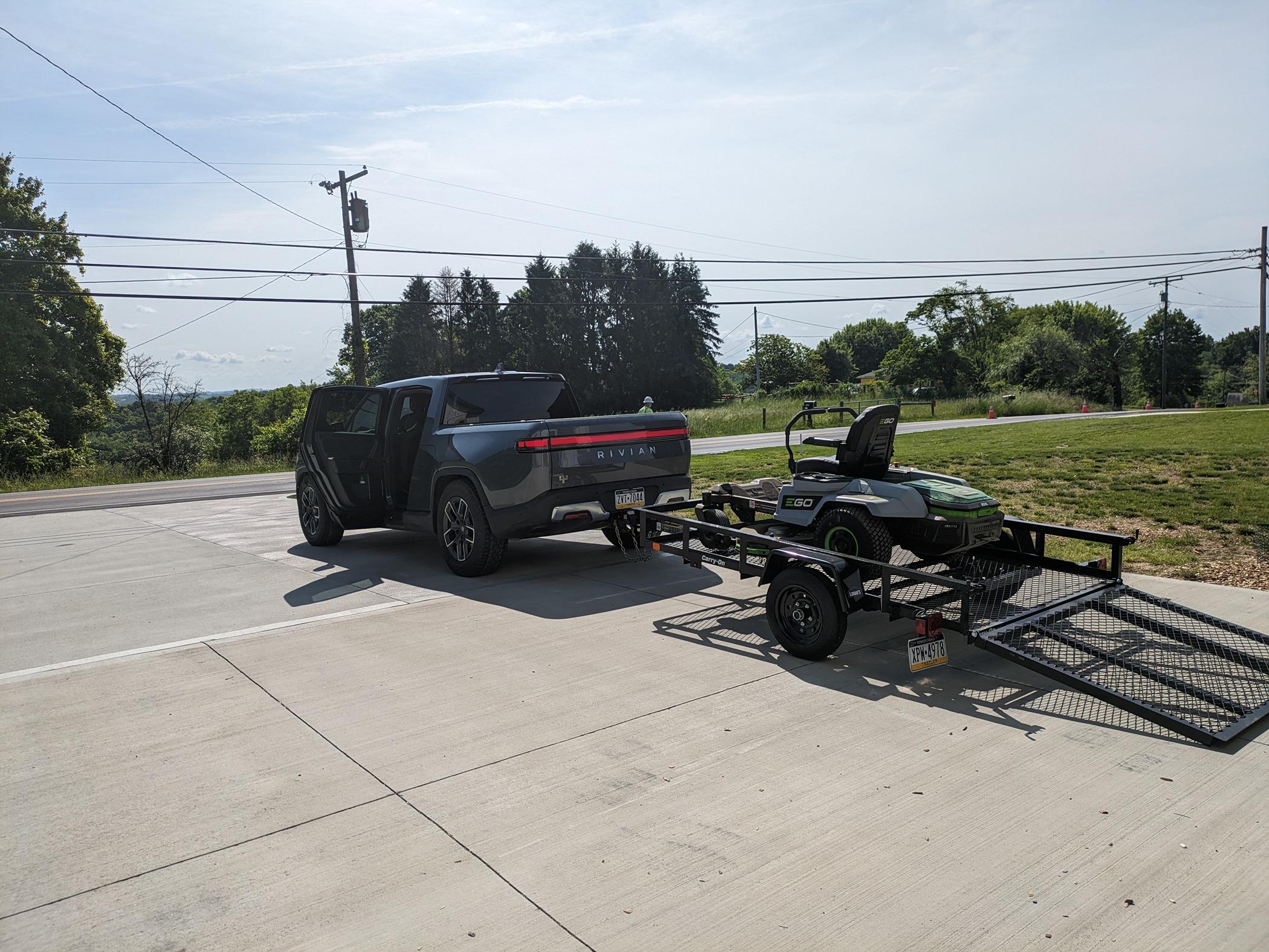

When a belt broke on my riding mower at my camp, I had already decided that I wasn't putting another dime into it, even though it was an easy fix. And I was getting even more agitated pushing my 20 in Kobalt mower back and forth on my close to 1 acre at home for 3 hours twice a week. So I finally pulled the trigger and bought an Ego zero turn for both locations. I knew this also meant getting a trailer to haul it the ~185-200 miles back and forth a couple of trips a month. I had the extra charging stops mapped out along a couple of route options. But boy was I pleasantly surprised at the efficiency on the maiden voyage. I did charge on the way and didn't pay close attention to the exact number, but could have made the trip up without charging and made it somewhere in the mid to high 20% range. Coming back was even better. Starting with 100% I made the 185 mile trip home without a stop and still had 32%. I had suspected I could probably make it without stopping, but never expected to see over 2 mi/kWh. It's about 60/40 highway to single lane roads, but other than about a 25 mile stretch of 65 mph the highways are all 55 mph.

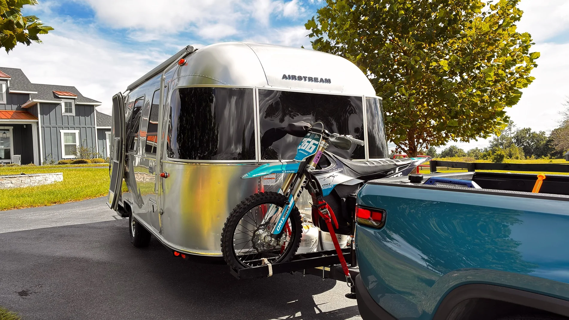

Thought I would give an update after 2 full seasons of towing this back and forth. I think I just passed around 6k total miles of towing. The long term towing average now sits at 1.94 mi/kWh. Late last summer, I replaced my original 20" Pirelli OEM AT tires after around 34k miles. They were probably ready to replace 2-3k miles before that. I had previously bought a set of very lightly used replacements that only had ~700 miles and 1/32 of wear, so close to new. There was an immediate drop with the newer tires and those first several trips I was probably only getting between 1.7-1.85 mi/kWh, but there has been a definite trend up again. I now have ~53k total miles so about 20k on these tires. Recently I have been coming close to 2.00 mi/kWh on the return trips again. It's around an 800 ft elevation change between locations. Based on the last tire rotation tread check, I'm pretty sure I am going to have to replace them again at the next rotation that is due at 57.5k miles. I'm plenty happy with the efficiency of the Pirelli's both with and without towing, but honestly the road noise right now is starting to get to me.

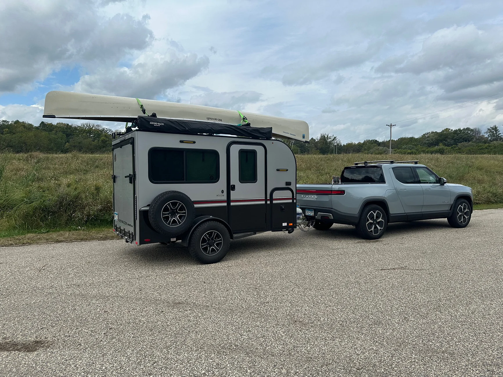

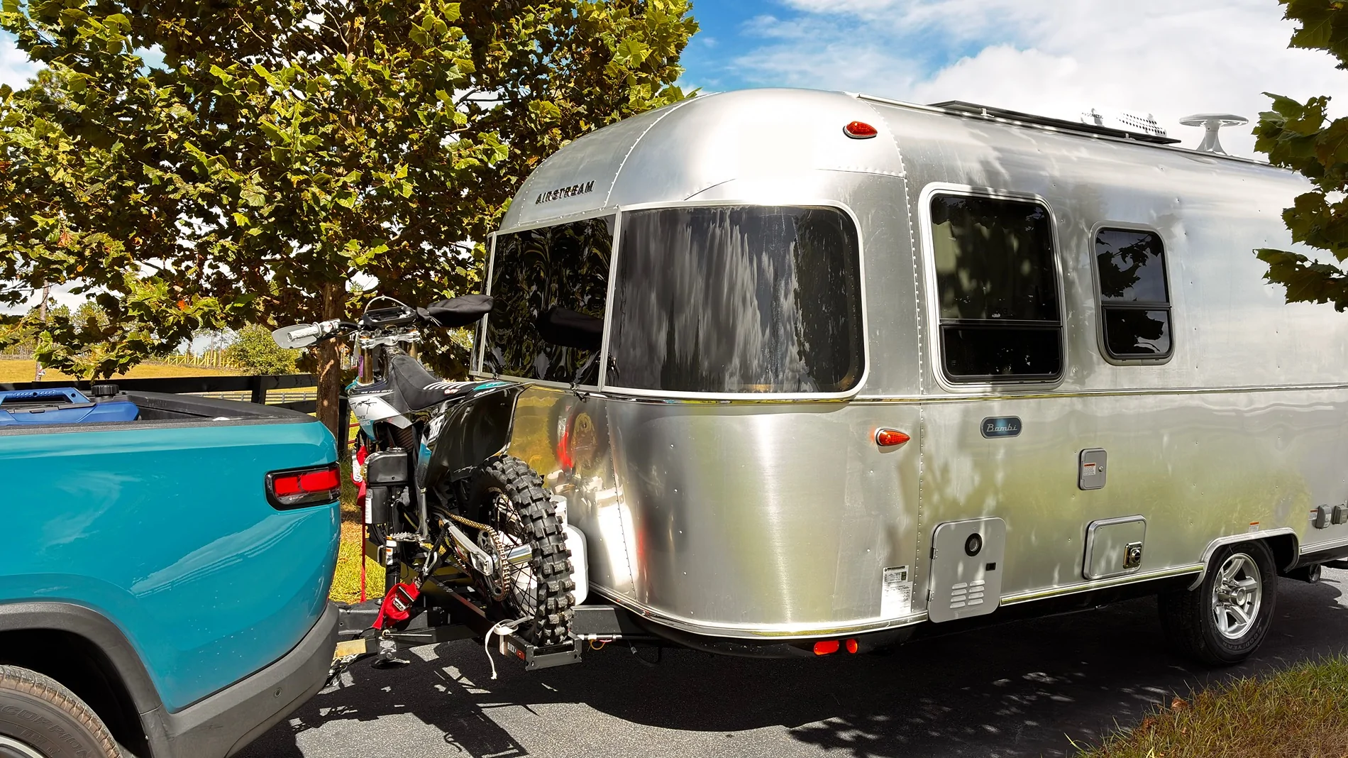

We took a trip from Maple Grove, MN down to Wyalusing State Park, which is just south of Prairie du Chien in Wisconsin. We were pulling a 2021 InTech Flyer Explore with our 2023 Performance Dual Max battery. It's 234 miles each way, with a top speed limit of 65 mph. I decided to go 60 mph on the way down, which turned out to be a good idea since we were bucking a steady headwind of 20-25 mph, and from Rochester MN to Prairie du Chien it seems like it is slightly uphill until you reach the Mississippi River. We started with 100% charge, and stopped to charge up in Rochester at a Circle-K, which required us to drop our trailer. For whatever reason, my Circle-K app wasn't working and I ended up swiping a credit card. The bonus side was that I got charged $0.01 for 66 kwh of energy. The truck was showing efficiency of 1.21 mi/kwh, so we charged up enough for us to make it the rest of the way. This turned out to be a bit optimistic, as the wind picked up and our efficiency fell down to 1.01 mi/kwh. As my charge rate at arrival dropped off, I found a Blink charger in Decorah, IA and added 31 kwh. That was enough for us to get to our camp site and set up camp.
On the trip back, we started with 99% state of charge through a combination of a Tesla charging in downtown PdC, and campsite charging at 12 Amps. This time, we had the wind at our back and a downhill run. That helped us get 1.21 mi/kwh, which meant we could bypass Decorah and make it to Rochester, MN. I was going to stop at a Blink charger at a Ford dealership, but both chargers were blocked by a fellow getting his Mustang looked at by a dealership mechanic. So, we backtracked a couple miles to the same Circle-K we'd used on the way down, dropped the trailer, then added 86 kwh to the truck for a cost of $39.23 ($0.43/kWh plus tax). We ran into several rain squalls on the way home, and arrived with 20% remaining battery.
So, here's the summary:
Trip Down: 234 miles with efficiency of 1.09 overall. Energy added: 97 kWh. Cost: $17.50 ($17.49 at Blink & $0.01 at Circle-K)
Trip Back: 234 miles with efficiency of 1.15 overall. Energy added: 86 kWh. Cost: $39.23.
We did a bunch of driving around with just the truck, and would stop at the Tesla superchargers for 10 minutes to add a bit of power every time we went to town. All said and done, we spent $111.51 to go 604 miles. Gas would have cost me $127.50, so it was close cost-wise (the $0.01 Circle-K charge helped).
For future towing:
1. Assume 1.00 miles per kwh for planning charging.
2. I could have saved myself some hassle by going past Rochester to Stewartville MN, where there are some Electrify America 350 watter chargers. It would have cost more, but it would have been faster to charge and we wouldn't have had to drop the trailer.

That canoe probably adds as much drag as the entire rest of your trailer.
It probably also helped a bit when we had the tail wind on the way home.

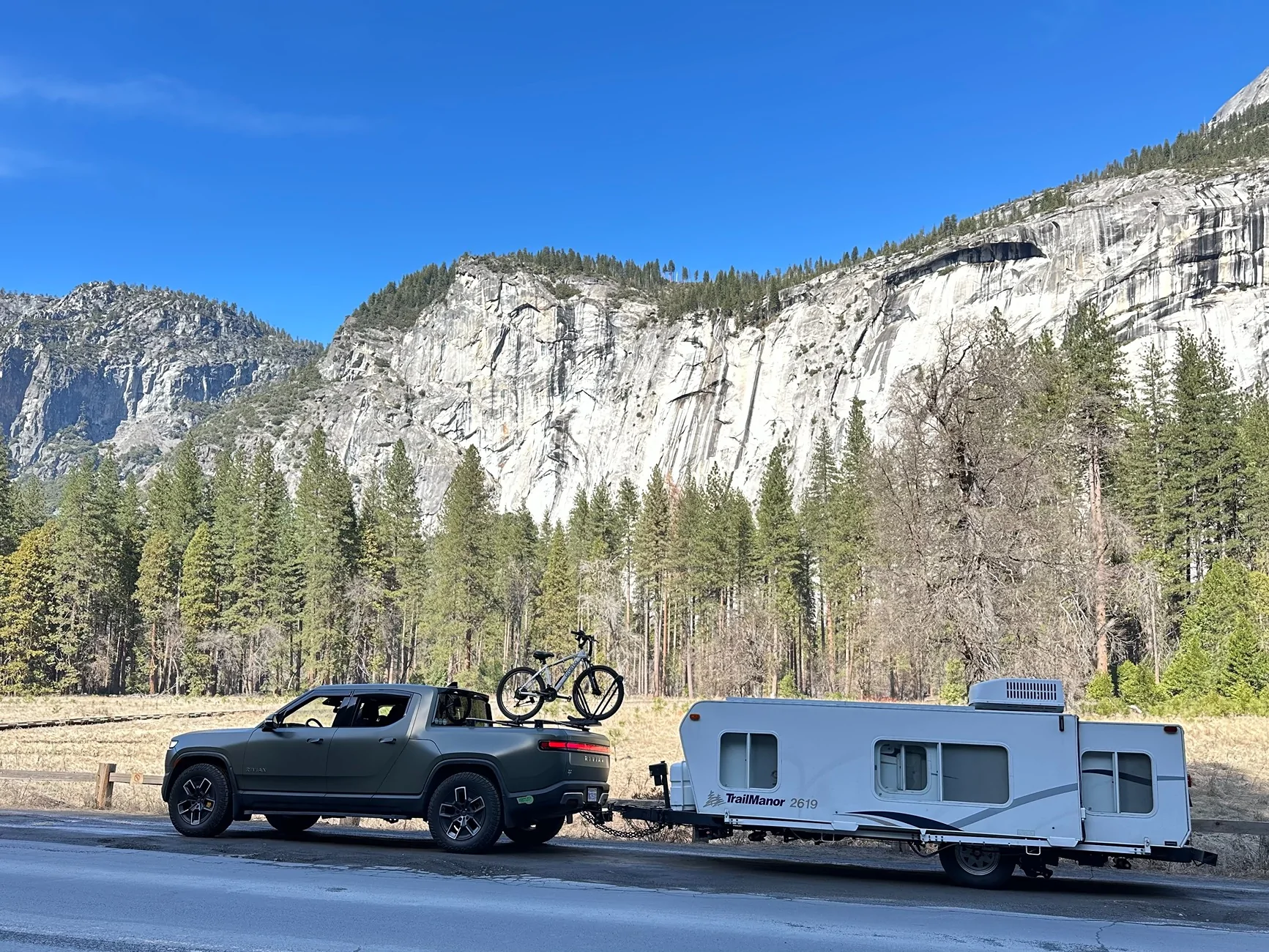

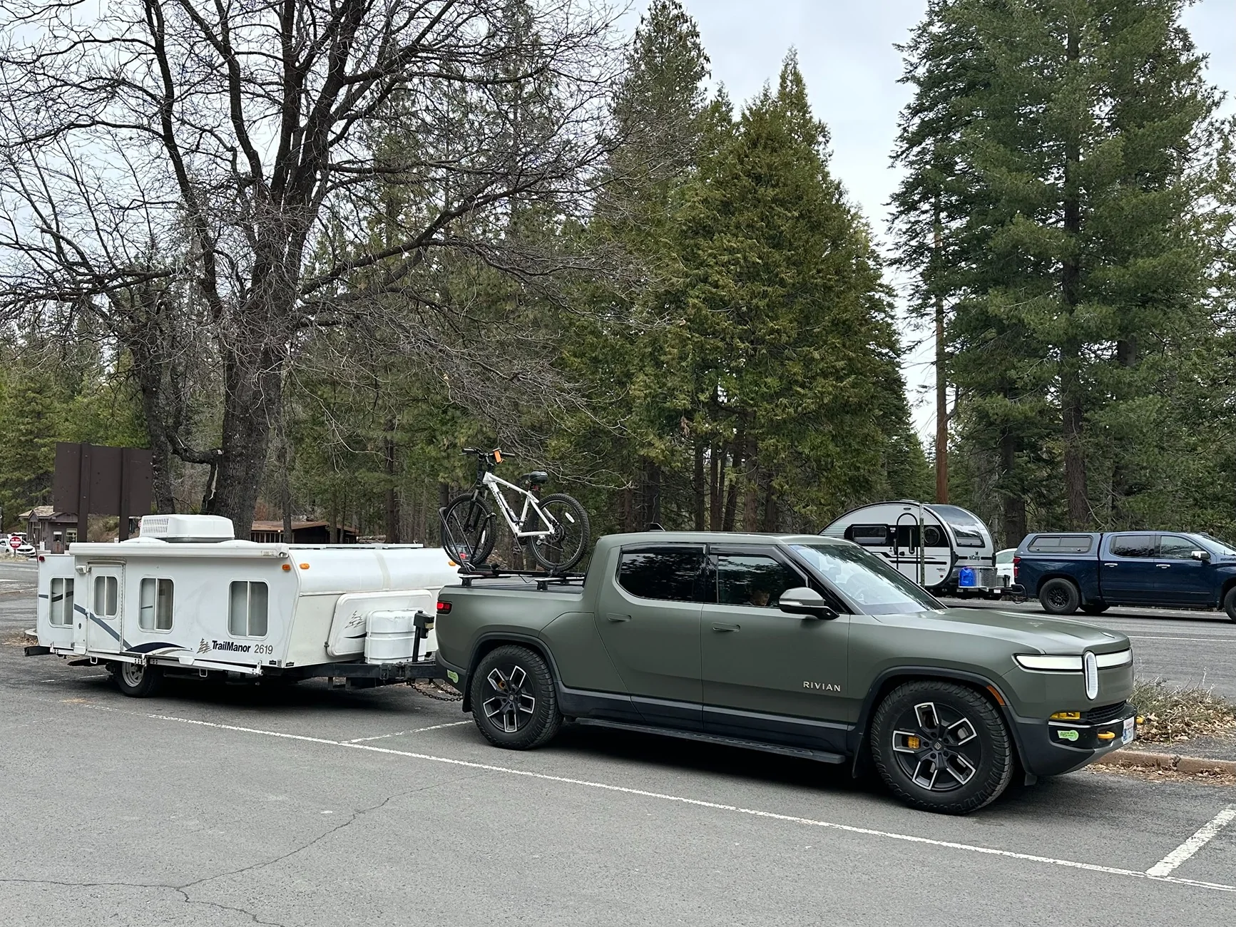

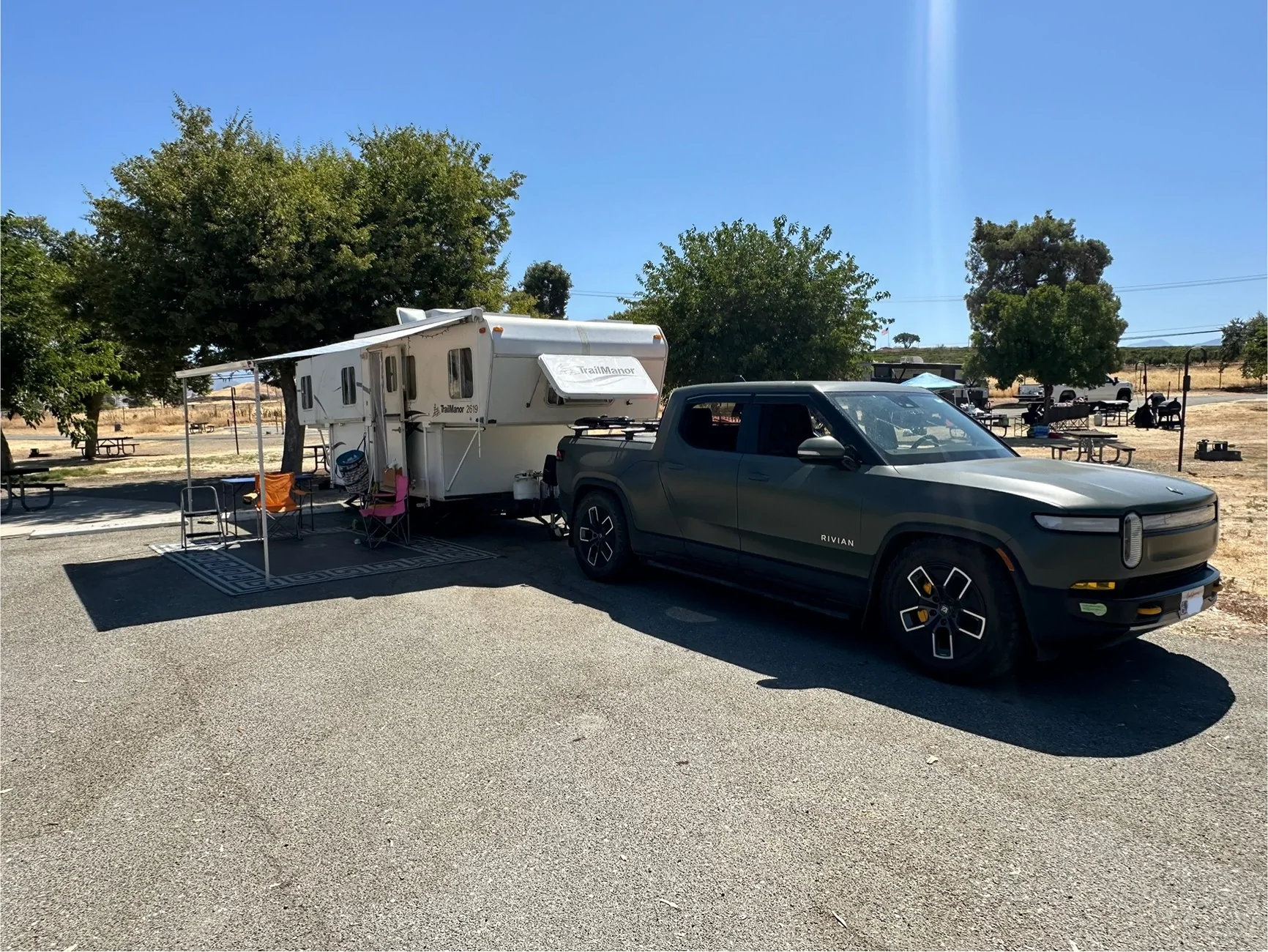

It’s been 1 year since we bought our TrailManor trailer and have traveled 5,000 miles with it on 10 trips. From the San Jose area, we have traveled to Ukiah, Hensley Lake, Pismo Beach, Pinnacles NP, Yosemite NP, Santa Barbara, Joshua Tree NP, Lake Oroville, Porterville (Sequoia & Kings Canyon NP), and Susanville (Lassen NP).
Manufacture specs say the TrailManor is under 2,700 Lbs. The truck sensors fluctuate between 4,500 to 5,000 Lbs. I have averaged 1.35 mi/kWh on my launch edition, large battery pack, with 20” AT tires.
The furthest I’ve driven between charges was 153 miles using 79% of the battery. Shortest trip was to Pinnacles NP, traveling 83 miles each way. Longest trip was to Joshua Tree NP, traveling 475 miles each way. The only place I had to drop the trailer to charge was at Groveland RAN, on the way to/from Yosemite. All the other RANs had a trailer stall and there was enough space to maneuver around at the Tesla SC’s and EVgo. Here is a chart of each trip:
TripMileskWhMi/kWh
Ukiah325.36223.081.46
Hensley Lake298.95229.031.31
Pismo Beach409.46297.621.38
Pinnacles NP165.53148.441.12
Yosemite NP357.01267.171.34
Santa Barbara697.78502.871.39
Joshua Tree NP951.37715.921.33
Lake Oroville405.93302.61.34
Porterville490.02352.861.39
Susanville712.32516.241.38

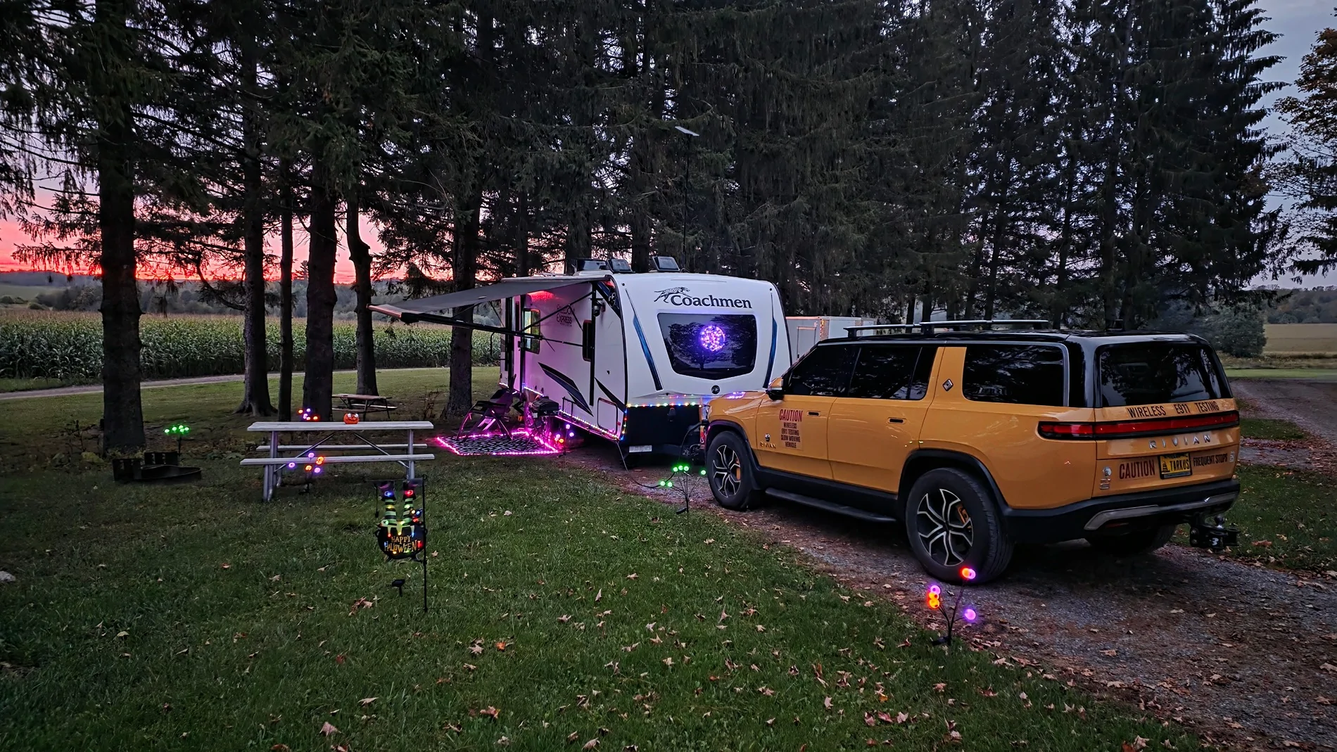

I've been towing my 2024 Coachman Ultralite 246RKS (7,000lbs) for over 6,000 miles during that past 12 months & I'm averaging around 0.88 to 0.93 on the interstates at 60-63 mph.

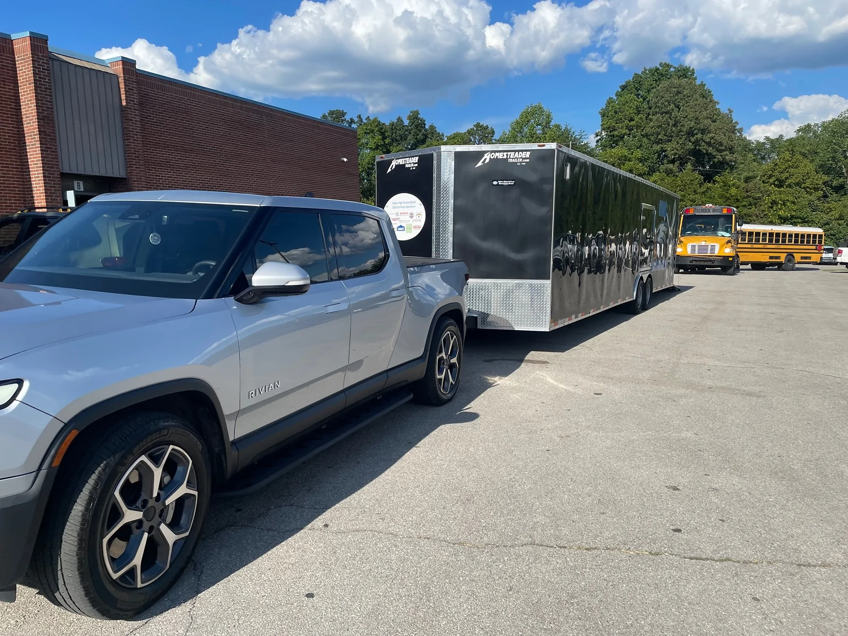

I can tell you speed absolutely is a major factor in towing efficiency. When towing a giant box (regardless of it being 1000 or 9000 lbs) if you are going faster, the added drag gets you.
My experience is under 45mph, I am well into 1.3 ish miles/kwh. By the time I’m over 65, .8 or .9 at best.

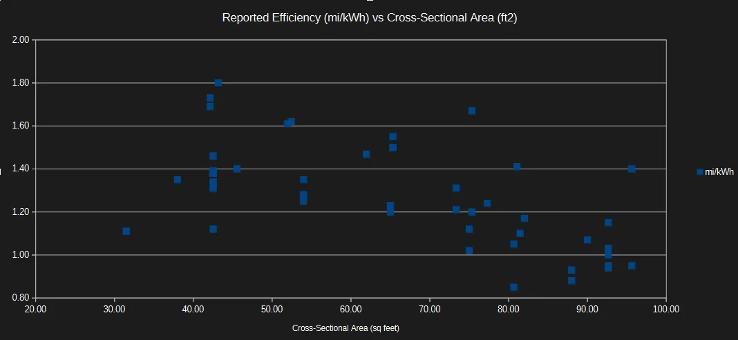

It may be hard to collect all of the data you are looking for... even with an Electrafi subscription, and it polling data every 8-9 seconds, I noticed it is missing some data like outside air temp but I suppose you could fill in weather data from the area to get that and barometer data.
It's pretty much impossible to do it with just the information typically posted on this forum, but we can at least get a plot of efficiency vs approximate cross-sectional area of trailer.
Rivian R1T R1S Towing + Efficiency: Please post your experience! 1760546876474-bl
There are some outliers here, like kevinhanff's report for a 6x12 U-haul enclosed trailer with only 1.11 mi/kWh. I show one of those as being 6' wide by 5.25' tall (data from U-Haul), so it's only 31.5 sq ft. It is a box, so Cd can be approximated like a cube (1.05), but still, there are other box-like trailers with much better results, such as DeanB1452's Trailmanor 2619, which gets numbers in the 1.35 range, and it's got about 42.5 sq ft in area. In both cases, the trailers are small and mostly hide behind the truck, although the Trailmanor is wider than an R1T.
I interpret the vertical scatter here as being related to speed foremost, and Cd secondarily, but we can see that the data could be fit with a straight line running from 1.6-ish at 42 sq ft down to 0.94-ish at about 93 sq ft.
