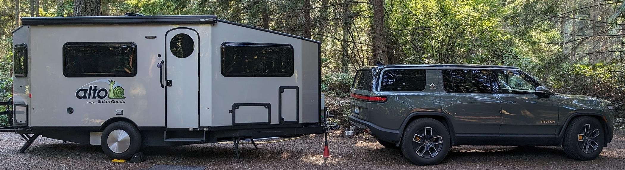

We have now taken 5 trips towing the Safari Condo A2124 totaling over 800 miles. Generally cruise is set at 60mph on freeways, though typically a lot of backroads are involved too. We don't take it when temperatures are near freezing, and so far I don't think they've topped 70 degrees when towing either.
We have a solid 1.5 mi/kWh average; the car claims a 194 mile range while towing.
It would probably get another .1-.2m/kwh if it had rounded edges.
I've seen reports of rounded edge flat front cargo trailers being more efficient than square edged V-nose cargo trailers.

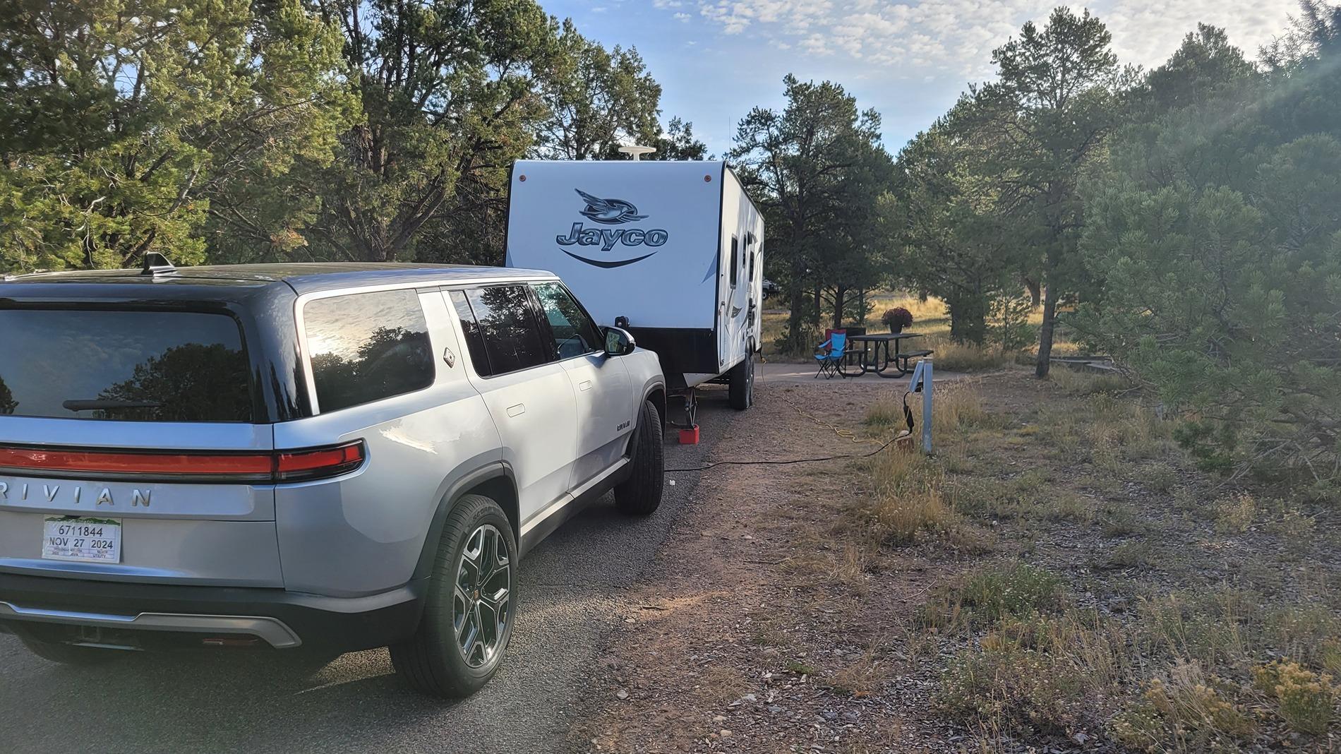

TLDR: With 21ft 2850lb popup camper, ABRP settings 1.8mi/kwh and 3500lbs 'extra weight', planning was accurate and reliable to use. Rivian estimated 216mi at 100% with 21" road wheels and 1.7mi/kwh after 350miles towing.
First real towing trip done and dusted with our R1S and Rockwood Popup. Here are some numbers to help others! I used ABRP and with reference consumption set at 1.8m/kwh and added 3500lbs to vehicle weight. With this setting, ABRP NAILED the range estimates along the way (like dead on % or within 1%). The Rivian estimate with trailer was quite accurate as well. Gave me 216mi at 100%.
Trailer weight dry is 2850lbs so I assumed about 3500 to be extra conservative.
Our route was about 2hours going south thru Denver to Colorado Springs, and then ~1hour west up into the mountains. I ABRP had us charging in south denver at 65%->85% but I decided to skip once I realized how accurate the estimate was as I drove past the charger right at 65%. In CO springs I tried to charge at a "180w" charger at a car dealer but was thwarted by one that was out of service and another only gave me 87kw. This was frustrating and my NACS adapter can't come soon enough.
I charged back up to 75% and we arrived at our campsite at 47% which again, ABRP estimated exactly, even with the elevation change. We left the campsite 2 days later at 43% and drove to south denver to charge. Again, ABRP had us within 1% arrival (10%). Quickly charged at a public spot at 140kw up to 33%. The estimate home seemed a bit aggressive so I added a few more minutes charging. I was right and we needed a bit more than the estimate from my phone (4% off), but when I rechecked ABRP's estimate on my computer once I got home, it was accurate. Not sure why the discrepancy there...
Anyway, I would easily trust ABRP now with these settings and towing with the R1S is a dream! Cheers

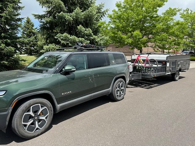

We got our R1S max pack 2 weeks ago and took our trailer camping last weekend so I got to experience how nice it is to tow with the Rivian. Our trailer is 7' wide, 22' long and around 5000lbs. It was about 90 miles each way and 2500' of elevation gain on the way there. I went mostly 60 on the way there and got 1mpk, and 70 on the way home and got 1.2mpk because of the elevation loss. I was able to gain enough charge from the tt30 plug at our site using an adapter to make it home without stopping to charge which was great.

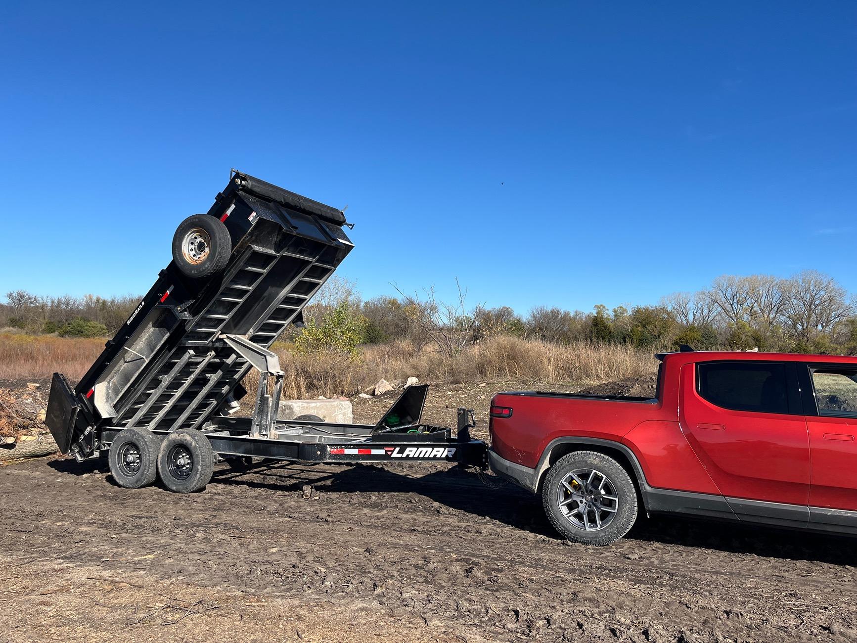

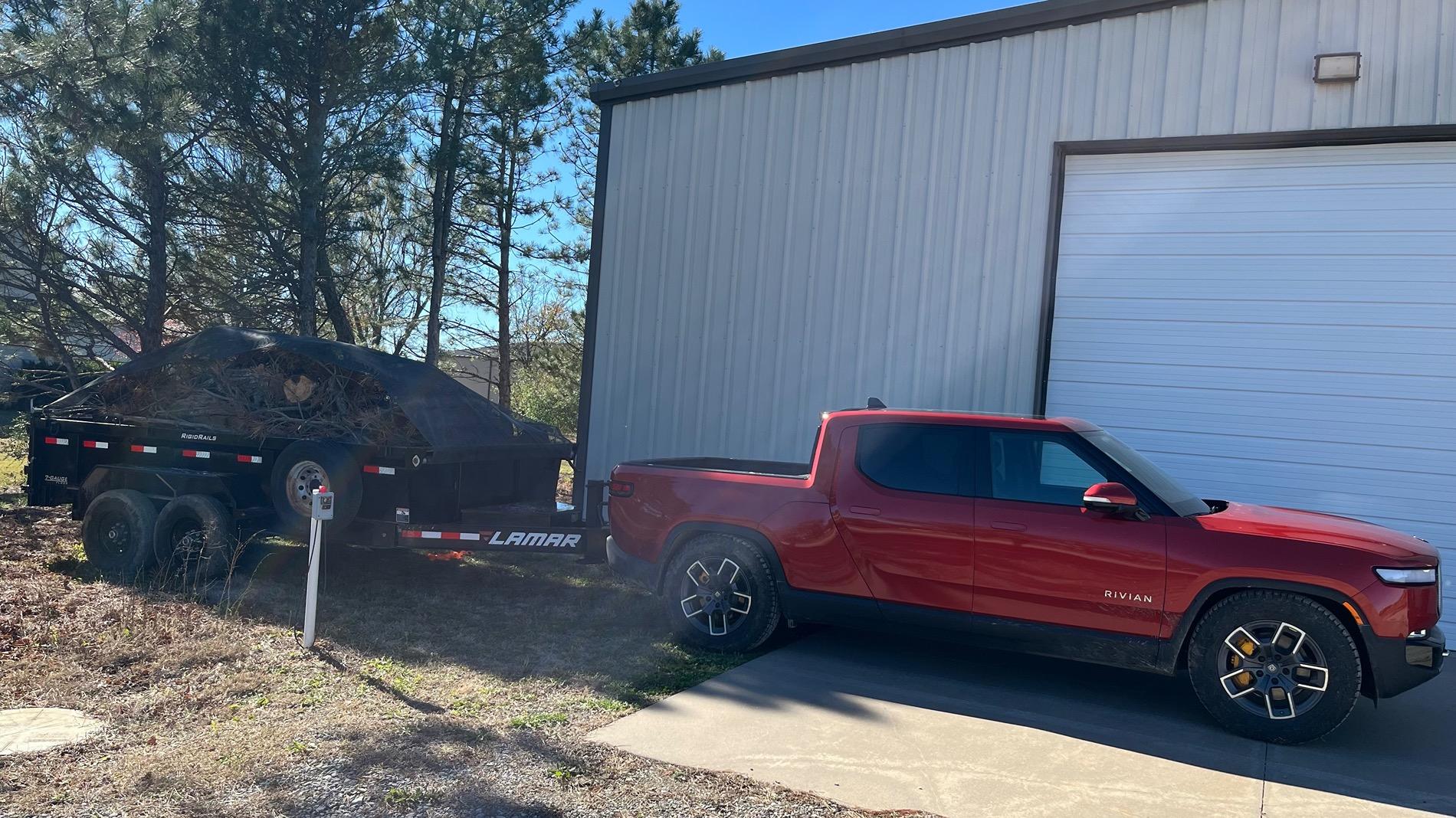

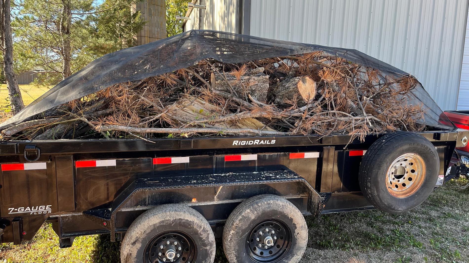

First off, it's great having friends and neighbors that share and help you out.
I had a 45' willow tree get snapped off in some high wind about two weeks ago. Luckily, it just fell into an apple tree instead of on the garage or onto the power lines that feed the neighborhood. Nextdoor neighbor just had back surgery, so couldn't help with the cleanup, but directed me to another neighbor that had a tandem axle dump trailer. I had never met the neighbor, but he happily let me borrow the trailer once the weather was good for that. Called a friend to help cut the tree up on Sunday morning. Used the EGO chainsaw and made relatively quick work of the willow tree making my friend reconsider the need to mix oil/gas for chainsaws. Since I had the dump trailer already and it was only filled to the rails, we also took out a 25' pine tree that was dying from a beetle infestation.
Took everything to the local landfill today and got asked by the folks in weigh station there all the normal questions about the Rivian: "who makes it?" "how far does it go?" "how long to charge it?" etc...
Landfill Arrival weight: 14,060 pounds
Departure weight: 12,000 pounds
Empty trailer weight: approximately 4,500 pounds
Rivian estimate of loaded trailer weight: 6,500 pounds
Efficiency towing the trailer for the 30 miles to/from the landfill was 1.30 mi/kWh. With my AT tires, I normally get something like 1.95 mi/kWh. Route to the landfill was at 30-40 mph on the side roads and returned home on the highway at 65 mph.
As others have said, couldn't even really tell that the trailer was back there other than the lower efficiency.
