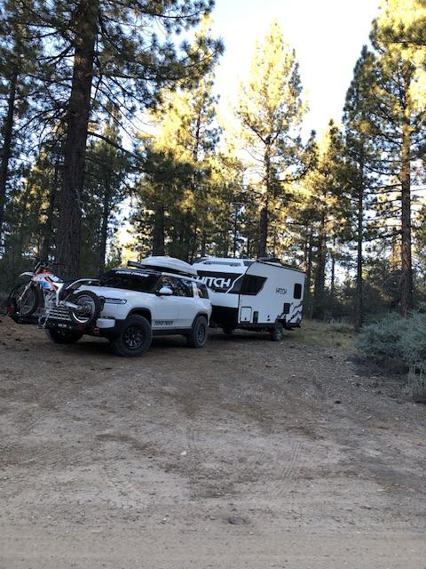

We built a front receiver for the vehicle in order to best utilize the SUV for our (needs) / adventures.
Have considered selling them, but decided that I’m not willing to take on the liability. Despite beating the snot out of it off-roading with the camper.

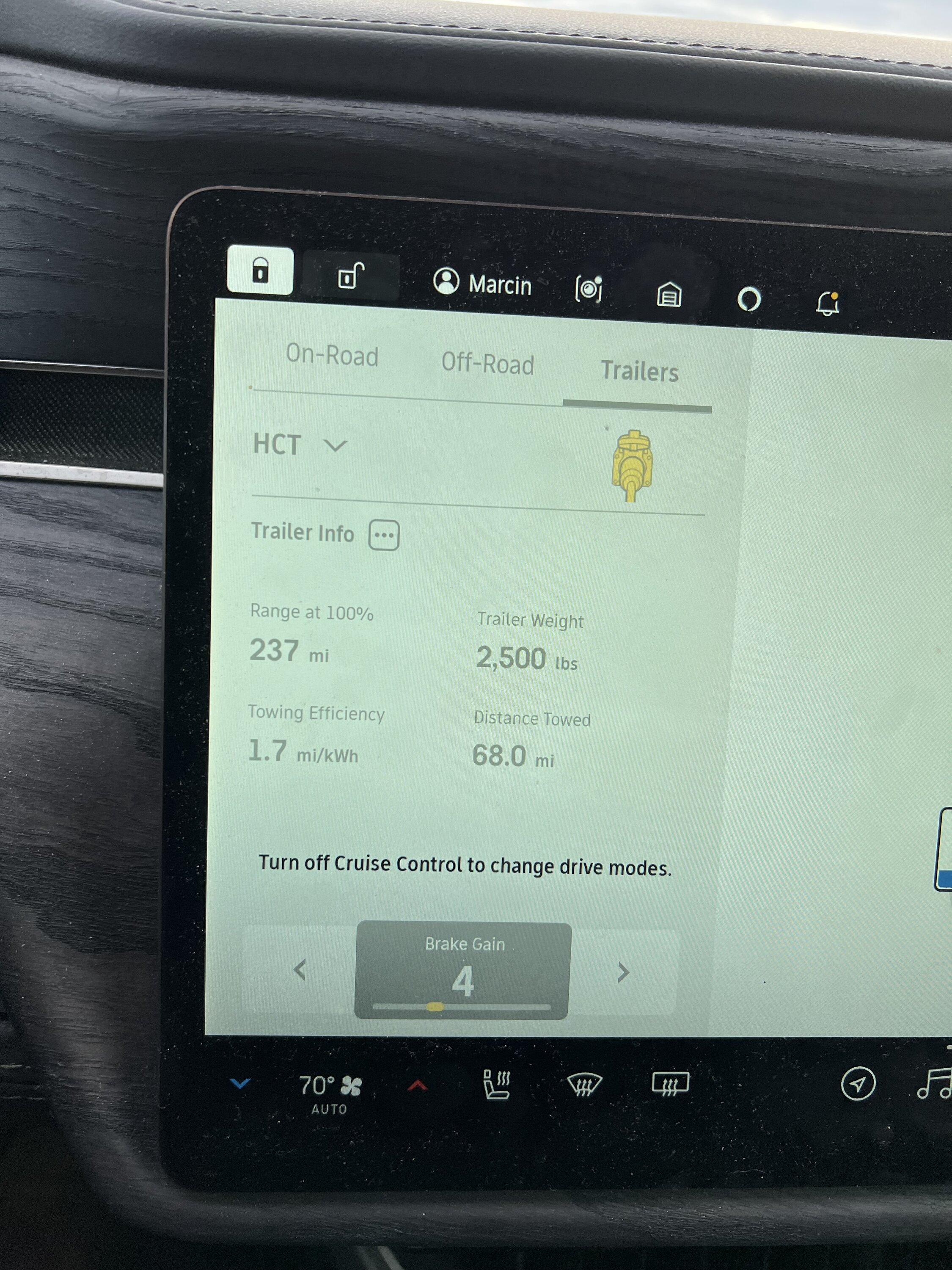

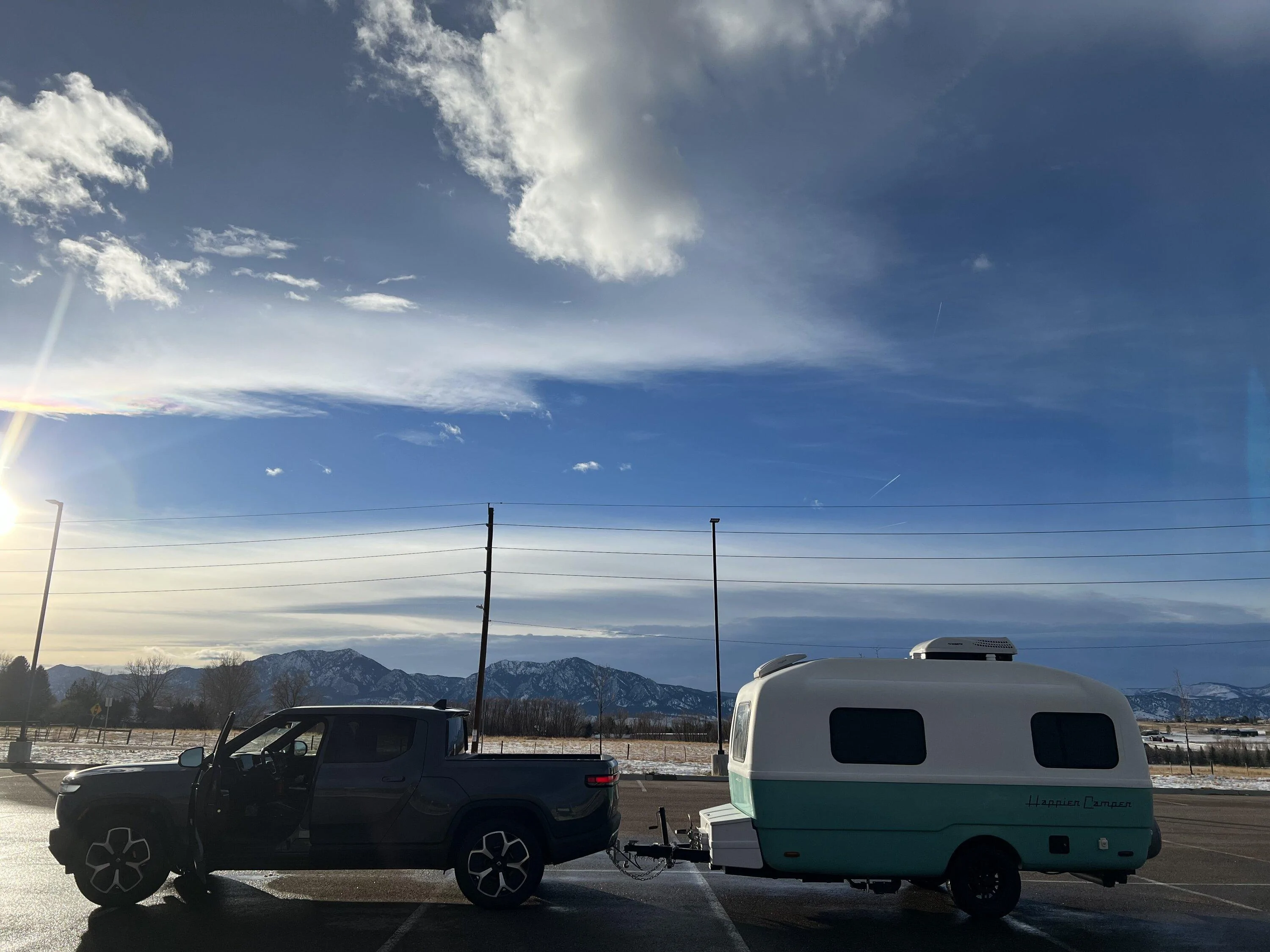

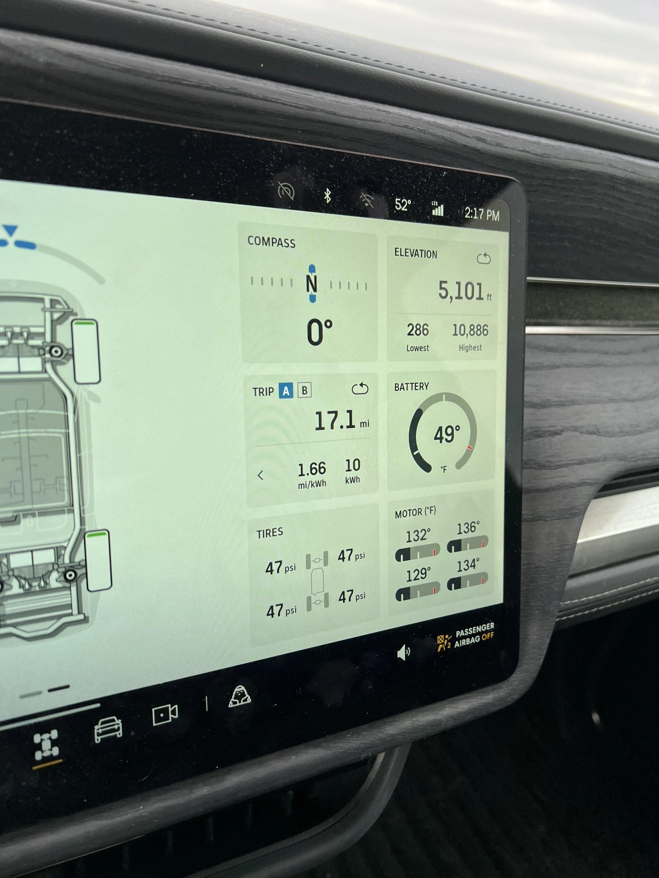

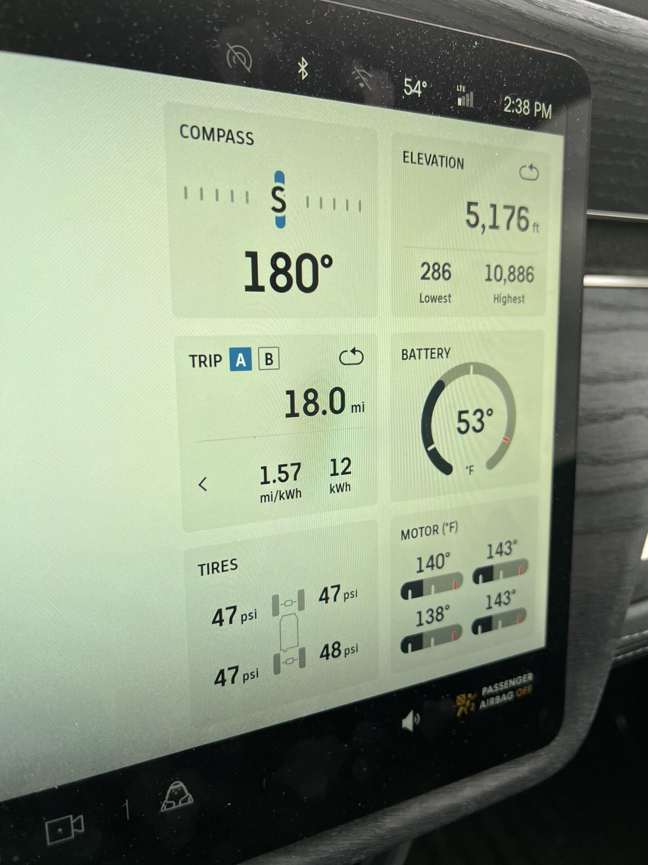

Went out for a first efficiency test with our new (to us) Happier Camper Traveler (HCT). I am not sure whether I did something wrong in this test or if this is just a lucky combination of ideal conditions and trailer-vehicle setup. Either way I was pleasantly surprised. Here is the data.
  • R1T quad large pack with 21” wheels
  • Temperatures in the low to mid 50F
  • Mostly flat to slightly rolling hill interstate averaging 65-66mph using cruise control. Out and back loop
  • HCT is a 14’ shell that is about 8’ tall (8’ 9” with the AC). The width at the widest point is almost exactly the width of the truck which probably helps with efficiency but also lets me see all the way down the side of the rig with the R1T side mirrors.
  • 1.61 mi/kWh average
  • Overall average in the trailer display was 1.7 mi/kWh but that included county roads and town driving at 30-55mph

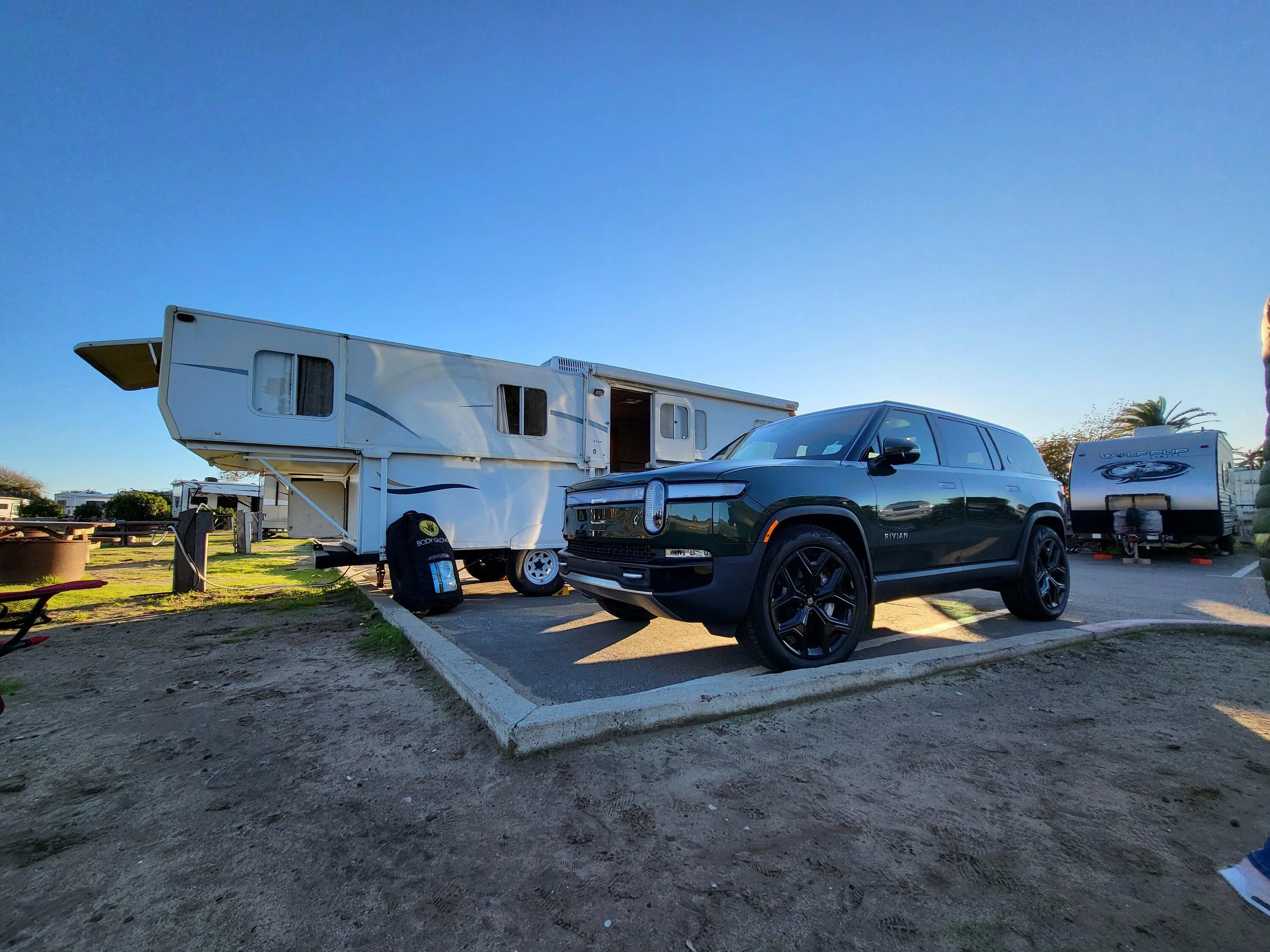

Hmmm. I thought I posted in this thread, but I guess not.
As per my thread, 3500ish pound 18’ tallish teardrop trailer averaged about 1.2 mi/kWh over 4500 miles of mostly interstate 60+ MPH driving.
Marchin_MTB
Marcin
Jun 25, 2022
1,513
1,989
2015 i3, 2011 Honda CRV.
I remember that post and it was helpful! Based on this, some other information here and videos on the intertubes, I was expecting somewhere between 1.0-1.3 mi/kWh for my setup so I was surprised to see significantly higher numbers. One might speculate that the teardrop shape is not as helpful to the trailer Cd as we thought. But I also notice that the Tab400 is a foot wider than the HCT. Also while on paper the height of the two trailers is within an inch, in actuality the height without the AC is almost a foot lower for the HCT than the tab, I think. And the sides are scalloped out to lower the effective height even more in some places. For now I am attributing the results to lower cross sectional area.
Is the 18’ length on your tab with the tounge or just the shell of the camper?

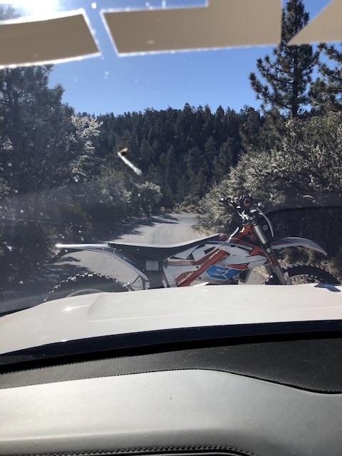

Towed the new (to me) toy hauler this past weekend.
70 miles each way, 19' Forrest River Work and Play toy hauler, 3 full size motorcycles inside, full 60g water tank. 1.2mi/kWh on the way there, 1.1kWh on the way back. Used 52% on the way down, 57% on the way back (took more highway, but kept it at 55-60).
Calculated weight by the Rivian was 9klbs loaded.

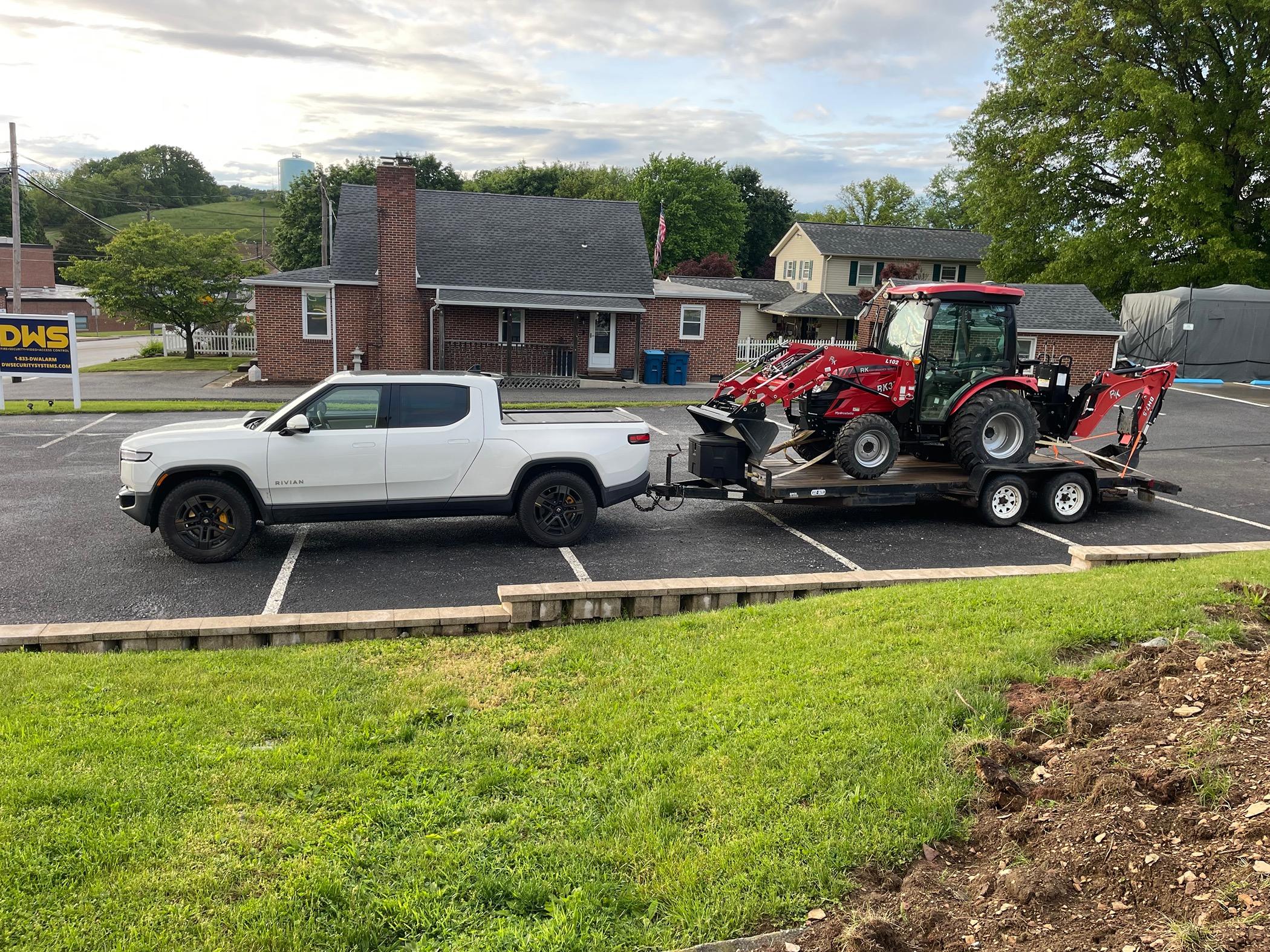

Rivian R1T R1S Towing + Efficiency: Please post your experience! IMG_7871
1.16 mi/kW. I’m guessing 6500 pounds. Truck did as good as my 1 ton.
