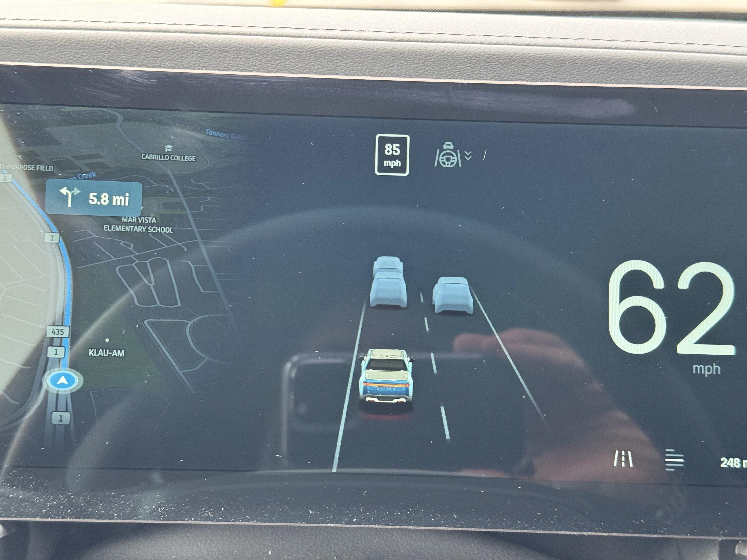

Strange, I’ve never seen an 85 mph limit in CA.
Are you saying you cannot adjust the set speed for driver+ or ACC once it is engaged? I can adjust it to my desired speed once engaged in my R1S and it honors that speed.
If the speed limit is “65”, and you are driving at 55, if you engage the highway assist, it will set you up at 65 automatic. But then I forgot to try to go lower because I was just surprised why I went faster than I intended.
Now that you mention it, I will try that and see and I think I can but initially on any given day, the highway assist will take you up to the speed limit (whatever is posted on the highway) even if you’re driving slower than the speed limit. (Initially)

was going at 70mph and stayed at the right lane because other cars are going faster than me (This will be another topic one day). Then I hit cruise control to stay at 70 but was surprised I accelerated and glanced on my screen what was happening and it says “85”. Really? I immediately canceled it because I wasn’t sure if it is really 85. I wanted to stay at 70 but after the recent update or maybe the 2 previous update, it will automatically keep you at the maximum speed limit so I can’t cruise if I wanted to stay below.
There are two settings for the cruise control. From the Owner's Guide:
Go to Settings > Vehicle > Driver+ to toggle on or off the speed limit setting when Adaptive Cruise Control and Highway Assist are engaged. This feature works on divided highways where there is traffic going in different directions, separated by a barrier.​
  • On: Engages Adaptive Cruise Control or Highway Assist at the posted speed limit. This applies when the speed limit is higher than the current vehicle speed.
  • Off: Engages Adaptive Cruise Control or Highway Assist with the current vehicle speed as the set speed.
It sounds like you're using "on". I don't use "on" because it has unintended side-effects like this. If you switch to "off" I think it will behave the way you want it to.

Thanks ?? @VSG I did notice that my setting is “on”. That explains.

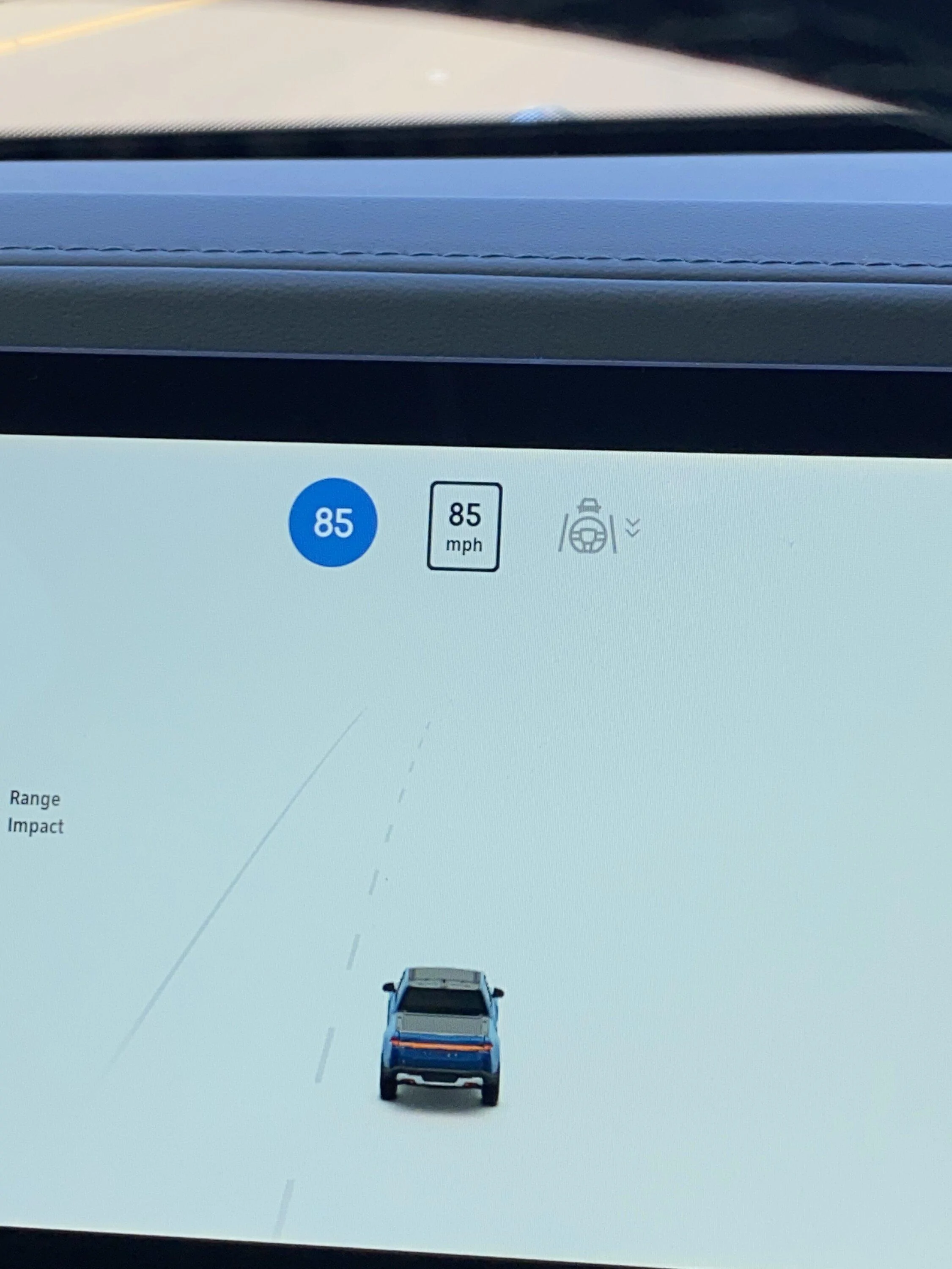

I've also seen this 85mph bug but have never reported it

This is why I don't think Rivian uses the camera/software to read speed limit signs. They might have used to but not anymore.
It used to read signs, then it stopped but as of the last 2 OTAs mine is back to reading them. It only overrides for a short distance then falls back to what it thinks the speed limit is.

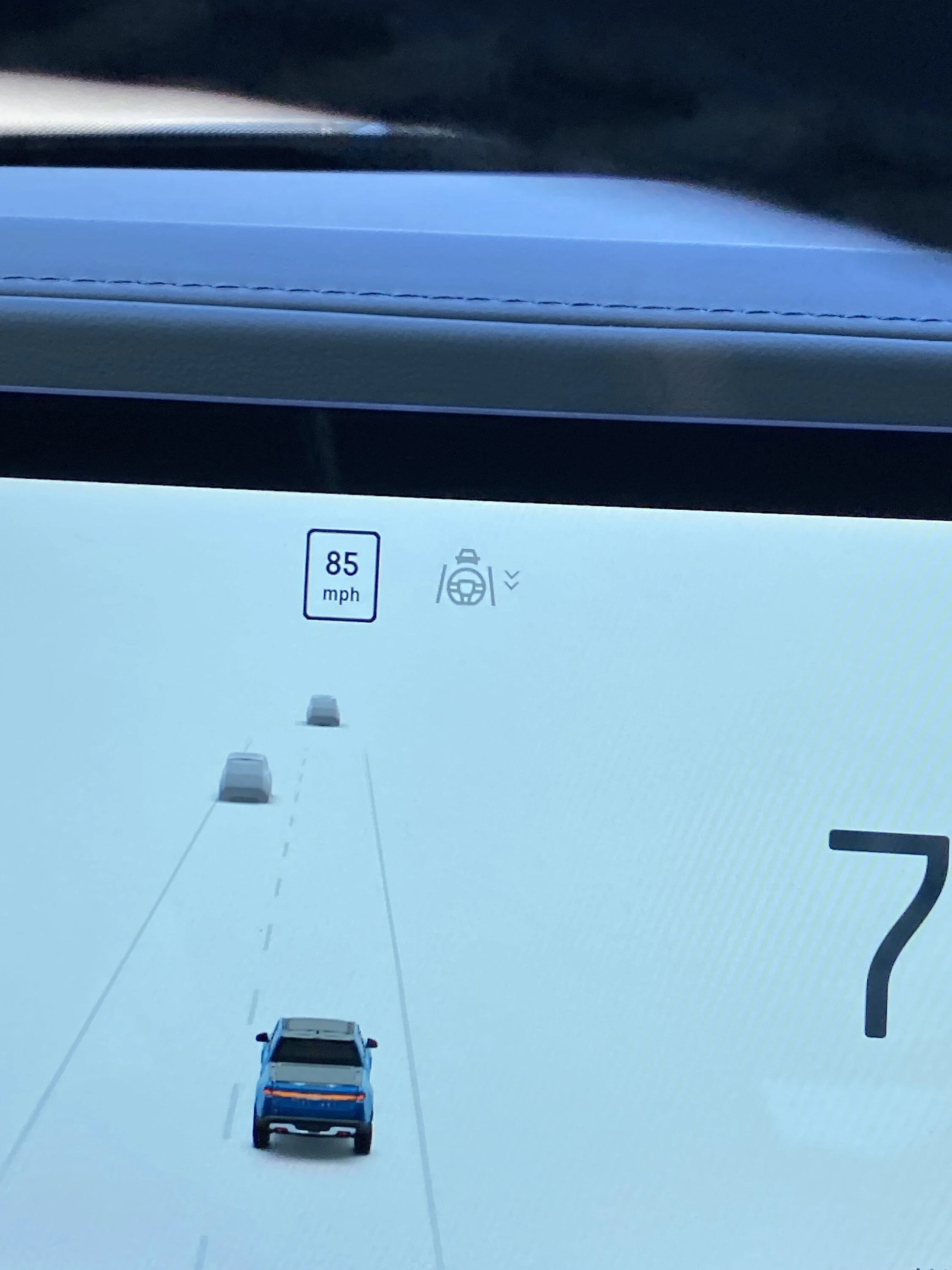

The 85mph change in Santa Cruz occurred right when I passed a 65mph sign, so there might be a connection to reading the sign incorrectly, but I'm not sure.

A lot of mapping data like this is taken directly from public information sources. Local governments know where their speed limit signs are located - they have GPS coordinates for all these signs in their GIS systems. The various mapping companies import all of that data.
So if the speed displayed in your Rivian changes as you pass a speed limit sign, that implies nothing about whether the Rivian is "reading" the signs. The fact that the Rivian gets it wrong sometimes is more likely due to bad data imported from the GIS (e.g. some systems might use a placeholder number when they don't know exactly what the sign says - 85 might be such a placeholder because it's easily recognizable as higher than any real sign would show.)
I find it unlikely that a character recognition software would fail on such an ideal use case - two numbers in high contrast with a known font are hard to get wrong because speed limit signs were designed to be highly visible and hard to confuse. Maybe 65 and 85 look similar in some fonts, but not in the font used on speed limit signs.

Driving back from Central coast (California) to the SF Bay Area, we were on Hwy 101 at San Luis Obispo and was going at 70mph and stayed at the right lane because other cars are going faster than me (This will be another topic one day). Then I hit cruise control to stay at 70 but was surprised I accelerated and glanced on my screen what was happening and it says “85”. Really? I immediately canceled it because I wasn’t sure if it is really 85. I wanted to stay at 70 but after the recent update or maybe the 2 previous update, it will automatically keep you at the maximum speed limit so I can’t cruise if I wanted to stay below.
This went on for miles and miles and then it dropped to 70 even though I saw a sign that says 65. After we passed the 65 speed limit sign, the dash will change to 65 but after a quarter mile or so, it will revert to 70 again.
I think it “normalized” to 65 after we hit King City and onward.
Can someone who live or frequently drive the Central Coast confirm the upgrade of the speed limit? I believed it was a glitch but it would a welcome changed for me if it is.
I had the same thing happen today driving up the 101 through SLO. Must be a glitch.
