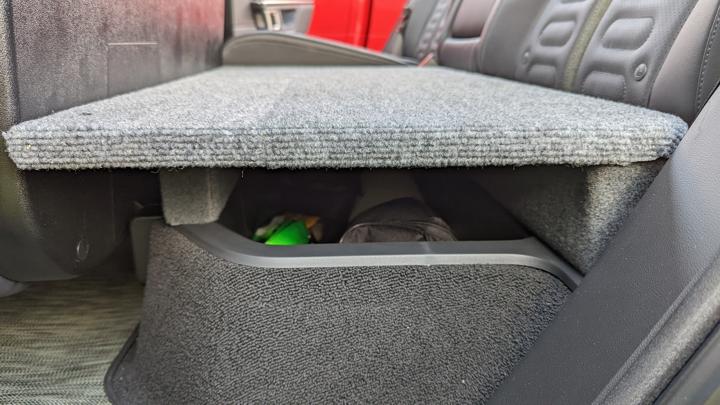

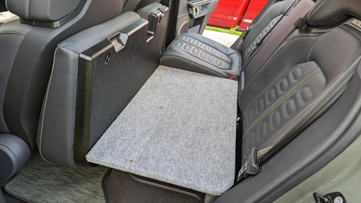

I have been using my ARB 63qt fridge in the bed of my R1T. It just clears the tonneau cover. There are times I like to have the fridge out of the bed though. I built a raised platform for the back seat. At 17" H x 17.7" W x 33.3" L the ARB fridge is pretty big. I raised the platform 3.5" to clear the seat belt buckles. Maintaining access to the storage under the seat was important. Raising the platform allows access to the storage.

Raised platform pics. I cut down a fridge mount I had in my LJ.
Rivian R1T R1S My fridge locations (ARB 63qt) -- R1T bed and back seat (using raised platform) Fridge platform 1 sm
Rivian R1T R1S My fridge locations (ARB 63qt) -- R1T bed and back seat (using raised platform) Fridge platform 2 sm

Does the rear seat bottom lock forward in that position, or are you just counting on the stand/fridge to hold it open, and hopefully not flop around too much when driving?

It looks pretty wedged into place. My seat stays forward except for under the hardest acceleration with nothing blocking it.

The fridge takes up all the space. It can't flop around.

The platform will be attached to the loops for the child car seats. The fridge will be strapped to the platform.

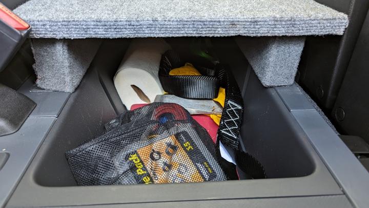

This is the storage area access from the passenger side after lifting rear seat.
Rivian R1T R1S My fridge locations (ARB 63qt) -- R1T bed and back seat (using raised platform) Fridge platform 3 sm

Without lifting, I can still pull out a coil hose with garden sprayer attached, for reference. That's with about a 24-25" platform base, which is an inch or so longer than the fridge. So you can still somewhat access flexible things on that end, but lifting required to access more/rigid stuff.
In this photo, it appears the driver’s side seat is actually blocking the passenger side seat from folding up. Is the passenger side seat removable or is this an optical illusion? Could both seats be folded up, potentially allowing for the fridge to be located on the passenger side? I realize there is a sub woofer there, but, hey, it is a sub woofer. I also realize it would likely require forfeiting any back seat, but it would open up that under seat storage area. Rather than folding, can those lower back seats be easily removed? On my FJ, the back seats can be quickly removed, with no tools required. If those lower seats are removable and a full length platform was installed, that could be great for anybody with a dog. Possibly hinge the platform in the middle to allow for full access to the storage area.

Both seats fold up. Look at two posts above yours. That is looking at it from the sub woofer side with both seats up. I may make another mount for my Goal Zero Yeti 1000 solar generator there. I won't raise that one though.
