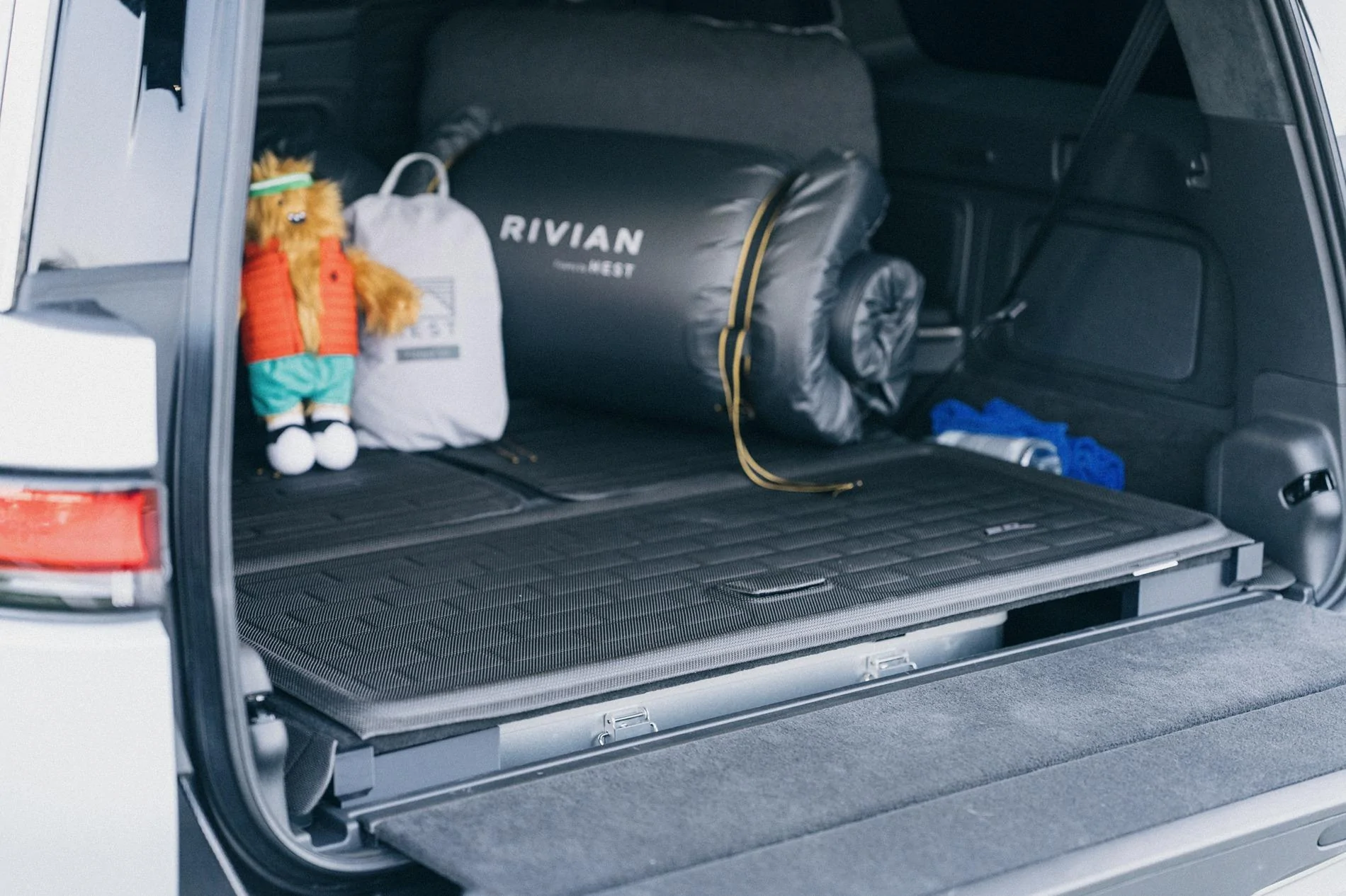

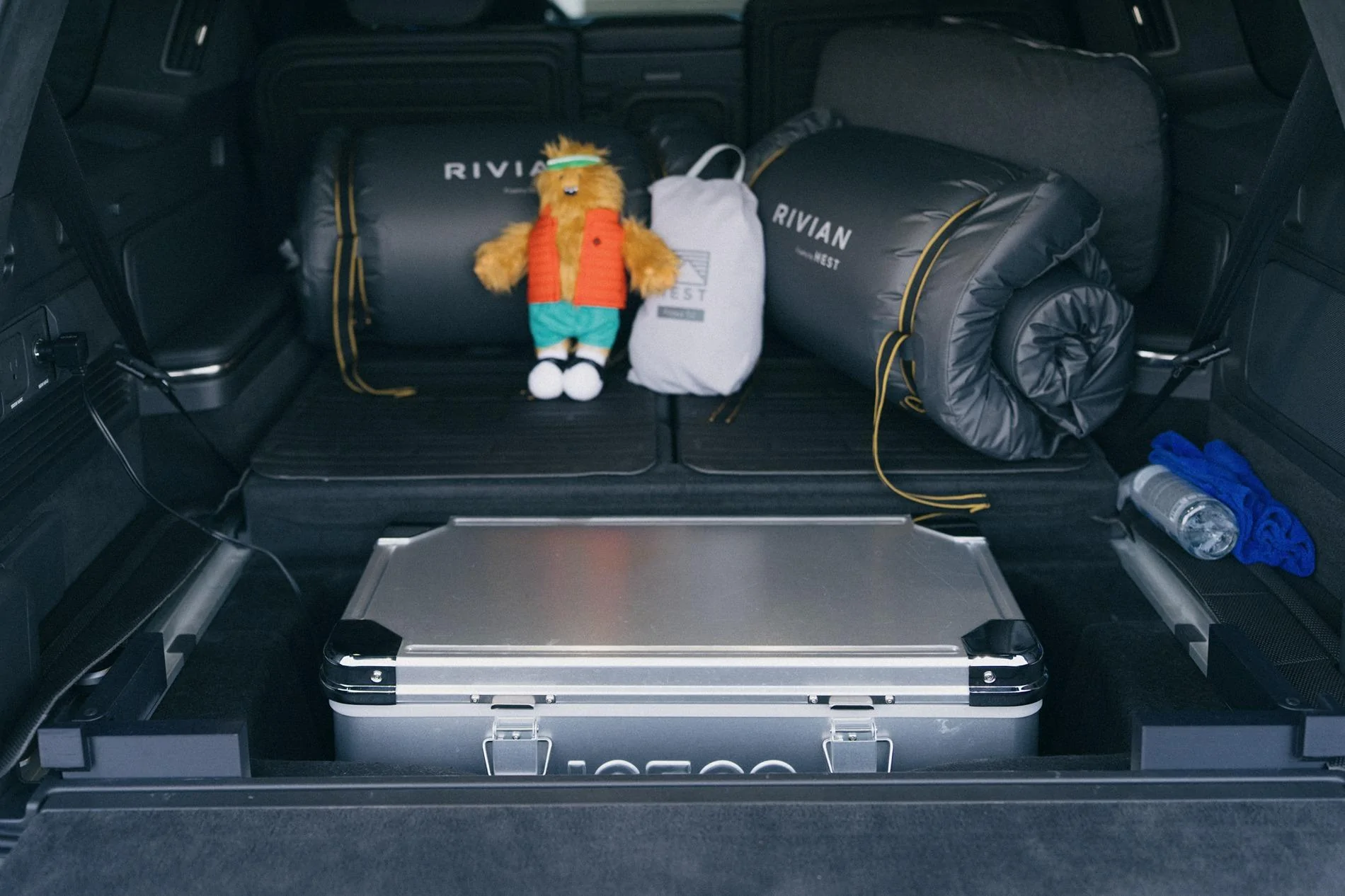

I personally think it's hands-down the best portable fridge setup for the Rivian R1S, perfect for anyone who camps inside the vehicle. For months, I had the fridge sitting in the trunk, which worked well. But I always thought—how great would it be if I could hide it away? So last week, I decided to try placing it in the subtrunk—and oh my gosh, it fits perfectly. I regret not doing it earlier. The subtrunk is honestly one of my favorite features of EVs

I read up on your setup yesterday and likely will be taking your fridge setup with the lifted cargo lid situation. Great space optimized setup, especially since I take a hitched full spare with me on trips.
Looking through Iceco fridges, that fridge does seem to be the best option for that sub cargo space, though I didn't methodically check every single option.

I got the fridge in!
So it fits for sure. It unfortunately doesn't sit in their centered and I didn't want to take off the felt covers (there's wires and such that is hidden behind it). The good thing about it not being centered is that it forces you to have a bit of space on the left that you could store some stuff and creates a tighter fit in the space.
- This doesn't seem to be an issue in the photos for the guide. Did you cut the bump in the floor so the fridge could be centered? @Mars Adventure Gear Or maybe your vehicle's felt panel cover doesn't bump up on the left side like mine does.
One actual bummer is that the lid doesn't fully open while in there. It opens a decent amount so you could probably take a few things out at a time if they're not massive. Or you'd just need to lift out the fridge temporarily onto the tailgate to take some stuff out.
But still overall I am excited to use this setup next week. Not having a fridge take up trunk space is amazing.

do you have a picture of how far the lid can open when the iceco apl35 is sitting in the R1S subtrunk?
So I took the plunge. For me, the fridge cannot open at all once it is in the subtrunk. Needs to sit a bit higher for the hinge to have clearance, but then that means you can’t have it flush even with risers.
One thing I did wish the APL35 had is a removable divider to have the option of making it into one larger compartment. Other than that it is a very nice unit.
I just loaded my fridge (and replaced all of the college dorm crap on top of it) so it's ready for our drive home tomorrow. Bummer that you can't open it while it's in the subtrunk. What happens if you put risers under it and then don't use the subtrunk-cover? Just a thought.
