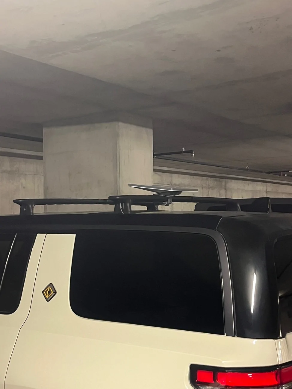

Just mounted my Starlink mini using their crossbar mount. Easy to install and seems solid.
Debating whether I should flip it so it’s angled the other way for wind dynamics or if it even matters.. Might be a project at my next charging stop.
Starlink newbie here...I just set it up and tested it in a local park yesterday before its "debut" tailgating at the Penn State game tomorrow. As I was setting it up the graphic clearly showed that the bottom edge of the dish (I have the Starlink Standard) should be facing north. I can't imagine that would matter, but wanted to ask.
Also - Do they sell a shorter cable to connect the dish to the router? I don't need 50' to go from my roof to the interior of the R1S.
waitingonanr1s
May 18, 2023
755
1,156
2025 Tri-Max R1S (CA Dune Edition), 2023 QM R1S (Traded in May 2025)
I've only used mine twice before I finally decided to take it out of my frunk and mount it so it could be useful. I have used it at a couple of offgrid airbnb's and I haven't found it particularly fussy on direction. I think the most important thing is that it has a clear view of the sky. Likely will have problems if something large is between you and the satellite, but I've had no problems.
I'm amazed at how easy to use and efficeint the technology is. I left my garage in downtown San Diego after I took this photo and actually connected it for the first time in almost 2 months (last used in Canada). Even winding around through downtown SD (surrounded by high rise buildings) on the way to the freeway, it established connection in less than 5 minutes and welcomed me to the United States (lol).
I have noticed the signal will occasionally drop out, but it's usually very brief and doesn't happen enough to bother me (it was most noticeable on long zoom calls). That likely could be reduced if I took the time to align it properly, but I'm always on the move when I'm using it, and it doesn't bother me enough to care.
Not sure about a shorter cable. I always have something covering my floor because of dogs, so I just left the extra coiled under my floor covering. It ran really nicely in between the trim pieces and through the tailgate. I just need to strategically place a couple of strips of black ducktape to make it disappear on the crossbar.
