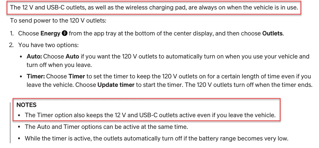

Thanks Kevin this is useful. I am acquainted with someone who worked on the camp mode software and said that there is so many permutations of 'camping' so yes the car can be configured with a lot of complexity depending on exactly how you use this vehicle.
Hopefully this will clarify your statement:
dubaigary
gary
Mar 3, 2026
southern california
R1S dual max pack 2026
Exactly. Except when the inverter failed, the timer would no longer work, even for 12v. It would allow you to set it, then would shut off a few seconds later when it found out the inverter didn’t respond.
