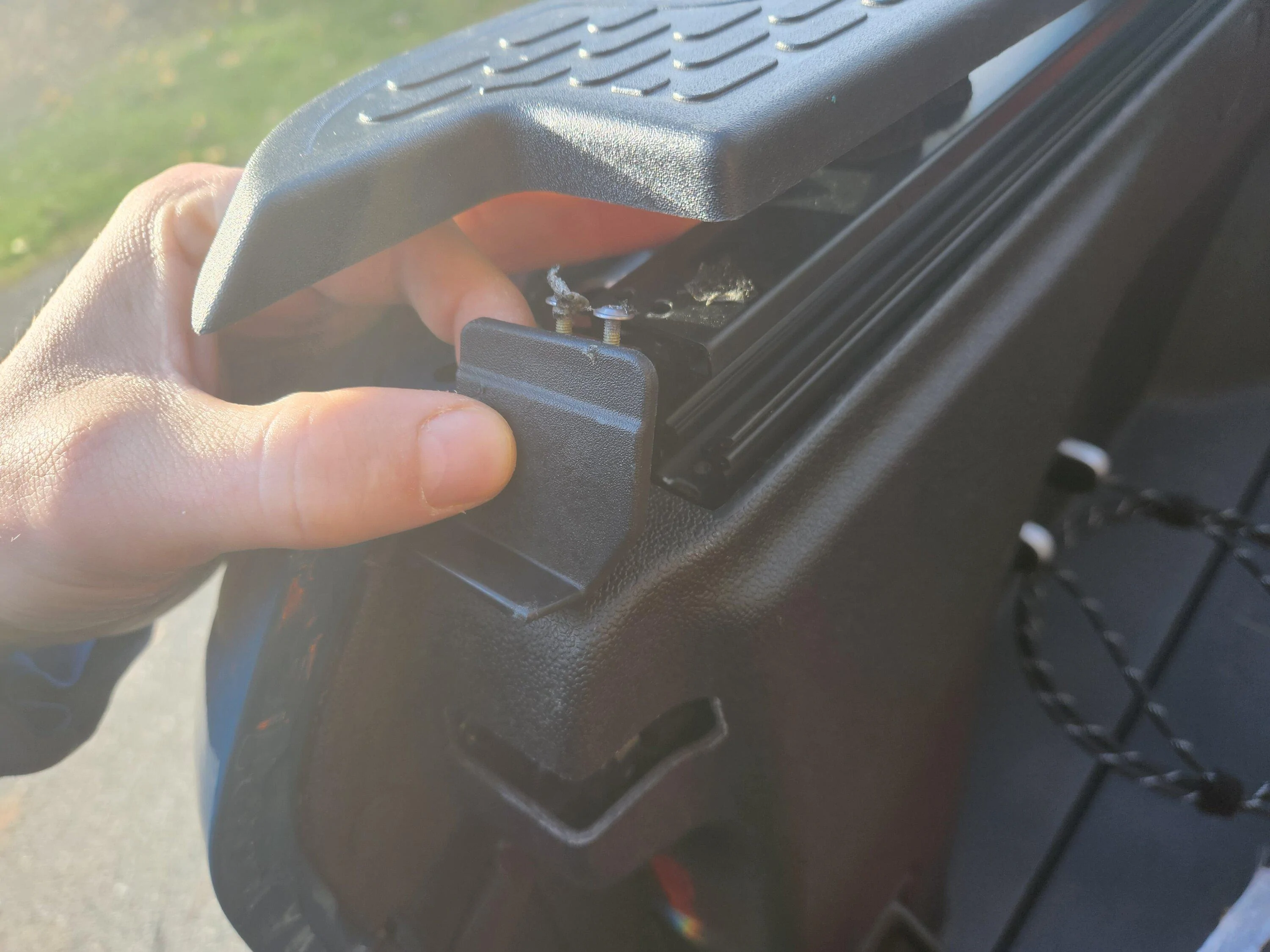

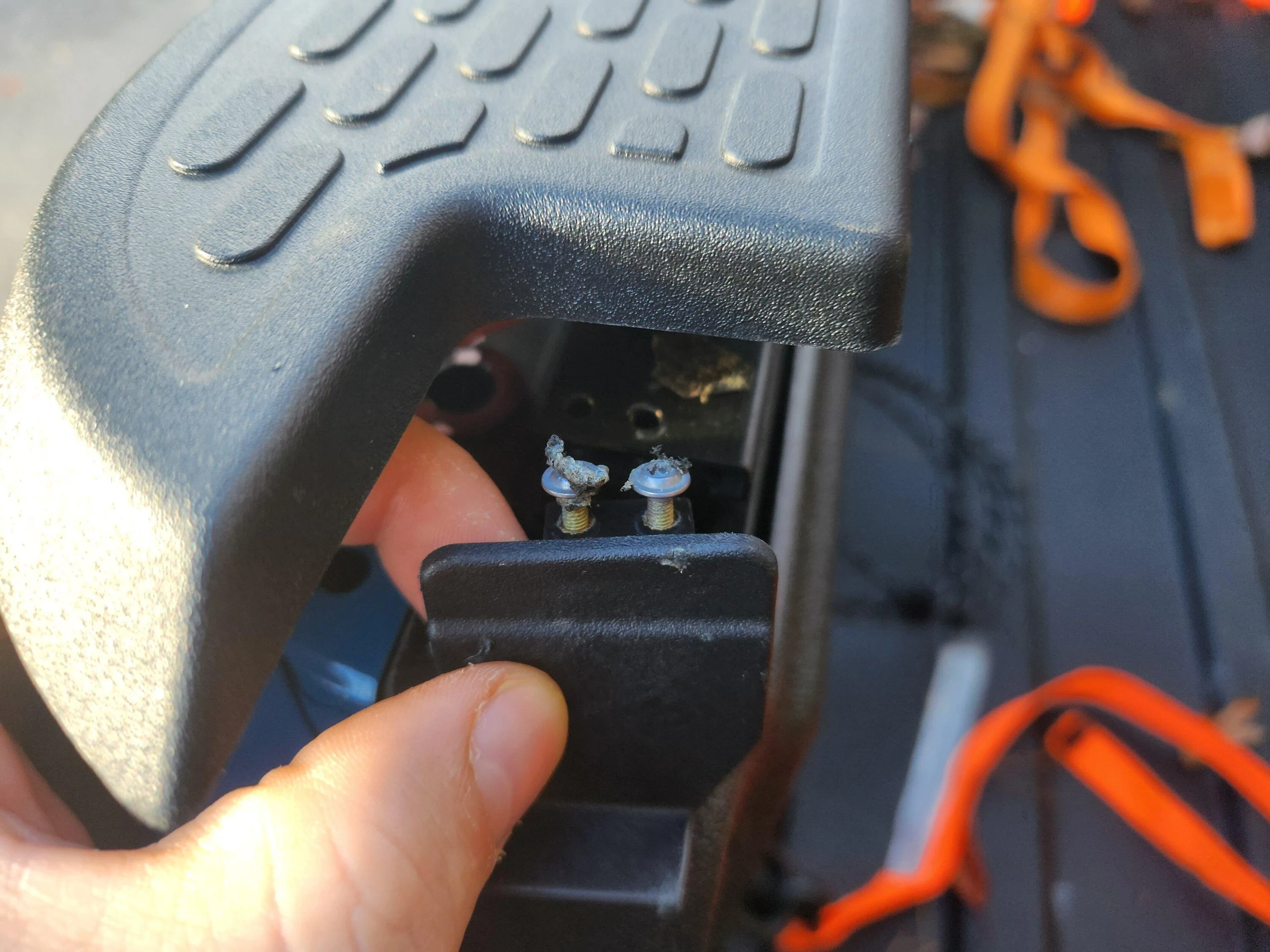

Once you have all slats out of the storage bay and resting in the rails, there are retainer caps on the rails toward the tailgate (mine are already removed but you get the idea):
Rivian R1T R1S Powered to Manual Tonneau Bed Cover Conversion -- DIY how-to with photos 20221028_091335
Rivian R1T R1S Powered to Manual Tonneau Bed Cover Conversion -- DIY how-to with photos 20221028_091339

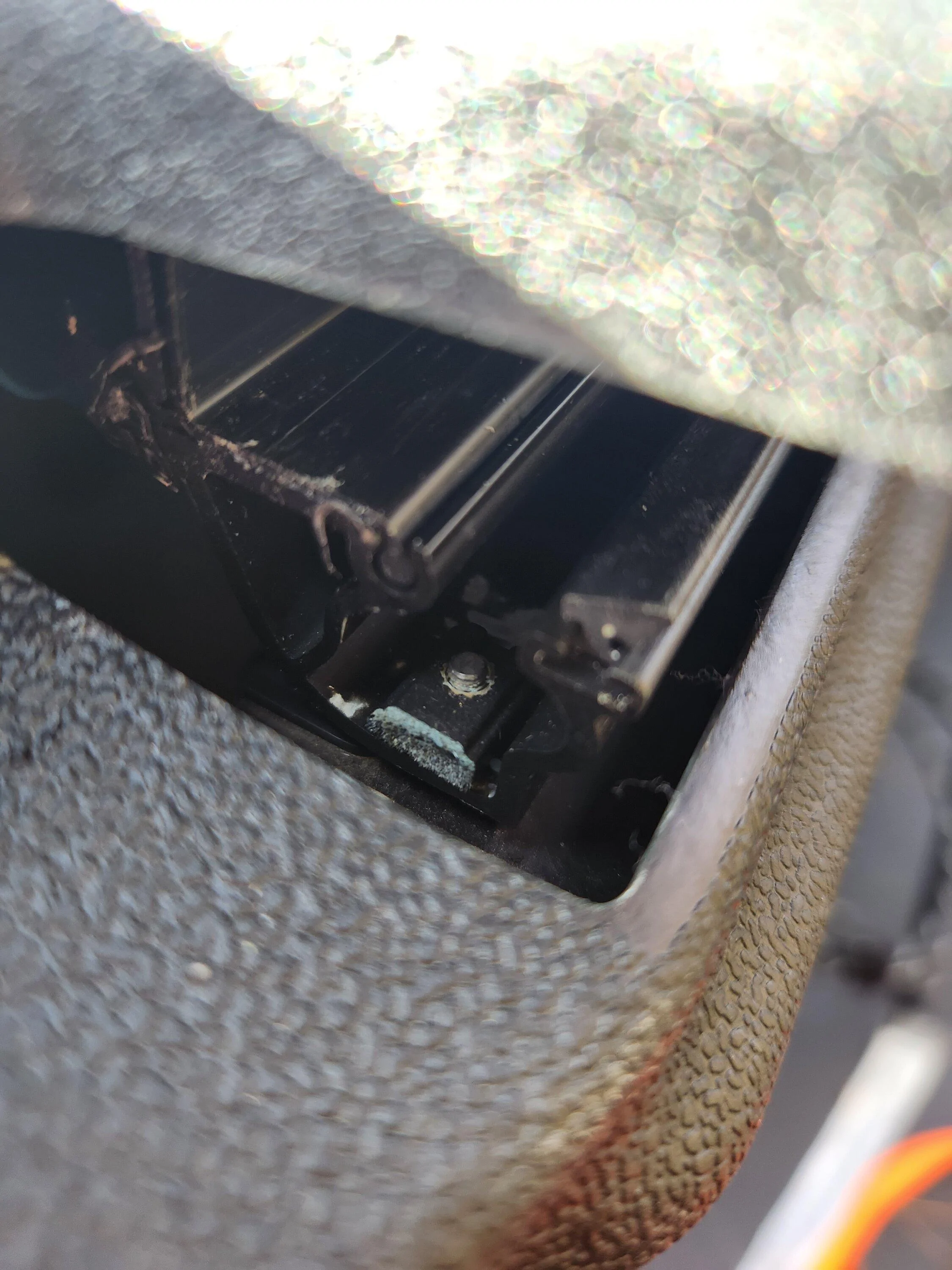

There are two very small torx on top of the cap. They're not hard to remove, I actually used a small allen key to remove them with no stripping. But here lies the rub; there is also one torx on the bottom of the retainer that is basically impossible to get to without ripping everything apart. So I grabbed my need nose and gave it a twist, it snapped off pretty easily. I'll deal with the consequences of that, if there are any, when Rivian has a permanent fix.

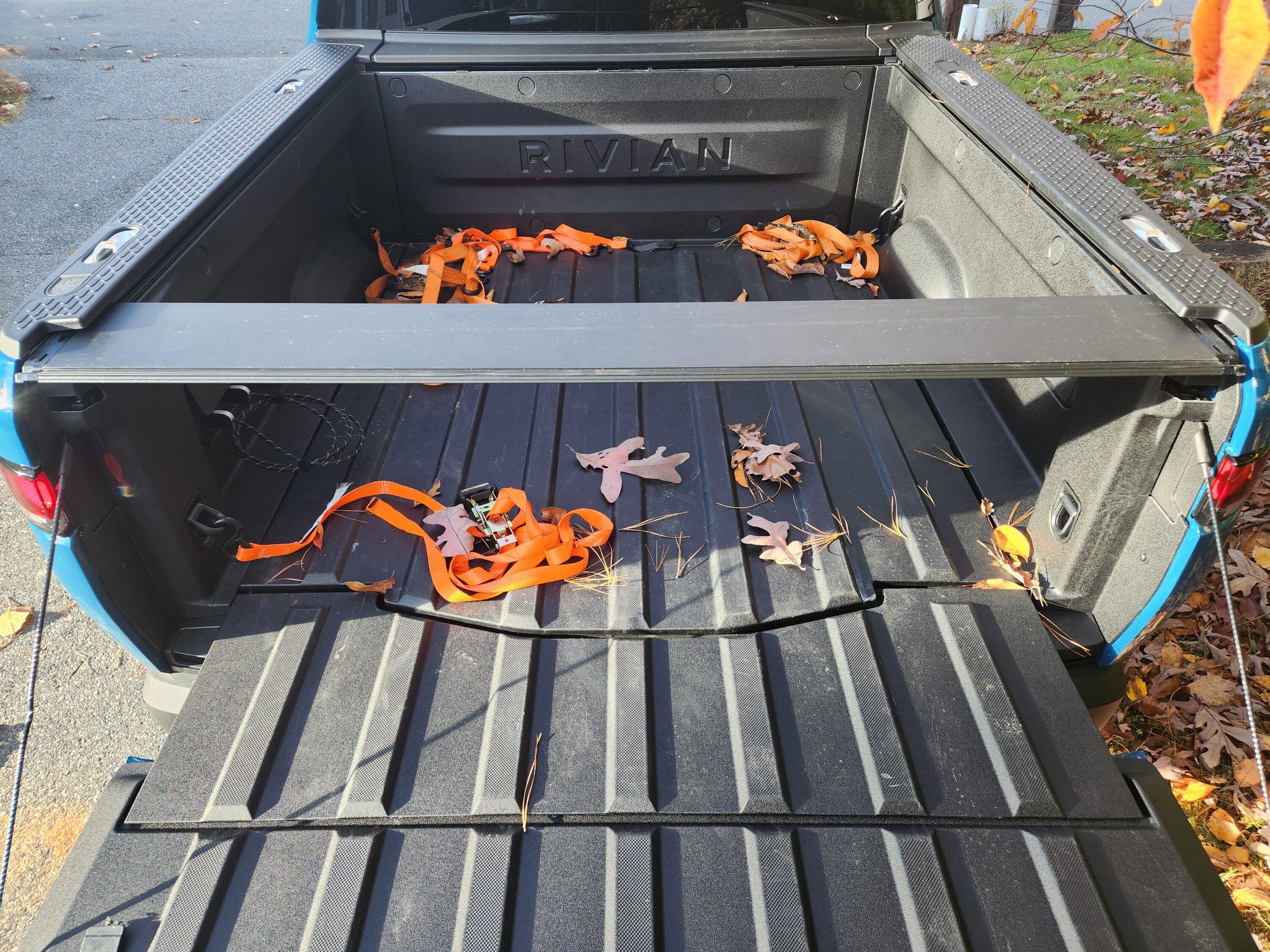

Now the slats slide easily in and out and are held in place by the tailgate. You can remove them all and store in the gear tunnel. When you re-install them, make sure to snap each to the last for a tight fit.
Rivian R1T R1S Powered to Manual Tonneau Bed Cover Conversion -- DIY how-to with photos 20221028_091433
Personally I think this should be what Rivian does for us at the SC. Having the tonneau either stuck closed or open isn't a particularly good solution and this was very easy to accomplish.

So I'm trying to understand exactly what you've done here. Have you broken off those two rear-end pieces that stop the panels from sliding out the back? And, now you can slide panels in and out manually as you need?
loudog3114
James
Dec 9, 2021
124
122
Boston, MA
Tesla P100D, 98 TJ, Silverado SS, 18 Camaro 2SS
Unscrewed the torx from the top of the end caps and broke off the bottom tab because I didn't feel like ripping apart the walls of the bed to get to the last torx on each side.
