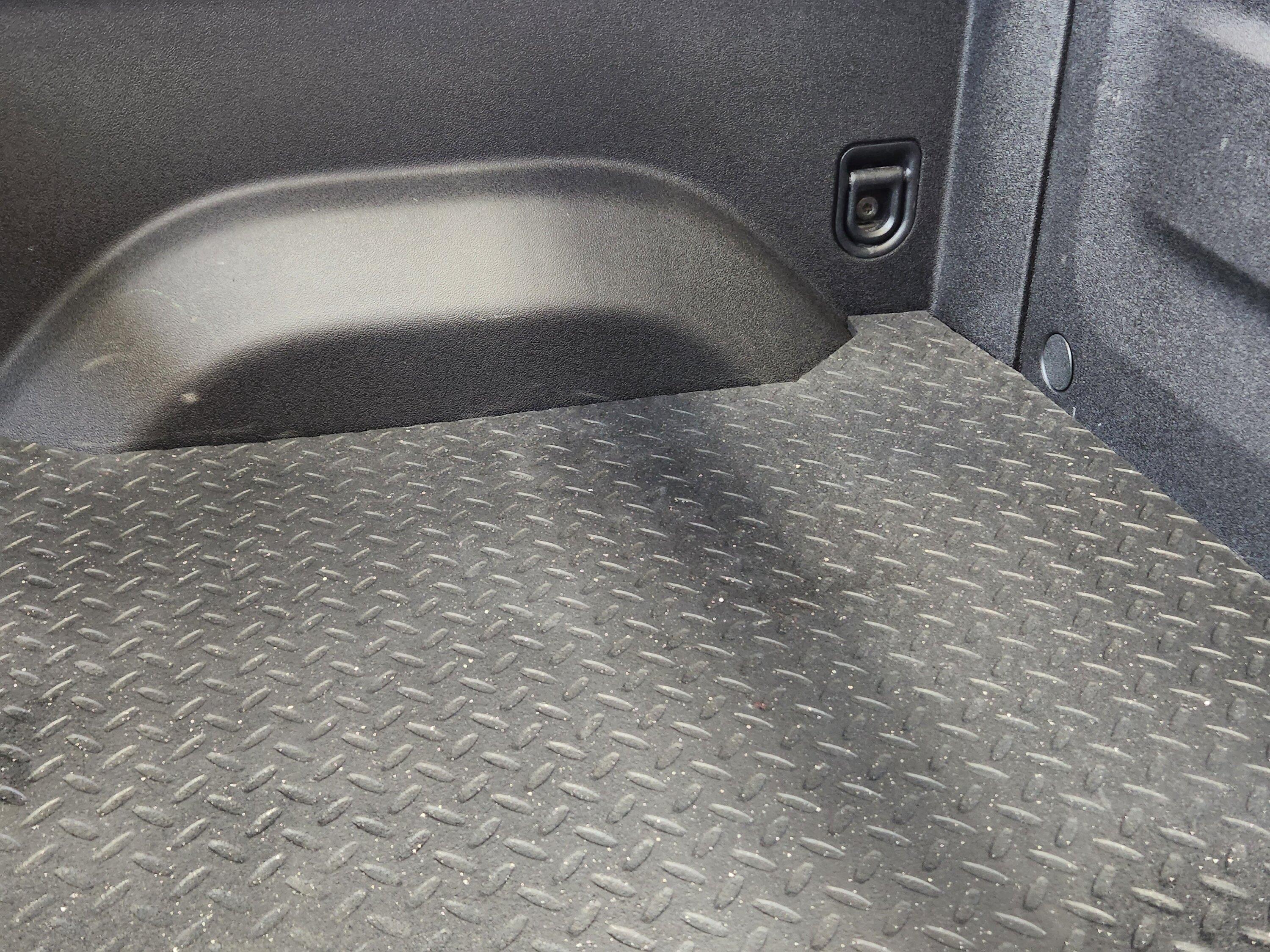

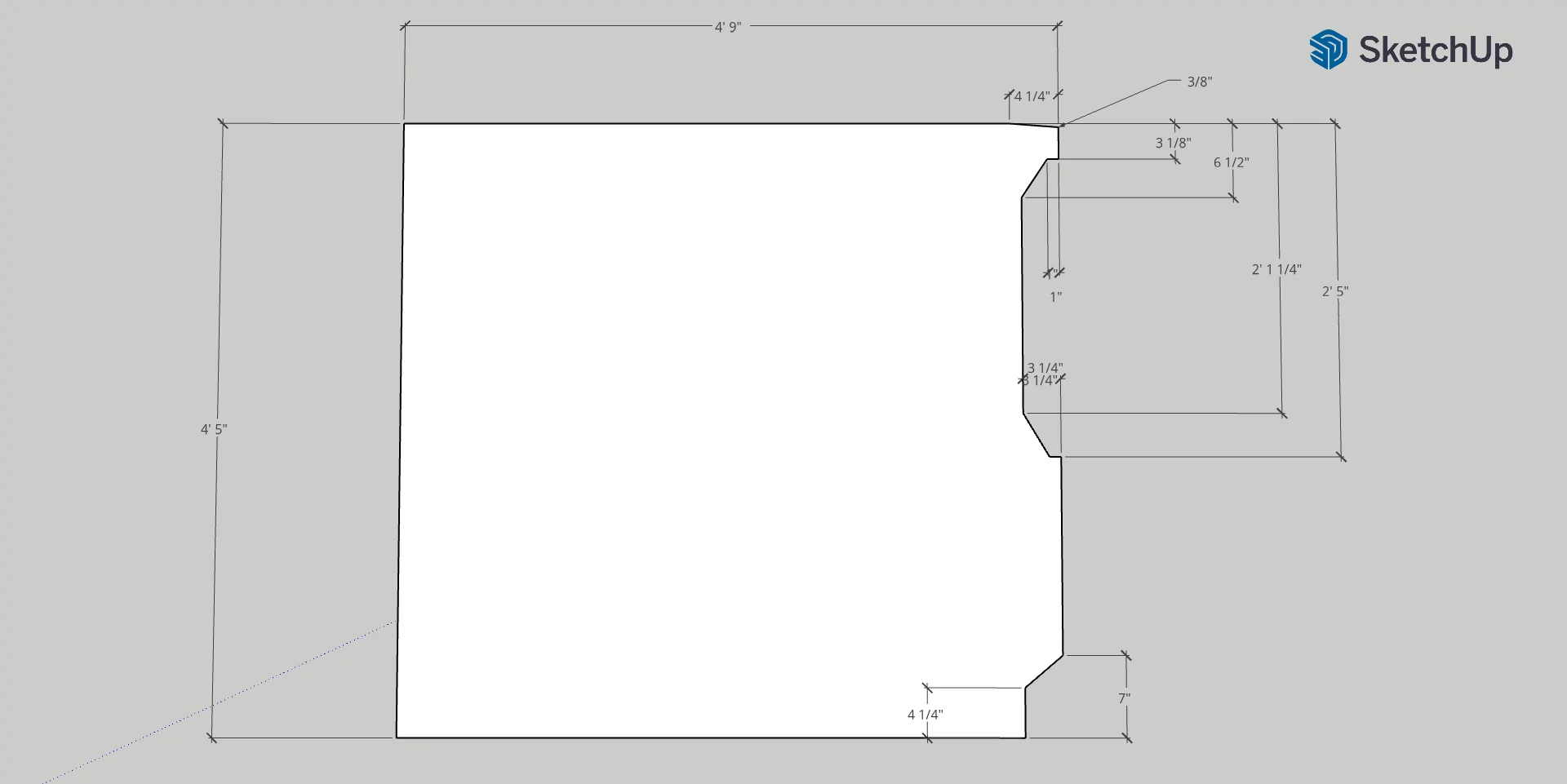

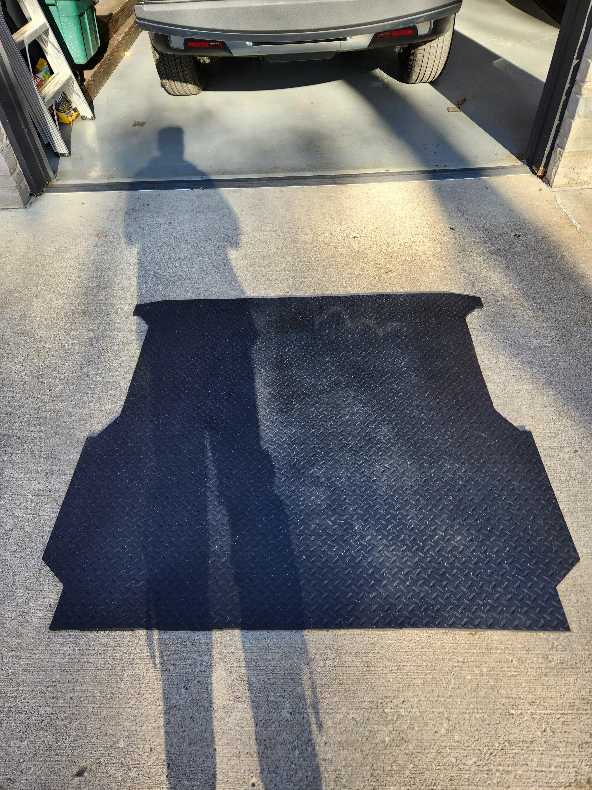

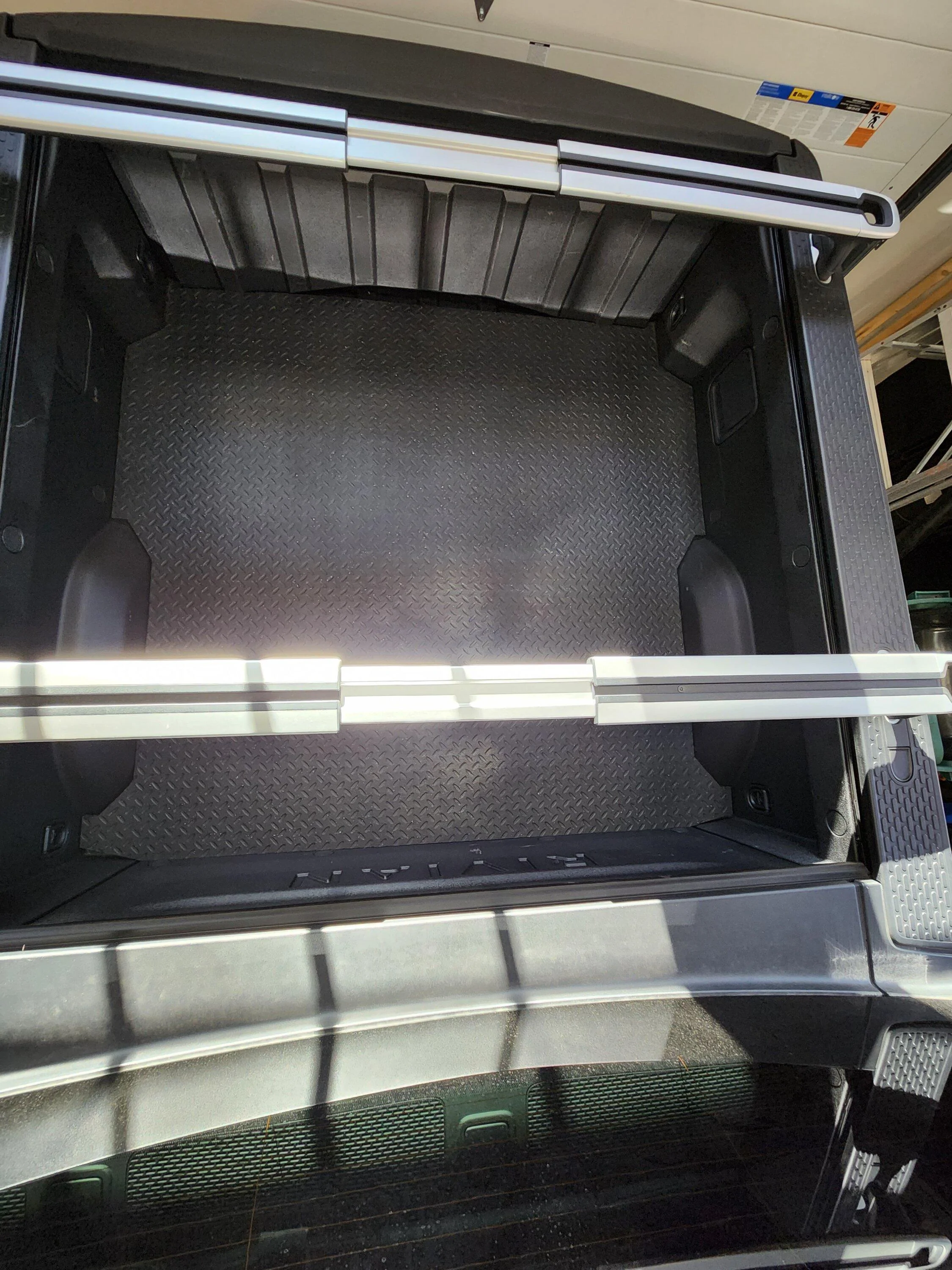

Wasn't happy with a basic bedliner. So bought a 5x7 mat from Black Armour and cut-to-fit the R1T bed. Included link to mat and Sketchup file for the custom cut dimensions. Easy to do.....use a carpet knife to cut the rubber, use a straight edge, take your time & don't lose a finger! The fit is tight, an 1/8" inch either way can make all the difference...but we aren't building the space shuttle...so try to cut to the dimensions but don't get toooo caught up being perfect...you may have to trim here or there.
OR
Top is the front of the bed, back is the tailgate. Both side are mirror image.
Good luck!

Wow. Looks awesome. Did you use tape to make cutting templates or how did you measure?
Didn't make any templates. I measured the bed then laid out dimensions on the mat. Wasn't too complicated. Easiest way to do this is to cut to rough size 53x57"....then layout as indicated & draw the dimensions on the mat...then cut.
