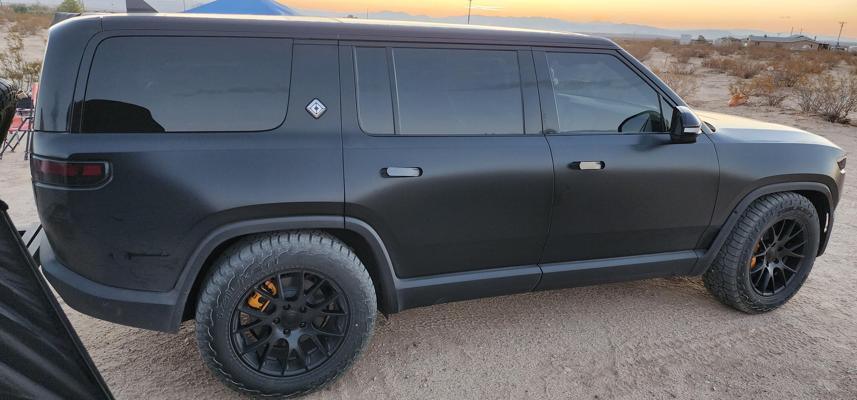

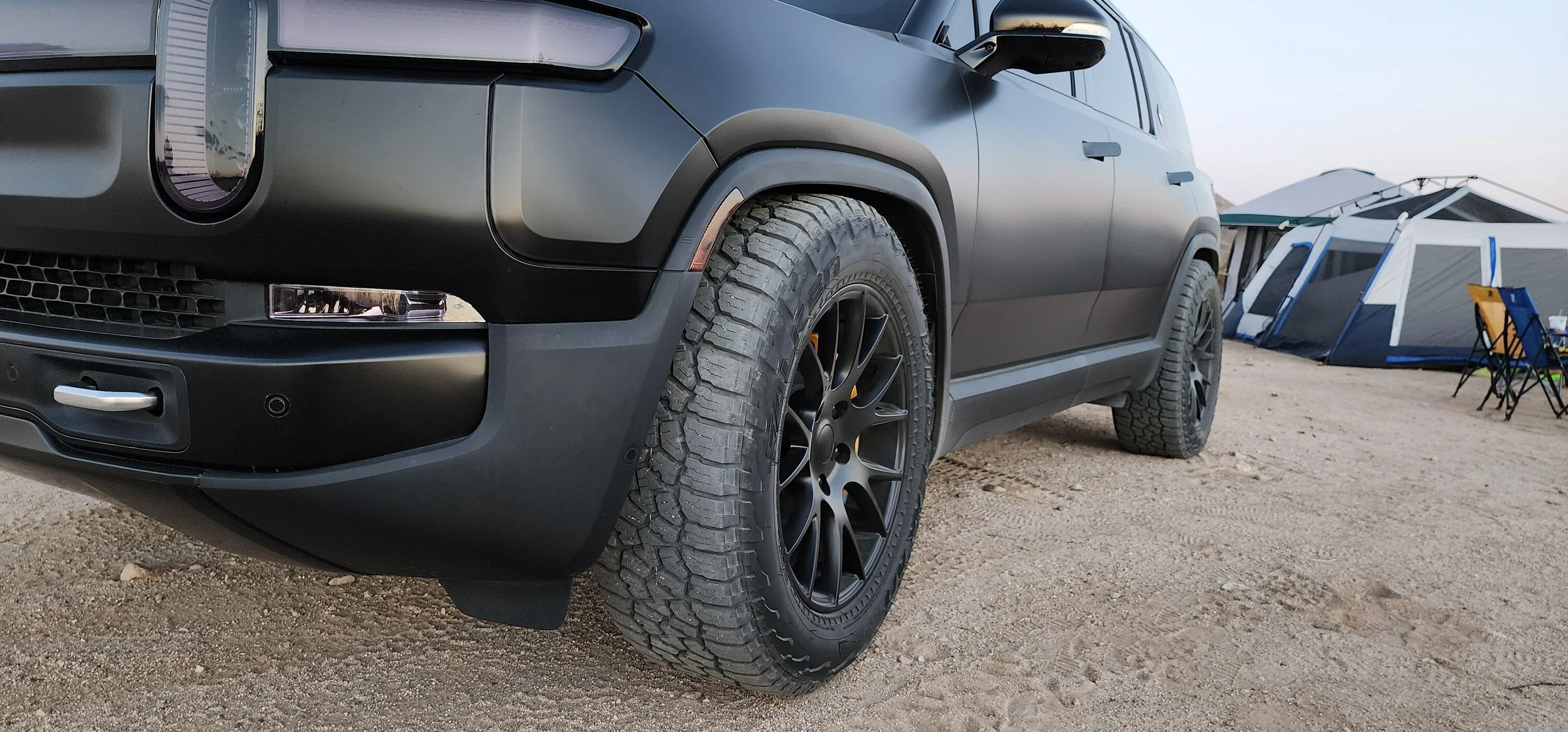

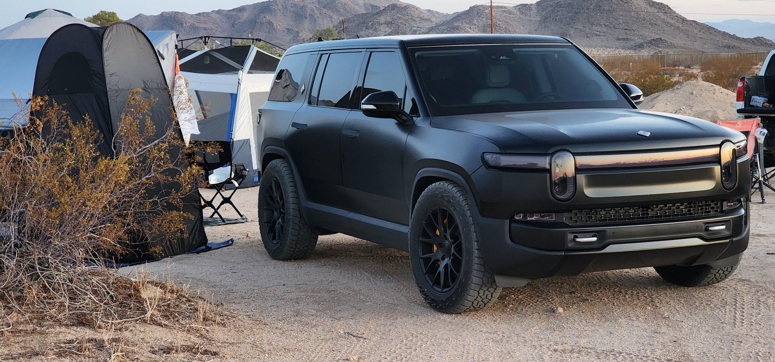

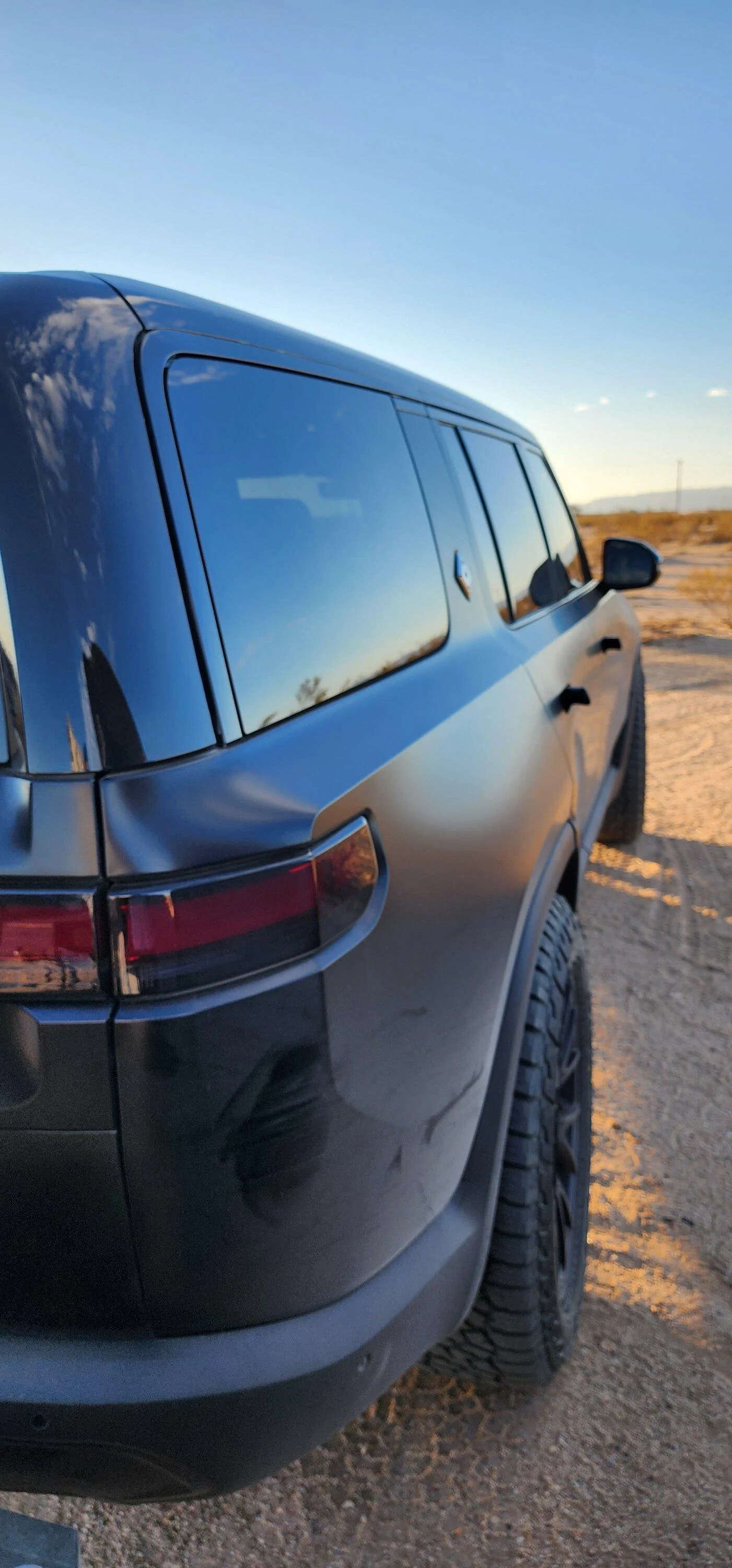

Do you have a wider shot of the whole truck with these installed?

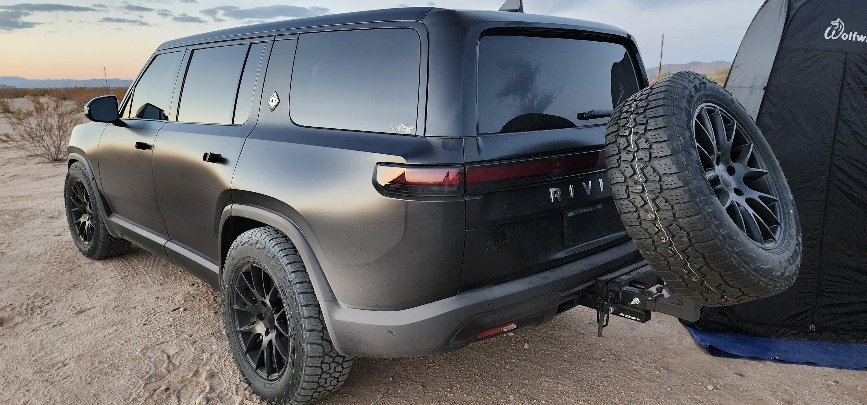

Here you go. Hope this helps...
Rivian R1T R1S Affordable Winter Wheels Setup: Ram 2363 20230813_055322
Rivian R1T R1S Affordable Winter Wheels Setup: Ram 2363 20230813_055627~2
Rivian R1T R1S Affordable Winter Wheels Setup: Ram 2363 20230813_055729
Rivian R1T R1S Affordable Winter Wheels Setup: Ram 2363 20230813_055859
Rivian R1T R1S Affordable Winter Wheels Setup: Ram 2363 20230813_063929

Are these different from All Season? I ended up going with Falken Wildpeak AT3W ?
This is the exact set up i went with. As others said tpms247 is not reliable. Their sensors never worked on my truck and they never responded to any inquiry to return or mitigate the issue.

Without going into too much detail here...no, the reduced load rating on these aftermarket wheels, does not concern me...for my use cases. The same goes for others that I know of that run this exact wheel. I won't be repeatedly towing at the mid or max capacity or constantly slamming my rig into the ground and other surroundings while doing extreme off-roading. And as for my mild to moderate off-roading and overlanding adventures are concerned, I've already calculated my cumulative weight and factored that into my travels. Again, for my use cases, with all gear and passengers, my total load will always be under the 8800lb (2200*4) load rating of the wheels. As a side note, I think the aforementioned Ram 2363 wheels are similarly rated...I could be wrong though. The wheels that I have are also Ram reproduction wheels.
So, all this to say, it depends on your use cases and estimates...as to whether it's worth-it and fits within your expectations. But if you plan to be a hard-core off roader, you may want to find another solution such as OEM, EVSportline, etc.
Good luck!

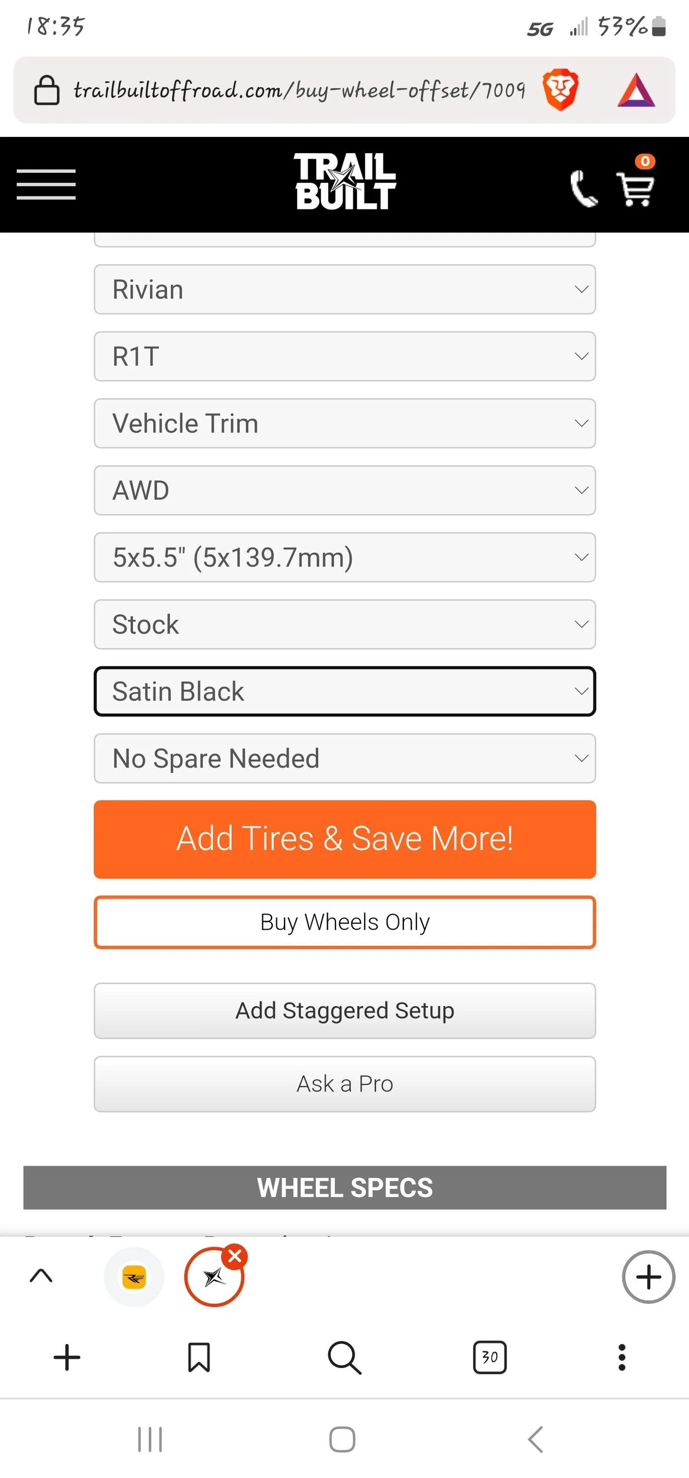

From my Trailbuilt link...???...yep...that's it. Too bad they've bumped the price though. I bought mine in mid-May for $192 each. Guess they're more popular now!
One more thing...GET...A...SPARE!!! ?

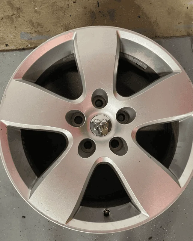

Is this the right Ram 2363 wheel? Found on FB marketplace. Says from a 2009-2012 Ram 1500.
Yup! How much?
I dropped mine at the powder coating shop today, they wanted to poke around the truck and said they're dying to powder coat one. It's very tempting...
