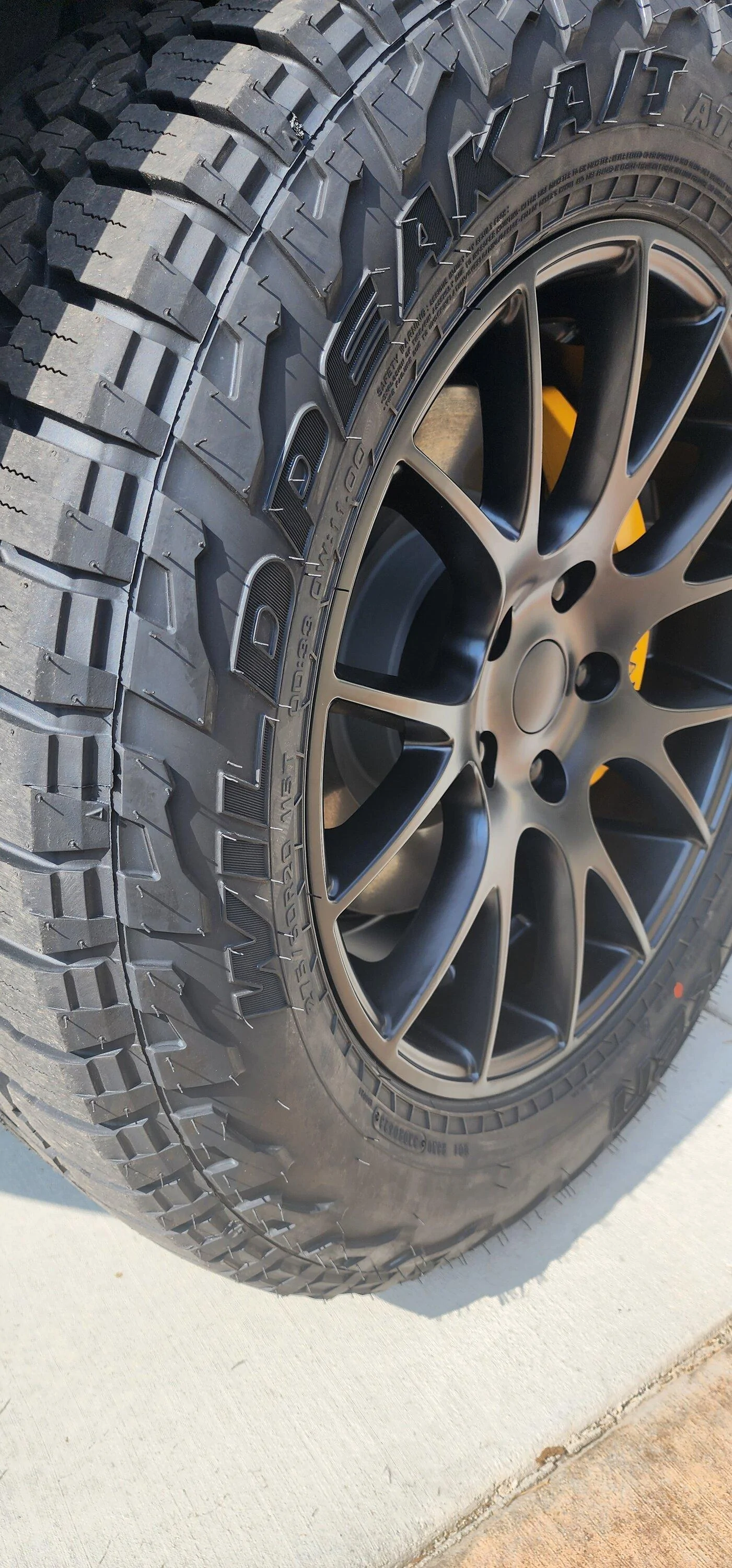

I told you those 275/60/20 Wildpeaks are the way to go!!! And those Ram 2363 wheels were my first off-road wheel choice, but I couldn't ever find them for a reasonable price. Ended up getting the ones I have for cheaper than what used Ram 2363 wheels would have cost me. I assume people like you @Puttyandnapalm found those wheels pretty cheap. All-in-all...this is a great low-cost, off-road setup!
What wheels did you get that were cheaper than the Ram 2363s?

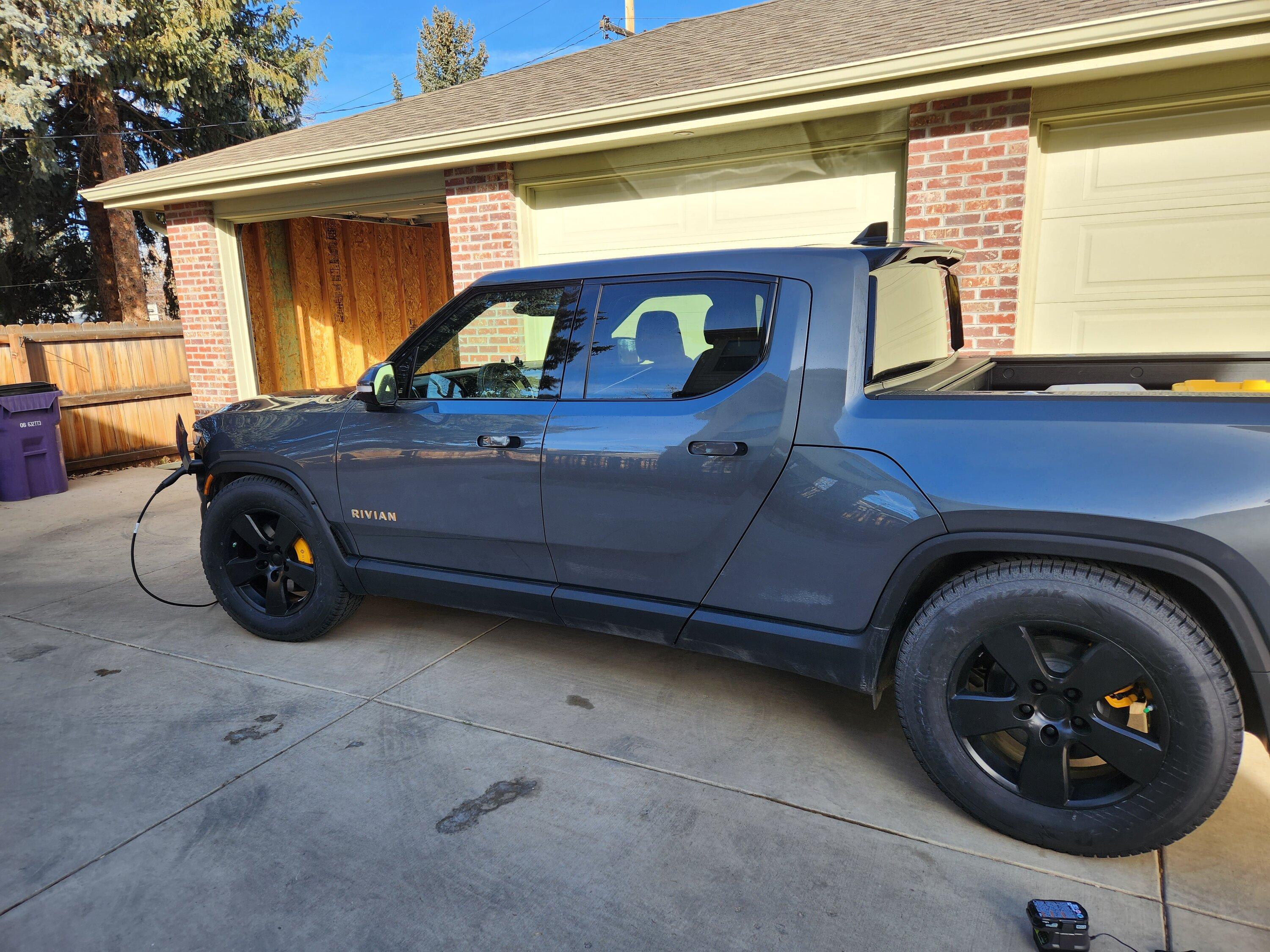

Please note that I have the ram wheel setup. I bought blizzak lt 275/65/20 and they rub on lowest when turning and bumps. And low rubs on heavy bumps. I use low only in stiff mode.
Rubbing isn't major. I bought my wheels for 250 off fb and rattle canned them
Does anyone know a cheap 20 wheel with a larger offset?

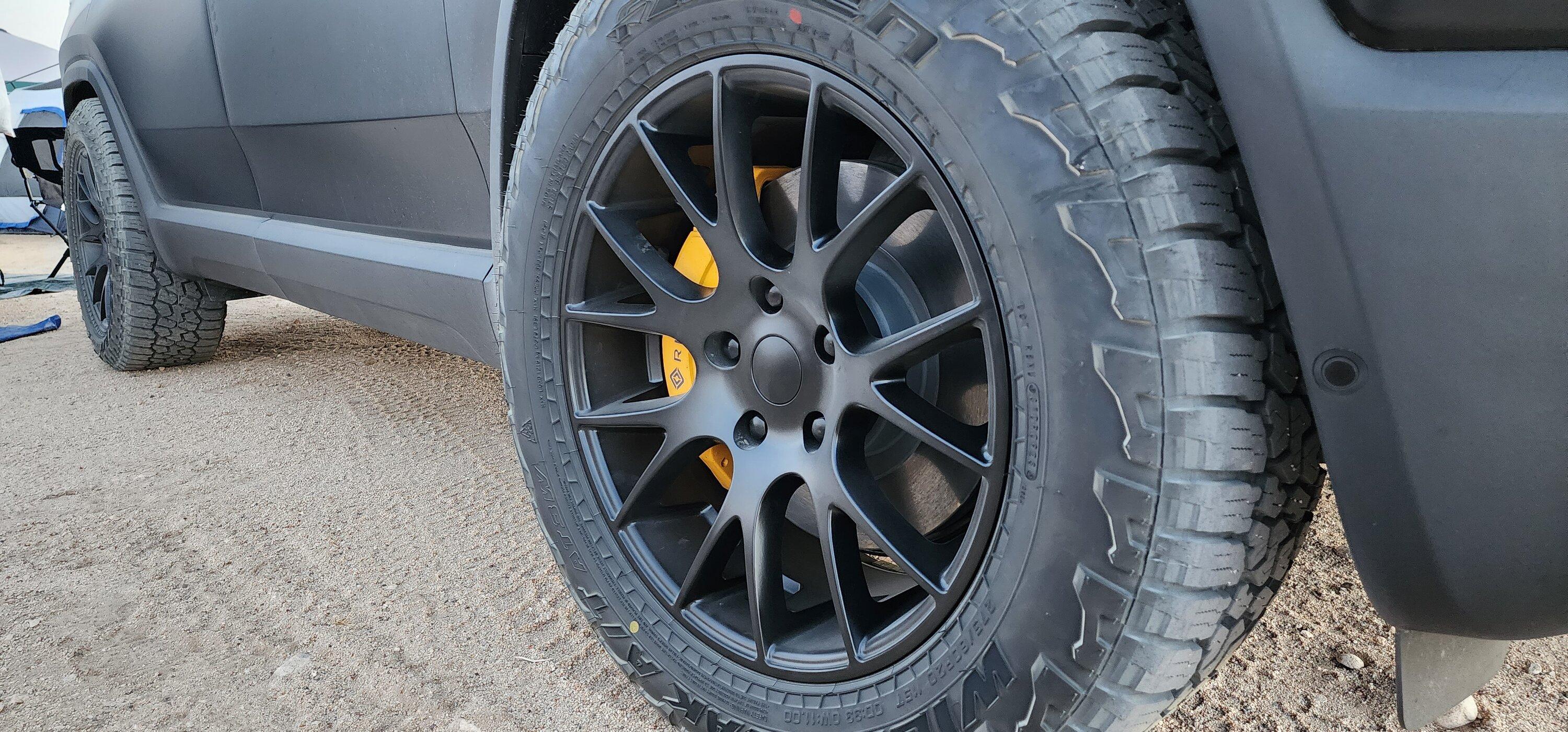

Yes, confirmed. These wheels fit, and clear the calipers. https://www.trailbuiltoffroad.com/b...tory-reproductions-fr70-20x9-25#review-system.
Because they are +25 offset, they have a little more 'poke' than +48 OEM wheels, but I like the more aggressive stance. I've had them installed for almost 2 weeks now.
