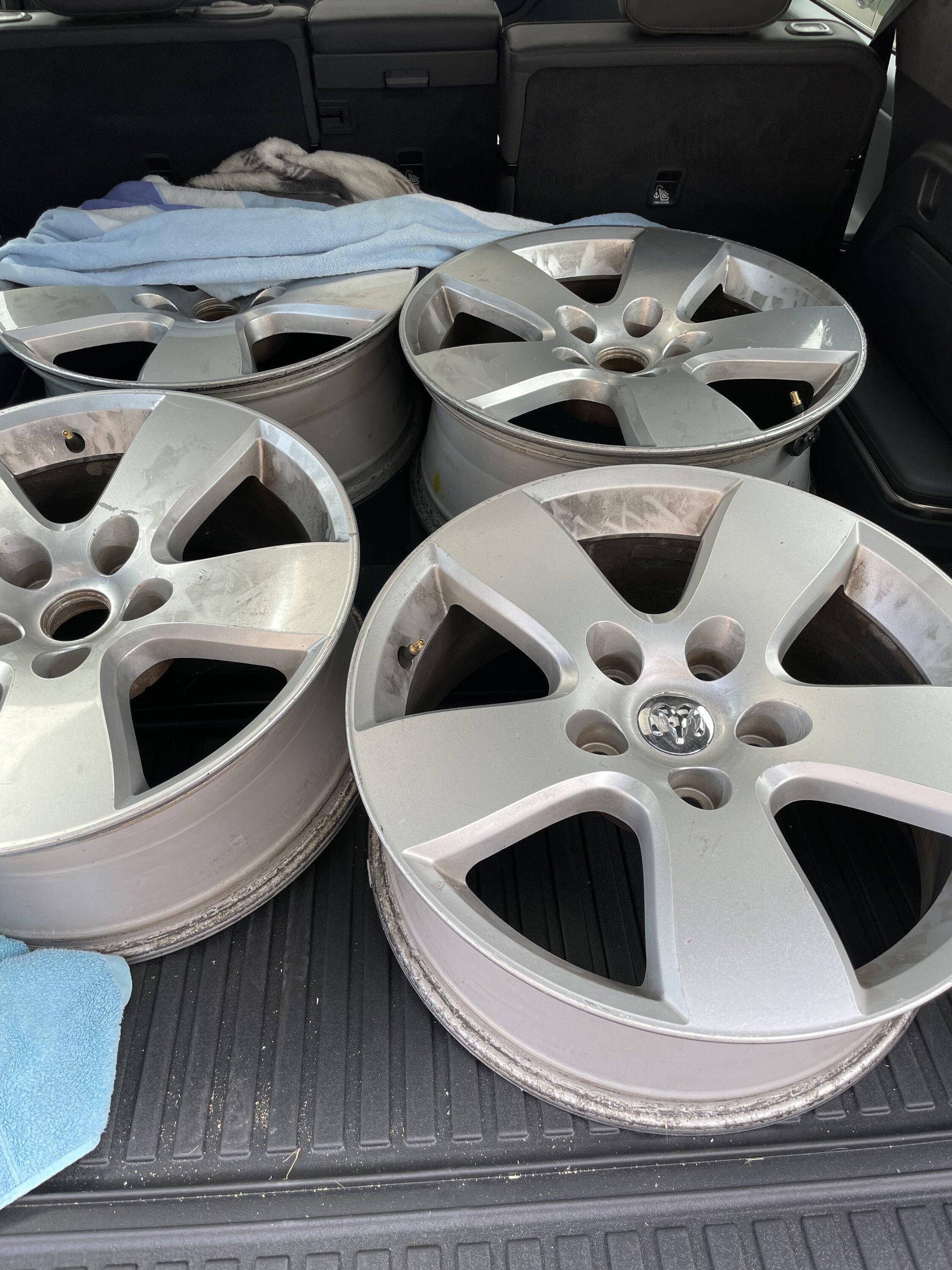

My 2012 Dodge TPMS senders had dead batteries. I replaced with new. One wheel complete. 3 to go. I'm too cheap to buy new center caps so I painted the ones that came with the wheels. I now call the truck a Rivian GOAT. Still have not decided on tires.

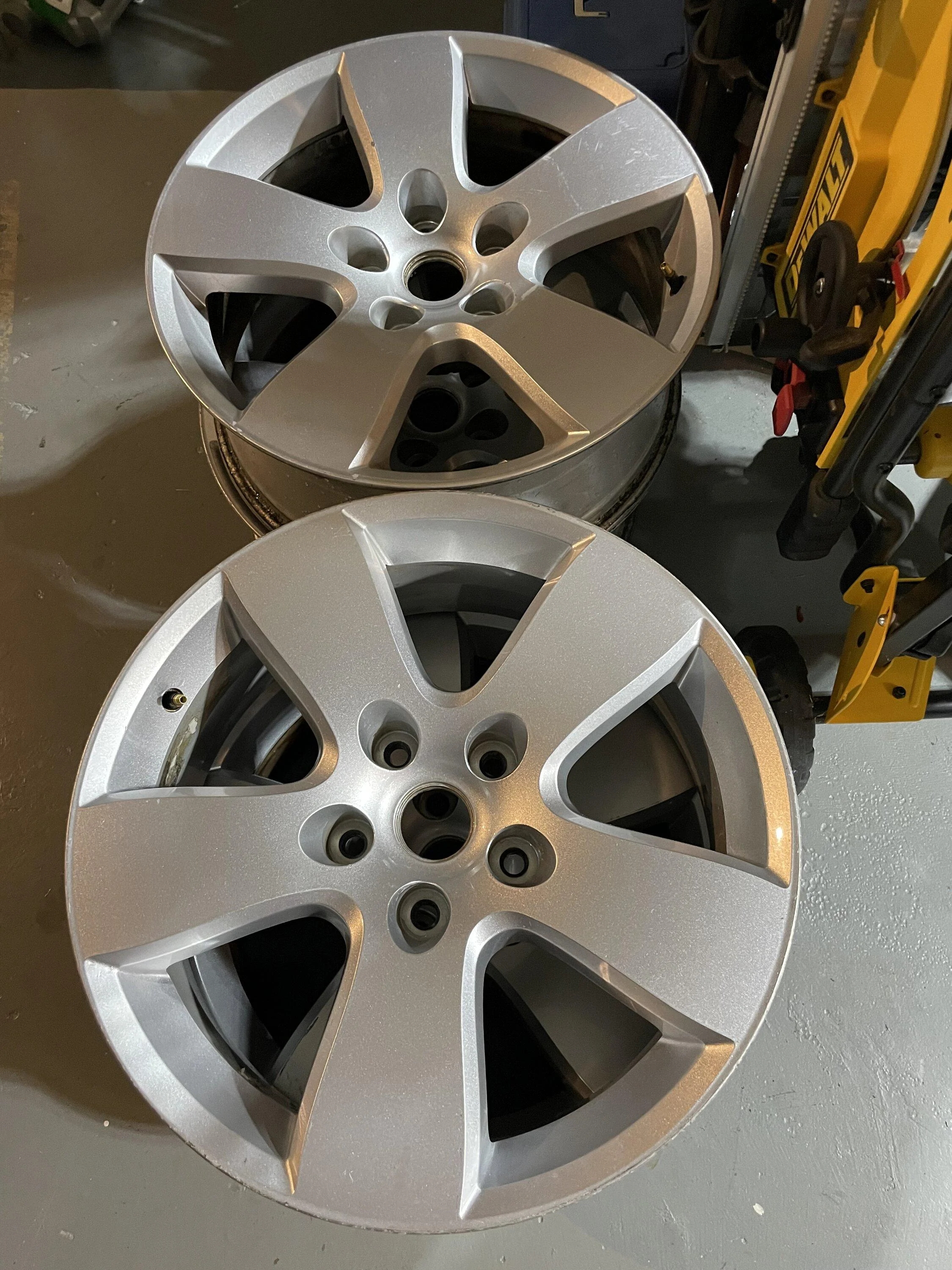

So far I've power washed the rims and sprayed/scrubbed with wheel cleaner. Next I'll scuff them with either a scuff pad or sand paper and use simple green to really degrease and clean them. Then cross my fingers and paint.
Like you, I saw only good things about dupli-color and their bronze looked darker, which is what I wanted. Will post pics once they're done.

If my Ram caps don't work I will buy new caps. There is a link in the first post on this thread. $24 on Amazon. I cleaned all the wheels with simple green and a red scotch brite pad. Then I wire brushed them using an angle grinder and wire wheel. I had lots of areas, under the bead and anywhere a clip on balance weight was attached, that had corrosion forming above and under the OEM powder coat. All that had to be cleaned off to bare aluminum. They put lots of salt on the roads in Utah so this's sort of normal wear and tear on cars in this area. Then I washed again with just dishwashing soap and water, then sanded with 400 wet paper, let it dry and scoffed all surfaces with red scotch brite pad, then cleaned about 3 times with lacquer thinner. I kind of go overboard with the prep but it usually pays off in longevity. I had to prime the bare aluminum areas before painting. Lots of work but I'm almost finished with the prep on all the wheels. the Dupli color paint is a satin black and the rustoleum is flat so I will have to scuff the new paint and spray the rust oleum on top of the already black wheel. Right when I finished spraying the last coat on the wheel the wind picked up and lots of dust and dirt was deposited on the fresh paint so scuffing and painting a finish coat on that wheel probably needs to be done anyway. Plus the wind knocked my center cap off the stand where I painted it and it took a long trip down my driveway into the road and it got covered in dirt. Lesson here is spray in the morning before the wind picks up.

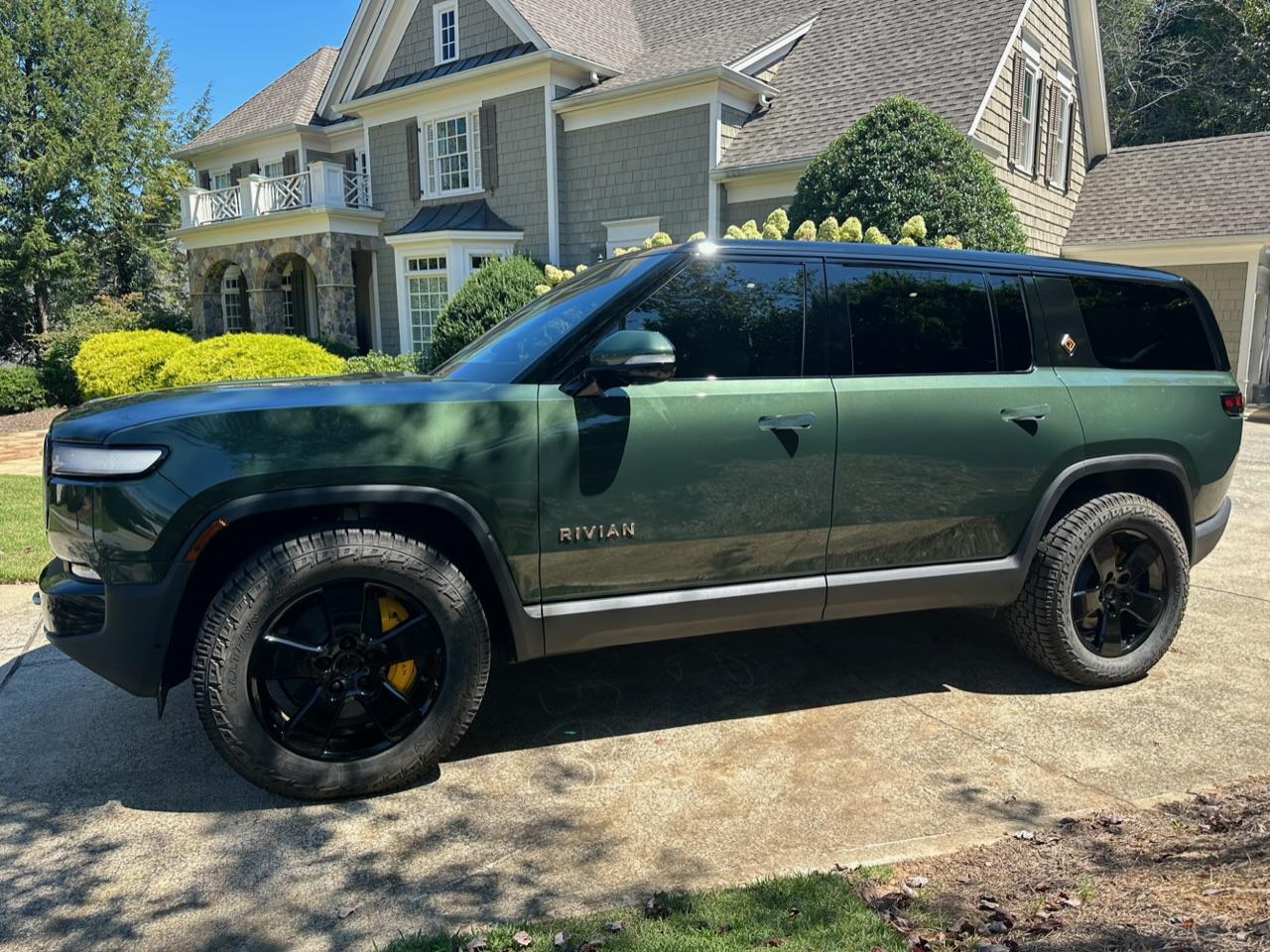

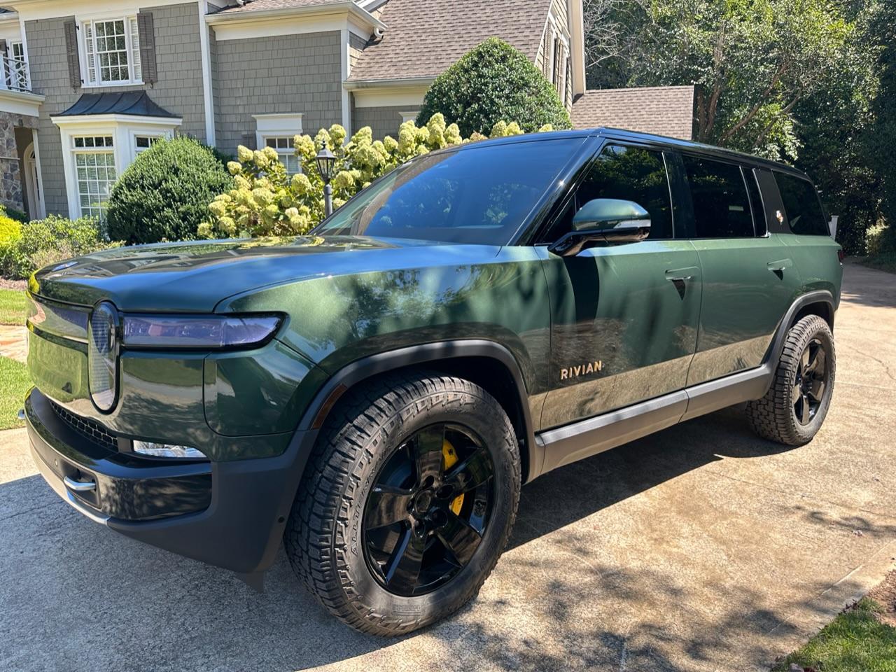

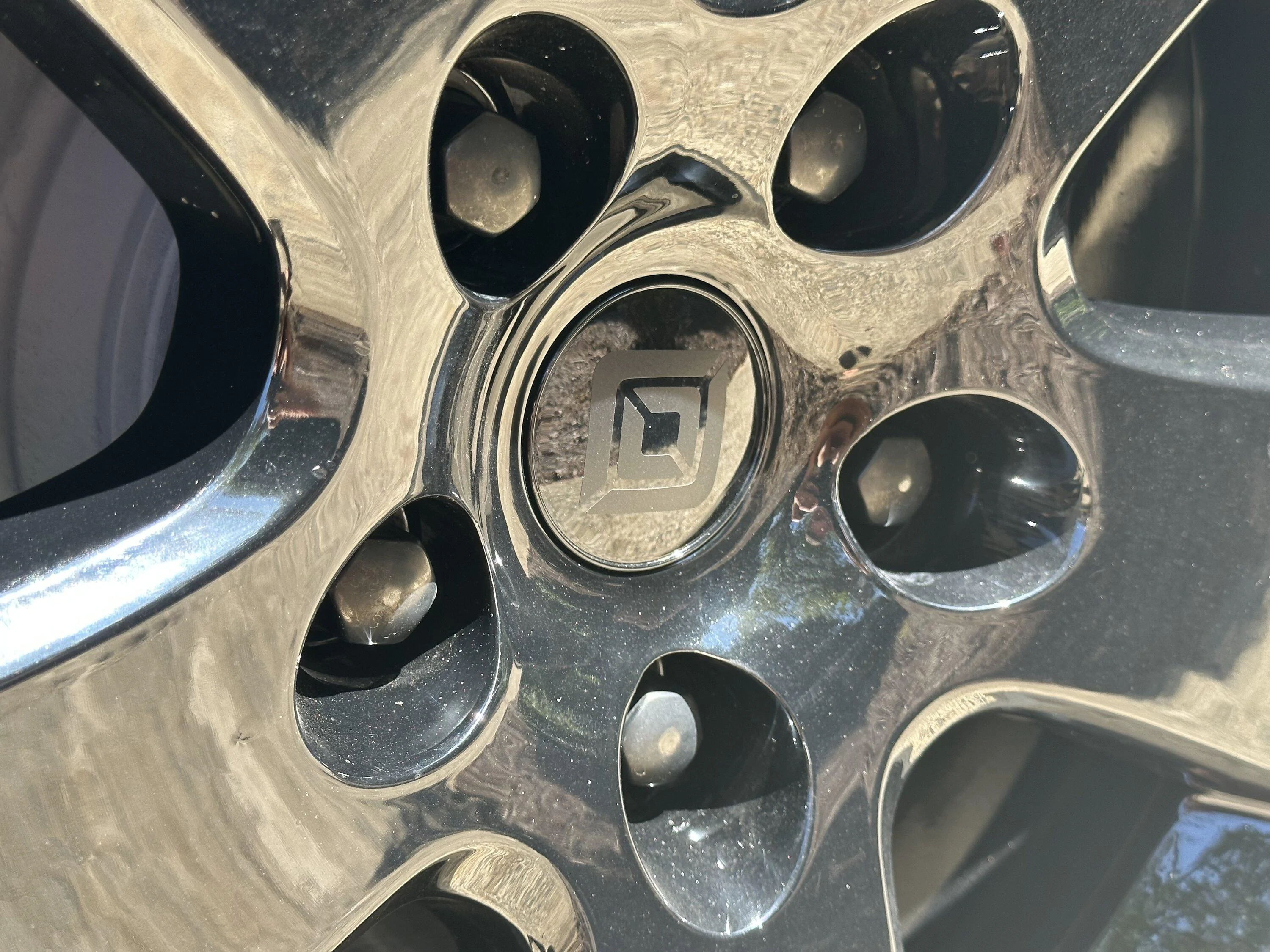

Pretty easy decision to run some ram wheels. Found a set of brand new scorpion 275/60-20 tires for $500 and fabbed up some black matte rivian center cap stickers. Happy w the results.

Can you share the file for those stickers?
WOW!!! Now THAT looks fantastic! Those wheels look so good on your truck!
