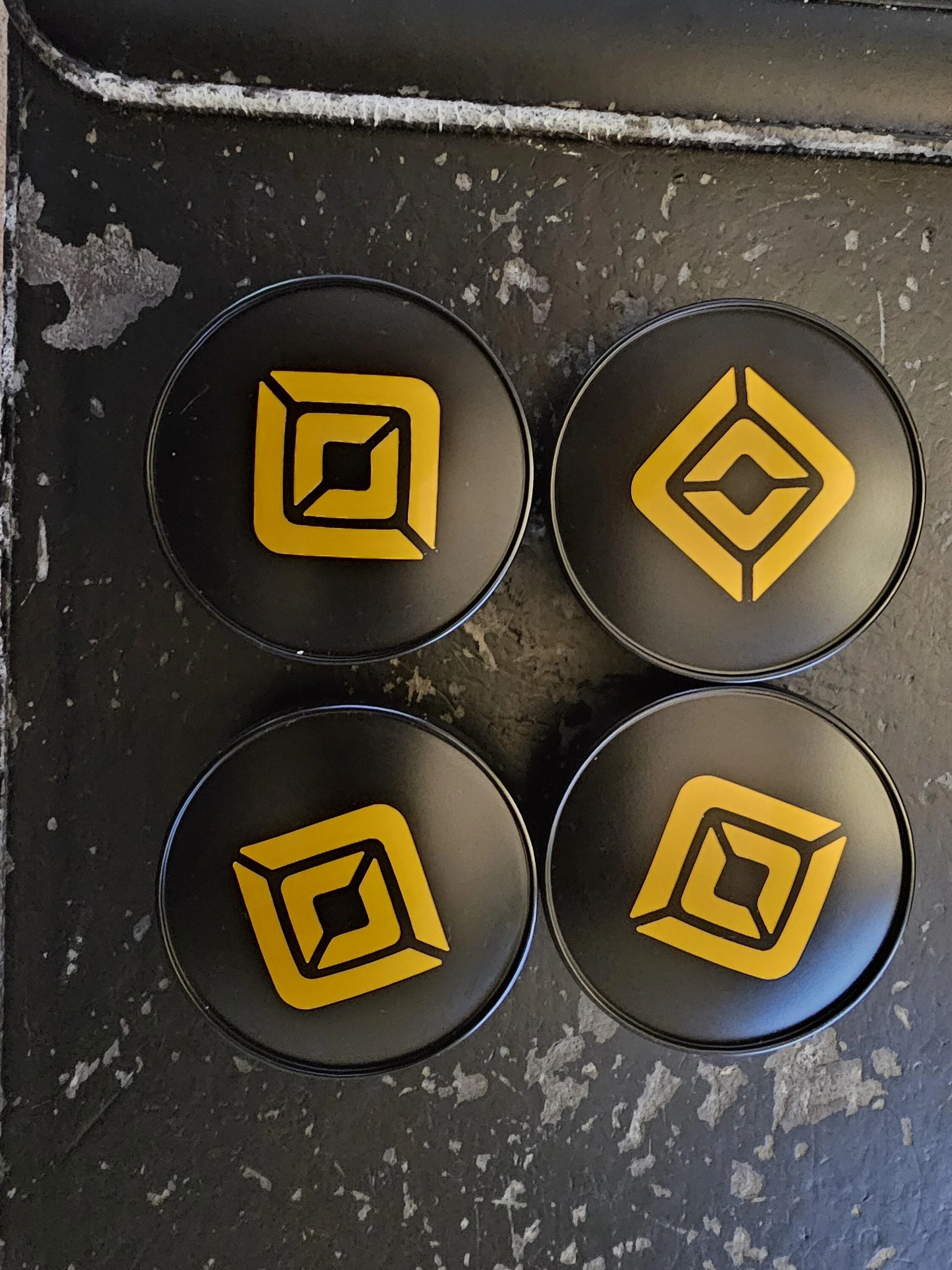

New center caps. Lucked out and Abstract Ocean had some center cap logos left to affix to center caps for the Ram hubs. Just need to clear coat

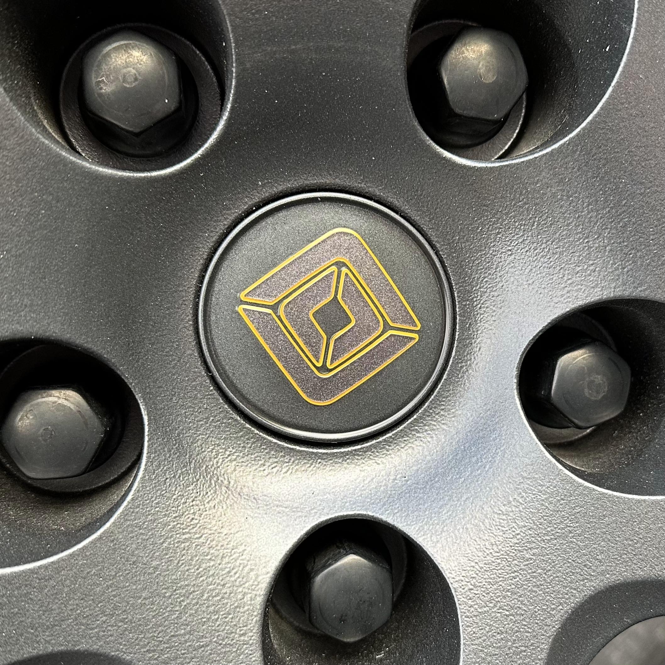

I cleared over my vinyl emblems as well (2 layers of vinyl, charcoal over yellow). Put about 6-7 coats on to really seal in the edges, and was perfectly fine for the winter, and through touchless car washes with wheel sprayers.
