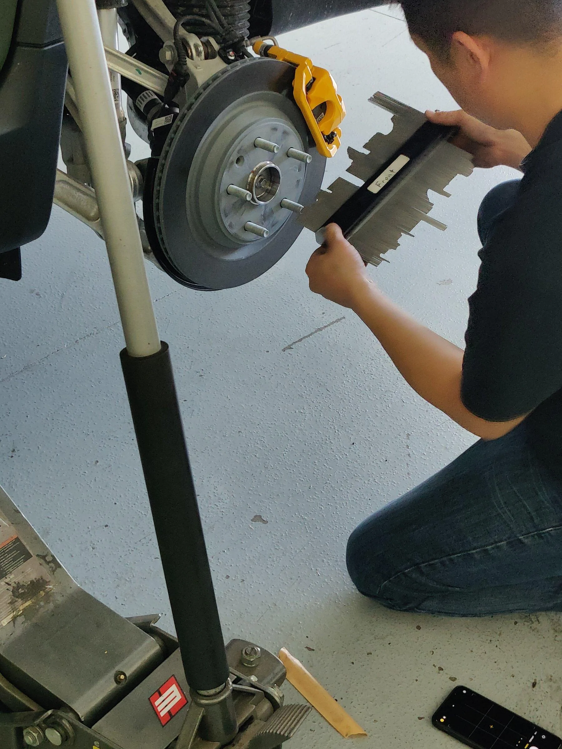

Yes you are correct. But the offset is +48 due to the large calipers. With the offset, bolt pattern, wheel diamter wheel width, and weight limits, there are none. I have spent the last several days searching those specs.
While you might not expect to find exact Rivian spec'd wheels available... you can always go with less offset and push the wheels out further to clear. Yes you may get the tires into the fenders during full articulation, but if you want aftermarket wheels there is always a way to make it happen.

The offset really isn’t a function of the caliper it’s where the barrel is going to be centered in the wheel well. Too much offset and you may rub the inside on the suspension or steering at full articulation. Too little (or negative) offset and your steering center will not be in the right part of the contact patch or the outside edge of the tire may touch the fender. Spoke design will dictate if it clears the caliper (but that doesn’t exactly show up in the wheel specs). Someone will have to have to experiment a little to see what fits.

Offset and backspacing are both important WRT fitting over brakes.
