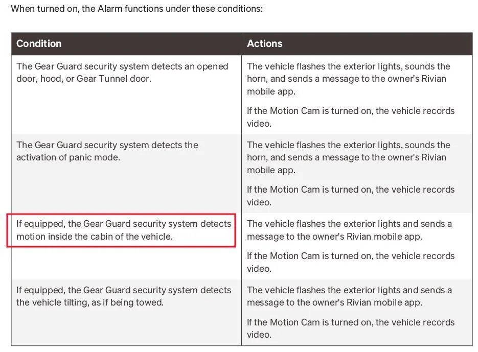

Have not experienced that. It will alarm if motion is detected in the vehicle so that could explain when the dog was in the truck. Interior motion detection can be disabled (I have this turned off because of my dogs).
Outside of that, you may be dealing either with a software bug or defective sensor. Here are the conditions that can trigger the alarm:
Rivian R1T R1S Alarm triggered repeatedly - it is my dog? 1746891076228-q7
Panic mode seems an unlikely trigger in your case, as does tilting (unless it's a sensor causing a false reading).
Not sure how interior motion is determined so not sure if something like high winds might trigger a false alarm. Was it windy at the time of the alarms, especially those not potentially triggered by the dog?
If no legitimate physical triggers can be identified, perhaps a faulty door, hood, tunnel door sensor. I know there were some early issues with vehicles not wanting to sleep due to hood sensor issues.
