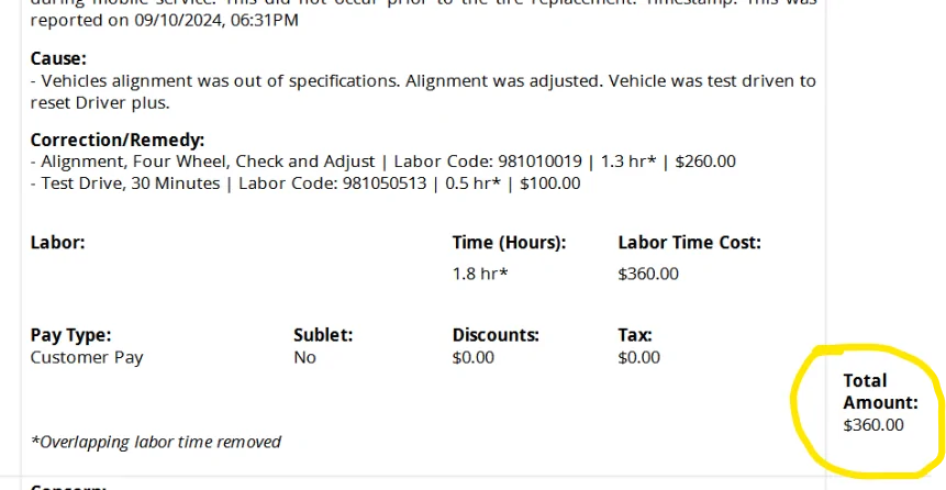

How much are the SC’s charging for an alignment?
$260 for the alignment + $100 for 30 min test drive, September 2024. Maybe variable depending on hours required? Fwiw, I'm very happy with the quality of the alignment at Gaithersburg SC. Tracked great after this. 😊
