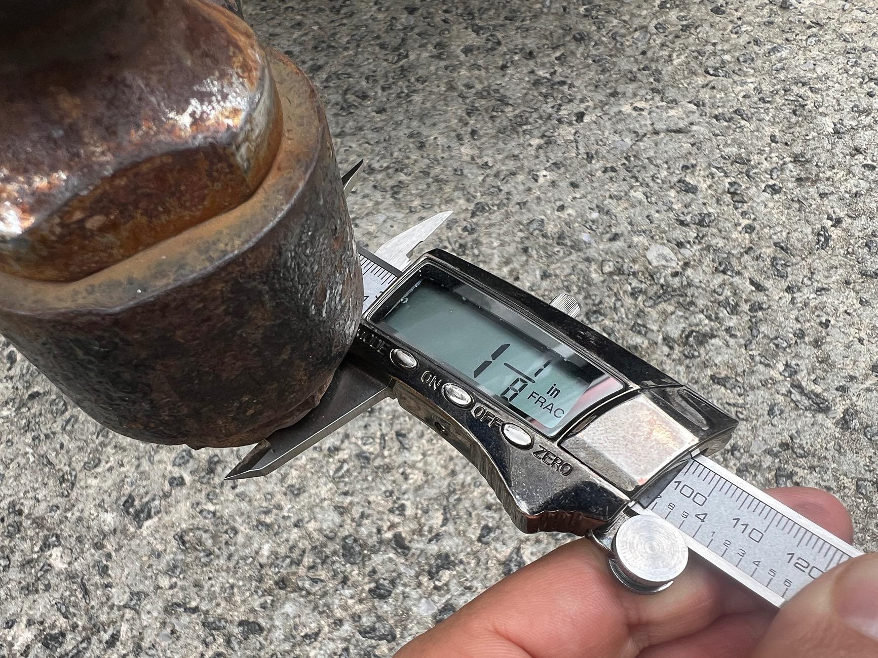

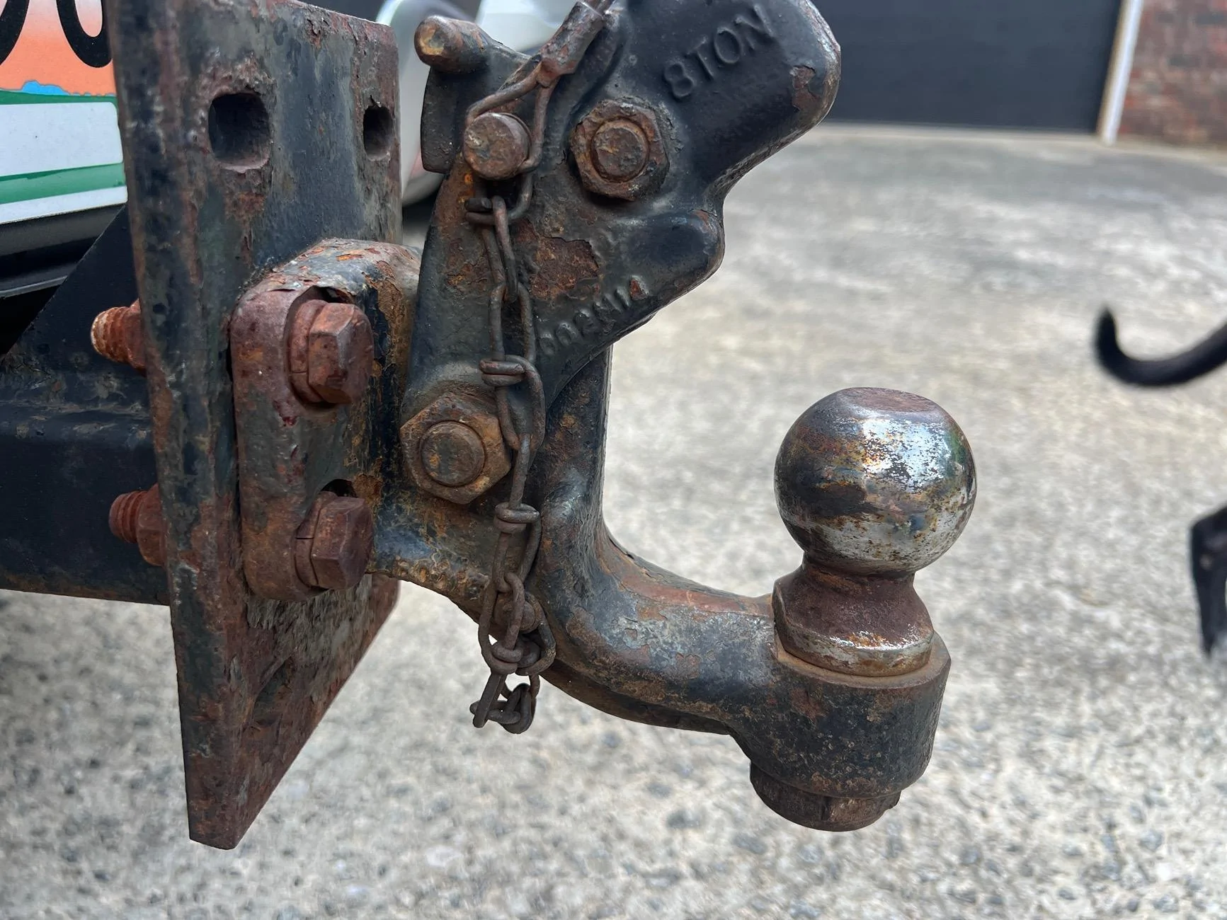

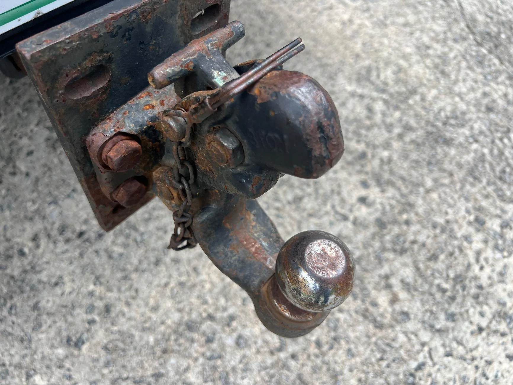

Going back to the ball tugging argument, I totally get that everyone has their own opinion. And we're all entitled to our opinions. But opinions based on data carry a lot more weight (ha! See what I did there? ;)).
Here's some food for thought for all those that think pulling on a trailer hitch ball with a chain will result in certain death. The American Institute of Steel Construction (AISC) Steel Construction Manual states the available shear strength is the smaller of shear yield and shear rupture, which are defined as
Shear Yield: Rn = 0.60FyAgv
Shear Rupture: Rn = 0.6FuAnv
Let's, for a moment, ignore the 7,000 lbs. stamping on the 2" ball (which I'm sure has a healthy safety factor) and assume Fy (minimum yield stress) = 36 ksi and Fu (minimum tensile stress) = 58 ksi (conservative). Based on the measured 1.125" diameter of the shaft, Agv (gross area subject to shear) = 0.994 in^2 and Anv (net tensile area subject to shear) = 0.763 in^2 (from AISC table 7-17).
Simple multiplication shows us Shear Yield controls with Rn = 21,470 lbs. Keep in mind (assuming the 36 ksi yield strength is accurate) this ~21k force is the amount of force needed for the steel to yield (i.e. permanently change shape/deform). This is not necessarily the force it would take to catastrophically fail. Steel is great in that is typically gives us indicators when it's overstressed. It doesn't look like my ball is bent or cracked (naked eye).
The only argument here should be was the force I applied on the ball anywhere near 21,000 lbs.? That's approximately 3x the weight of the truck. Like I said earlier, without actually measuring force with a dynamometer, we're just guessing. But I suspect it was not.
At the end of the day, I 100% agree that you should definitely avoid using a trailer hitch ball as an attachment point for vehicle recovery. Should you use it for light yard work like I did here? That's for you to decide. Me personally, I'm going to keep yanking and tugging on my balls and shaft.
