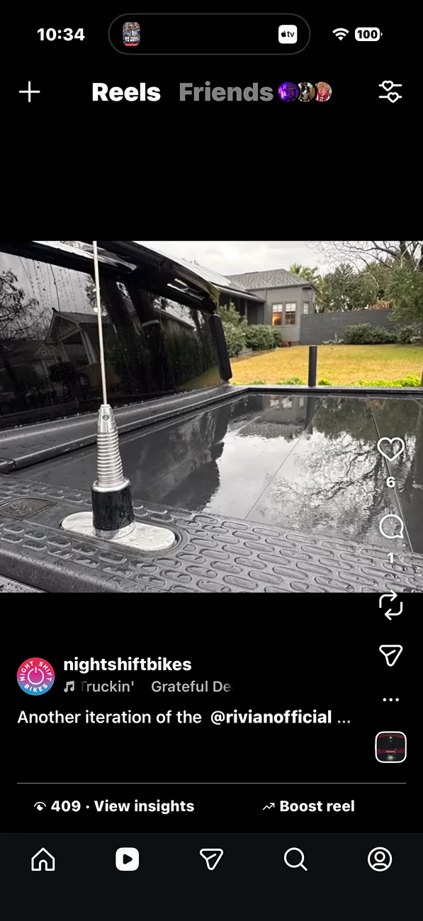

Sold my truck but made some cnc replacements for the rear rail tie downs the ran flush mount nmo for compactenna and gmrs.

I want to mount a VHF /UHF NMO mount on the rooof rail of my 25 R1S any Ideas ?
the mounts I made for rear should work up there; just need a wiring plan.
