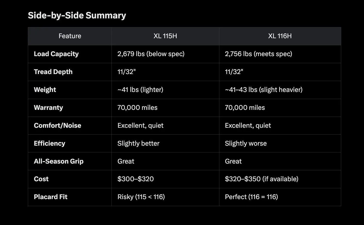

Be interested in whether Costco is willing to install the 115s. I just got back from Discount Tire where we spent about an hour trying to sort through various 22" tire weights and options. Bottom line, DT says I need to replace with HL / 116 version of the Defenders (vs. XL / 115), but that will add about 10-12 pounds of rotating weight on each corner (and they're more expensive). I would much rather get the 115s if I can find a dealer willing to install them. I don't tow anything anyway, so the extra load rating is wasted on me -- both in terms of my expected efficiency and the extra cost.
I came to the same conclusion and my local garage was happy to swap out and mount the XL 115Hs. They actually agreed that unless towing or trailering loads the 115s stand out for range and ride.
I also did a GORK comparison of tire options for the first gen. R1S and you can find that here.
I settled on the Michelin Defender 115H after comparing the to size options on GORK
Michelin Defender LTX M/S2 275/50R22/XL 115H vs Michelin Defender LTX M/S2 275/50R22 LT 119/116S
