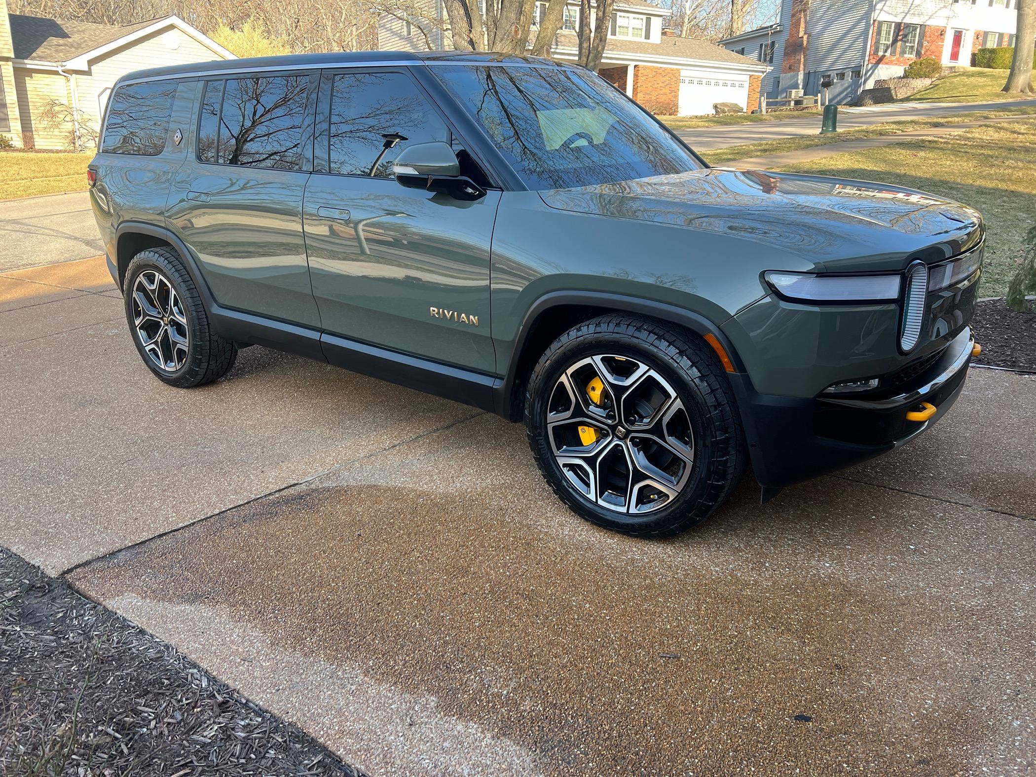

Not me but I’m at 2.27 mi/kwh now since installing AT. I’m at 2.32 lifetime. This is a little skewed since weather has been good for efficiency for the majority of miles. Before winter I was at 2.42 so I think a 7% hit for AT is still about right. If you need every last mile get the HT otherwise on just looks alone, the AT is great.
