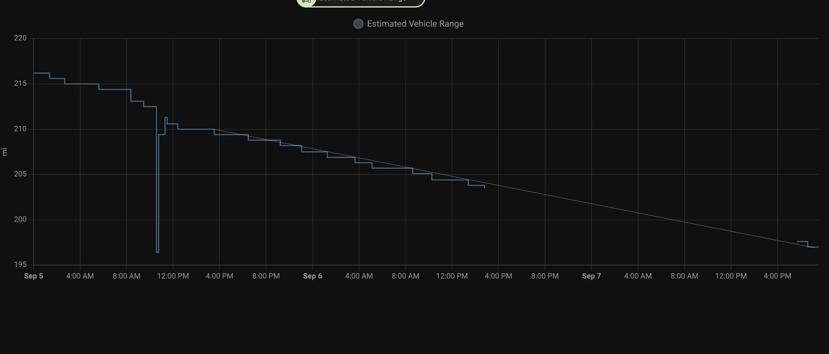

What else would you expect by constantly querying the truck?
I wouldn't expect that sleep pattern. It is too regular and it clearly is sleeping for a large proportion of the time it is being queried. I would expect to see no sleep at all, if regular querying had an effect on it.
What I'm instead seeing is periods of 20-40 minutes of sleep, then about 10 minutes "ready". In 2022.27, I saw the same pattern, but with longer periods of sleep (40-60 minutes) and much longer ready periods of 25-40 minutes.
Even stranger is the occasional "standby". No idea what this means compared to "ready" or "sleep", or why it sometimes happens 2-3 times a night, and other nights, not at all.

Hindley_Milner
Aug 11, 2022
56
Electric City
Can confirm now that this makes no appreciable difference. I turned off the polling during the empty section here, and drew a light white line over it. You can see the slope is largely unchanged.
This is something of a surprise! If nothing is querying the truck, why is it still keeping the computers online that could quickly answer such a query?
I doubt its querying the truck. The truck is probably metering to the cloud. You are querying the cloud.
I could be wrong.
Hindley_Milner
Aug 11, 2022
56
Electric City
I could be wrong.
With Teslas, they basically don't report to Tesla servers until there is a client requesting it, in which case the vehicle will wake up and answer the request. This is why reporting services like TeslaFi do a complicated dance to ensure they don't wake up the vehicle unnecessarily.
In contrast, I think your assertion is right. It could be that the truck is delivering metrics to Rivian, servers whether or any client is asking for them. It makes sense to do in the first few months of delivery to keep a close eye on the fleet, but - if true - it should be turned off by now to help with vampire drain.
