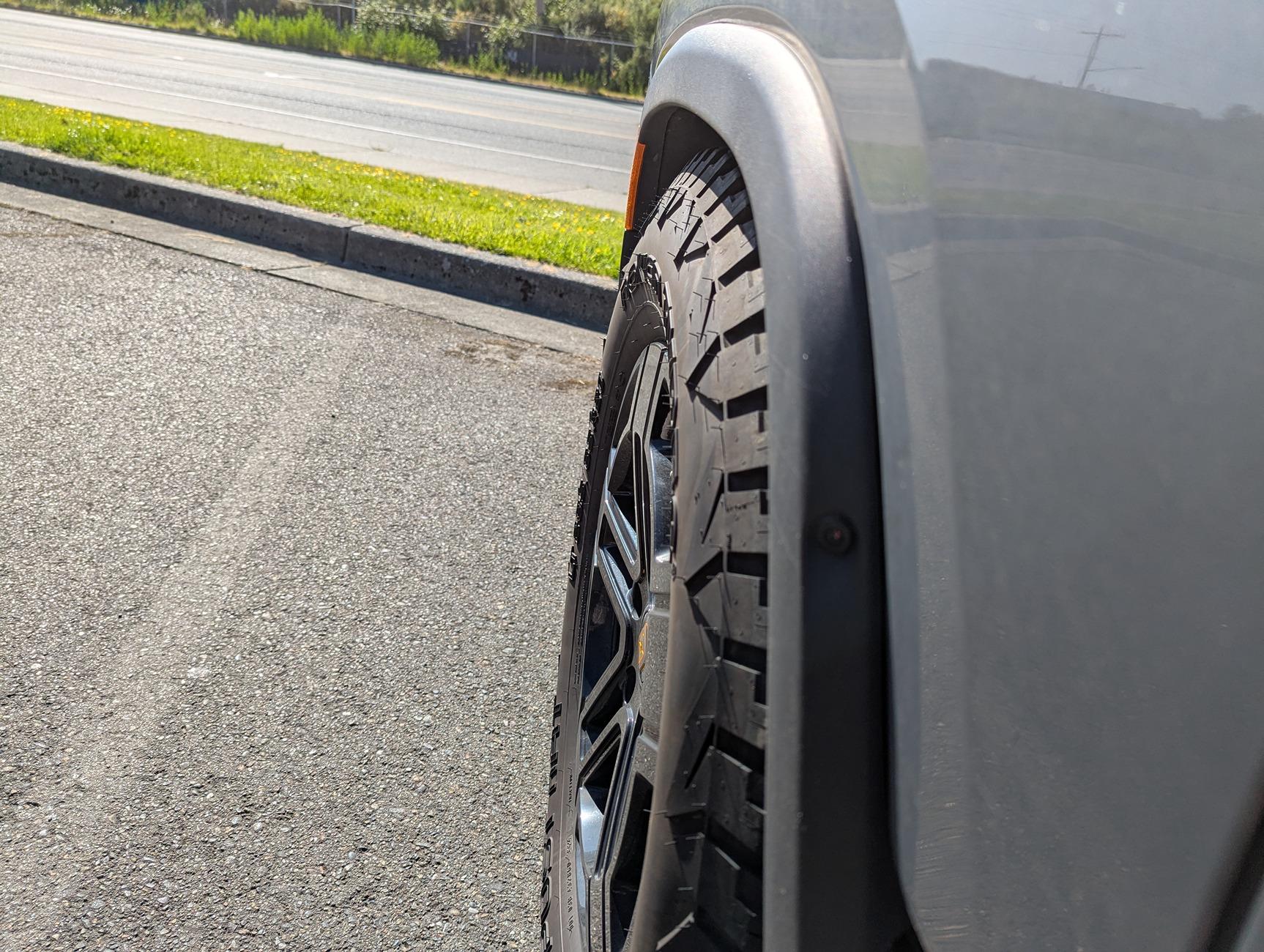

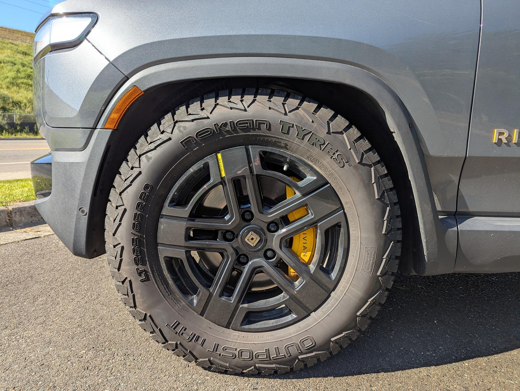

I think you could run 295/65r20 tires if you have the Mountain Pass Performance "LLL"s installed. I'm running 285/65r20 tires and have the LLLs installed. Pictures are at low suspension setting. The 295s are about a half inch taller and wider than what I have, but you could probably get 295s in there with the LLLs.
Rivian R1T R1S Anybody running 295/65/20 Tires? 1000005532
Rivian R1T R1S Anybody running 295/65/20 Tires? 1000005533
Rivian R1T R1S Anybody running 295/65/20 Tires? 1000005534

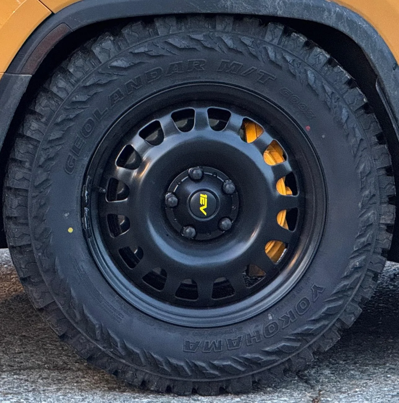

I’m running 35x11.5 - no suspension modifications; these are about the largest tire you can fit and still go into lowest without modifications. Now going around a corner with a bump in lowest is not a good idea with these tires**
Rivian R1T R1S Anybody running 295/65/20 Tires? IMG_1233
** results in this happening quite a bit
