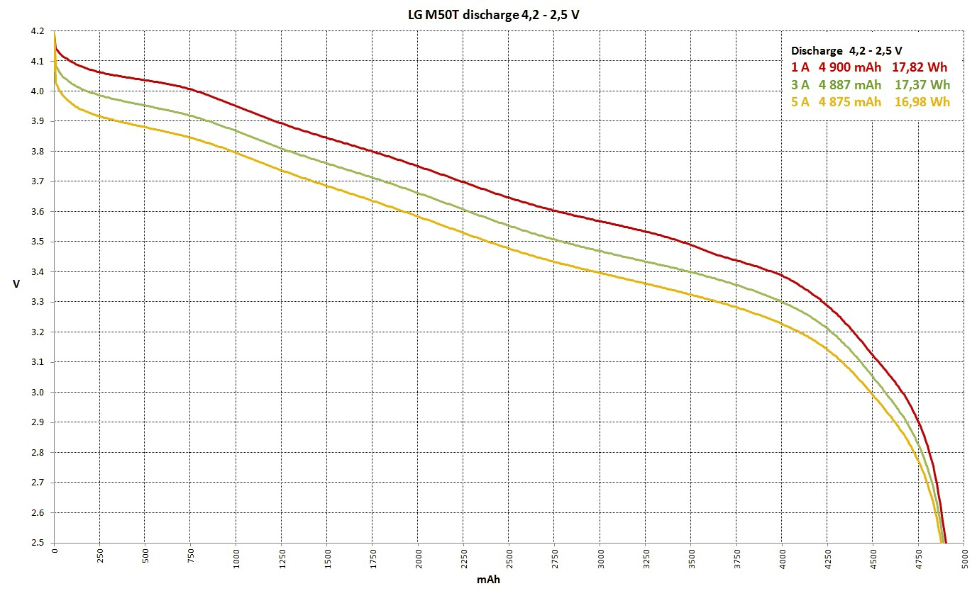

Here comes a bunch more engineering stuff which probably will be of no interest to most but at the end there are some practical recommendations derived from the engineering considerations. Skip the geek stuff if you like.
I'm putting the link to the entire spec in here as this table out of context is clearly misleading: https://www.dnkpower.com/wp-content/uploads/2019/02/LG-INR21700-M50-Datasheet.pdf though I must say that this spec is about as clear as the Seoul street numbering system.
The key thing to understand here is that all the energy you put into the battery is there largely independent of its temperature. Where would it go? The thing that changes with temperature is the cells' internal impedances and they change dramatically. The specs on this cell suggest they change by a factor of as much as 30 between room temperature and -10 °C. This means that if you want to get all the energy out when the battery is cold you must discharge the cell slowly in order to keep I^2R losses down. My earlier comment about how confusing this spec is starts with the fact that they never state the capacity of the battery! In discussing charging and discharging they reveal that 0.3C = 1.455 A from which we can, of course, calculate that C = 4.850 Ah. The data in the table pertain to a discharge rate of 0.2C = 0.99A - call it 1 A for simplicity. The stated DC impedance for this cell is 30 mΩ at 25 °C so that if discharged at 0.2C the I^2R loss is 30 mW and as the discharge time is clearly 5 hrs at 0.2C the energy lost to heat would be 0.150 Wh. The minimum energy capacity of this cell is stated as 17.6 Wh and the I^2R losses amount to 0.8% at 25 °C so that recovery at that temperature is 99.2% - not 100% as the chart states. Now turning attention to the -10°C entry the number is 70% preceded by a greater than or equal symbol. This means that the manufacturer is guaranteeing I^2R loss of at worst 30%. This is commensurate with an increase in cell internal impedance by a factor of about 40 due to ion mobility - not, I gather, an atypical number at low temperature. Thus the spec, if you consider all of it, does not present any surprises.
Now if one discharges at 0.1C instead of 0.2C the current is halved and the I^2R loss goes down by a factor of 4. Instead of losing, at worst, 30% of the available energy to heating one would expect to lose 7%.
PRACTICAL CONSIDERATIONS
Battery capacity doesn't decrease with temperature but access to it does. Is there anything we can do? Yes and the obvious thing to do is heat the battery. This, of course, takes energy. Clearly the goal is to conserve range and so, equally clearly, we want to depart on a cold weather journey with a warm battery if that is possible. Keeping the vehicle in a warm garage is one method. Arranging home charging to finish just before departure is another (uses the heat dissipated in the battery internal resistance during charging). These may not be possible in which case the heat must come either from the battery perhaps supplemented by a heat pump if the vehicle has one. The design should definitely capture waste heat from inverter/rectifiers and motors and route it back to the battery.
Bottom line is that if you set out with a cold battery you will have to give up range until it is warm. And, of course, it must be kept warm. Keeping it warm may deduct from range (too cold for heat pump).
Until the battery warms up, keep your foot off the skinny pedal to the extent possible. With a 100 kWh battery 0.2C is about 20 kW and 0.1C with 1/4 the energy loss to I^2R is 10 kW. Or you may choose to adopt the opposite approach and stomp it reasoning that the higher dissipation will warm the battery faster.
Summary: The battery doesn't contain any less energy at colder temperature but you will have to give up some range because some of that battery energy will have to go to warm the battery.
You used up a whole lot of word to confirm that range is lower when the battery is cold because it cannot supply as many Wh at lower temps (but it doesn't "go away" permanently).
There is a newer (2018) version of the cell/spec sheet than the one you referenced:

If you want some detailed independent testing data of a single cell:
https://endless-sphere.com/forums/viewtopic.php?t=101716
I'm not taking issue with that. Range is also lower because the cabin is cold. What I took issue with was:
Since the kWh rating of a pack is actually a variable that changes with temperature
Apparently there are no pack ratings any more but if there were one it would be the amount of energy extracted at some discharge rate at some temperature and therefore a constant not a variable. The kWh rating would be the kWh rating. How much of that you could expect to get would depend on how fast you discharged it (external impedance) and how hot/cold it was (internal impedance).
...because it cannot supply as many Wh at lower temps
It can supply just as many Wh cold as when hot but you must take them at a lower rate. The amount lost to higher rate goes as the square of the rate.
Not much help here as they took the DC internal impedance number out. But thanks for posting nonetheless. I downloaded it too.
For any given draw >0, there will be fewer Wh available. The lower the draw, the less the impact. Driving a 6,000 lb vehicle requires a draw well above 0 (on average, I understand if you are descending a grade with a tail wind, you may actually be charging the vehicle). The batteries will supply fewer Wh when cold - all other factors being equal.
