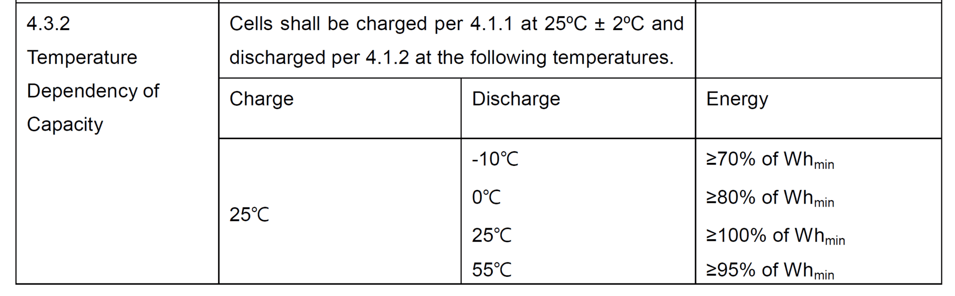

Since the kWh rating of a pack is actually a variable that changes with temperature and load,
Last week I would have agreed with that. This week I'm not so sure. I did some experiments with the lithium batteries used in hand drills. To my great surprise their open circuit voltages did not change as much as 10 mV between room temperature and soaking in the freezer for several hours (the packs have a thermister built in so you can measure their temperature with an ohm meter). Now these aren't the cells used in the Rivian or the Tesla so my single experiment can't be interpreted to mean that this is the case for all lithium ion chemistries but it is thought provoking. If true it implies that the stored energy is the same in a freezing battery as in a room temperature one and of course were that not the case we would have to ask where the deficit or surfeit energy went to or came from. Of course when the battery is cold the ion mobility will be low so some of that stored energy will be used to get those ions moving during discharge (thus warming the cell) and that energy won't be available for traction (or any other use). But once again First Law suggests that this will be the case. Now that's all over the map with nerdspeak but what it says is that kWh capacity isn't going to change that much with temperature, especially at models discharge rate.
DucRider
Gary
Oct 21, 2019
1,694
3,193
ORegon
Polestar 2, Ioniq, R1S
From LGs spec sheet on the 21700 likely used by Rivian:
Rivian R1T R1S Are you excited or dissapointed? 1605227278252
Even if this isn't the exact cell, it is likely that there will be at least a similar degree of temperature dependency.
