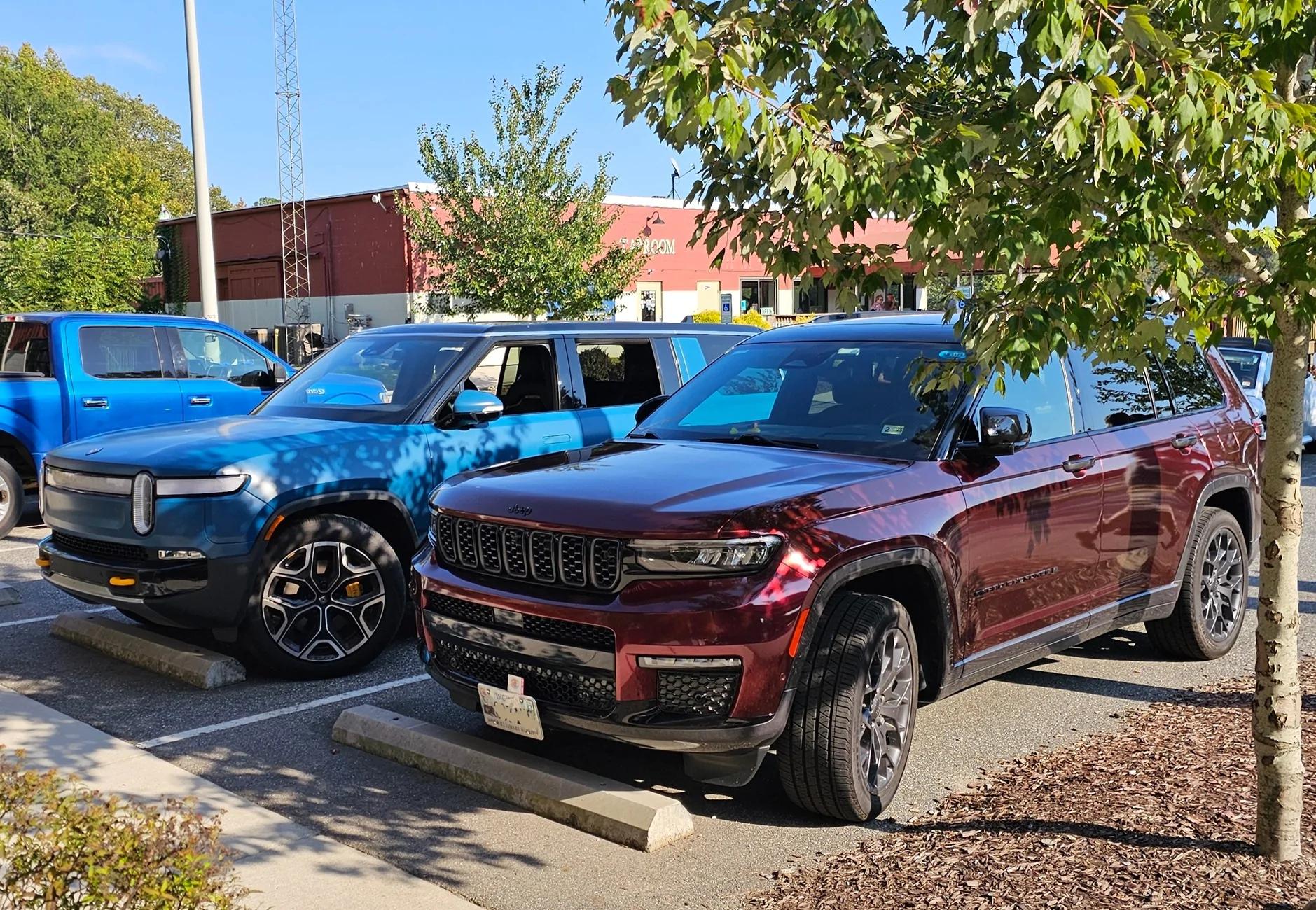

More pix of final product? What color/PPF is that? Color looks awesome.
Yes, I did.

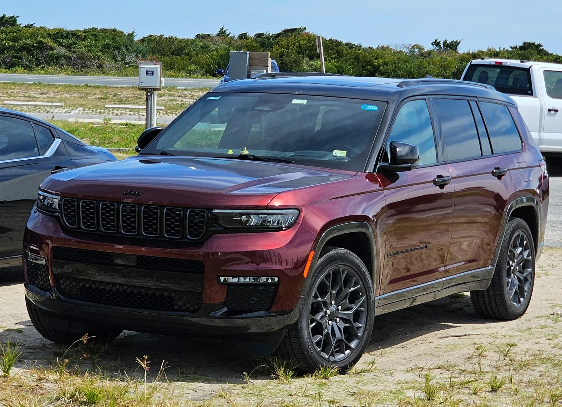

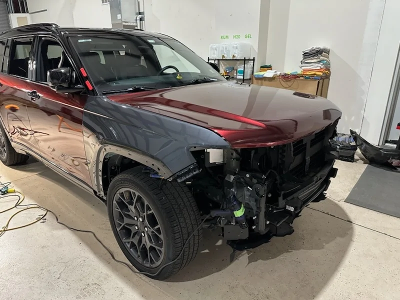

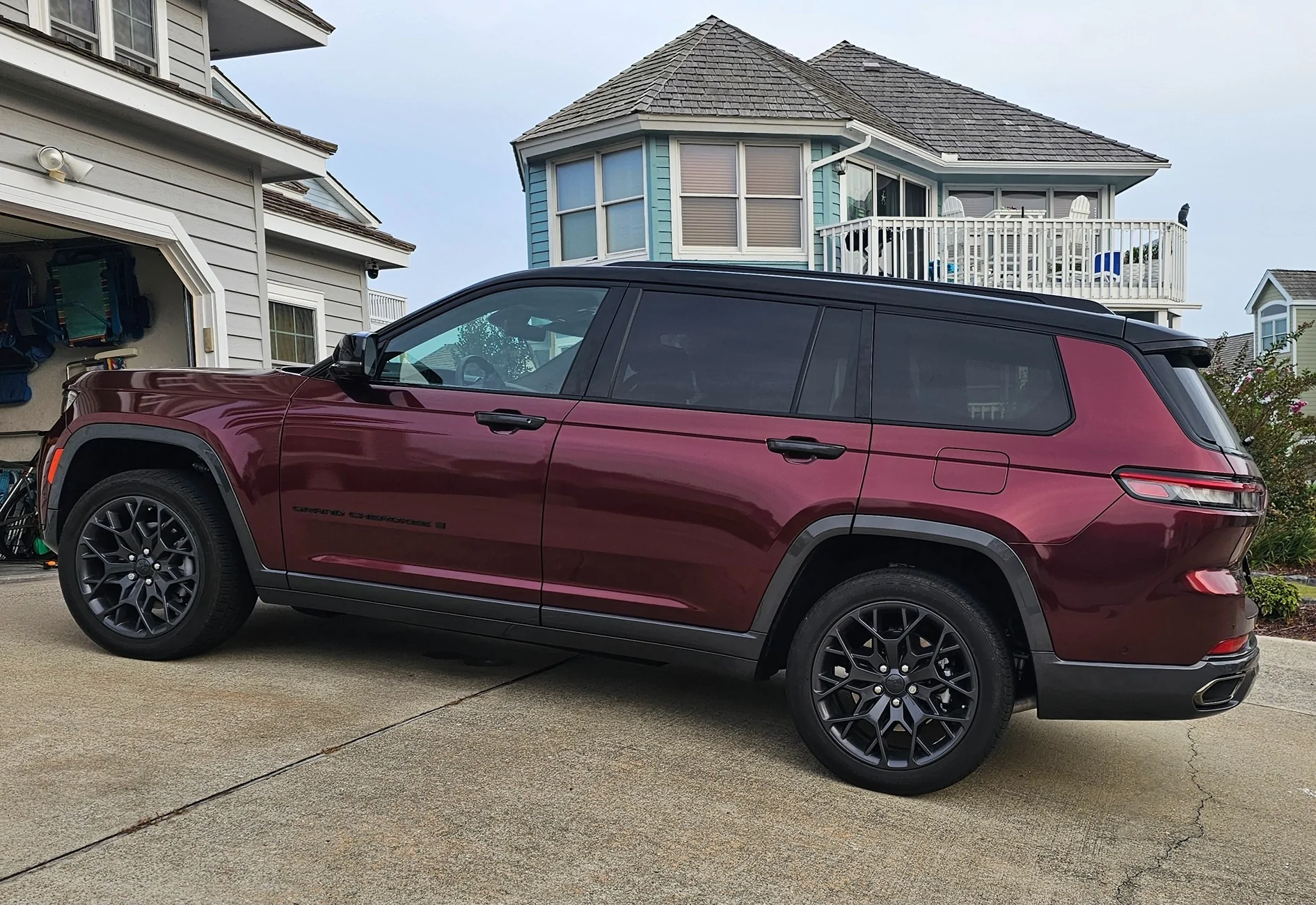

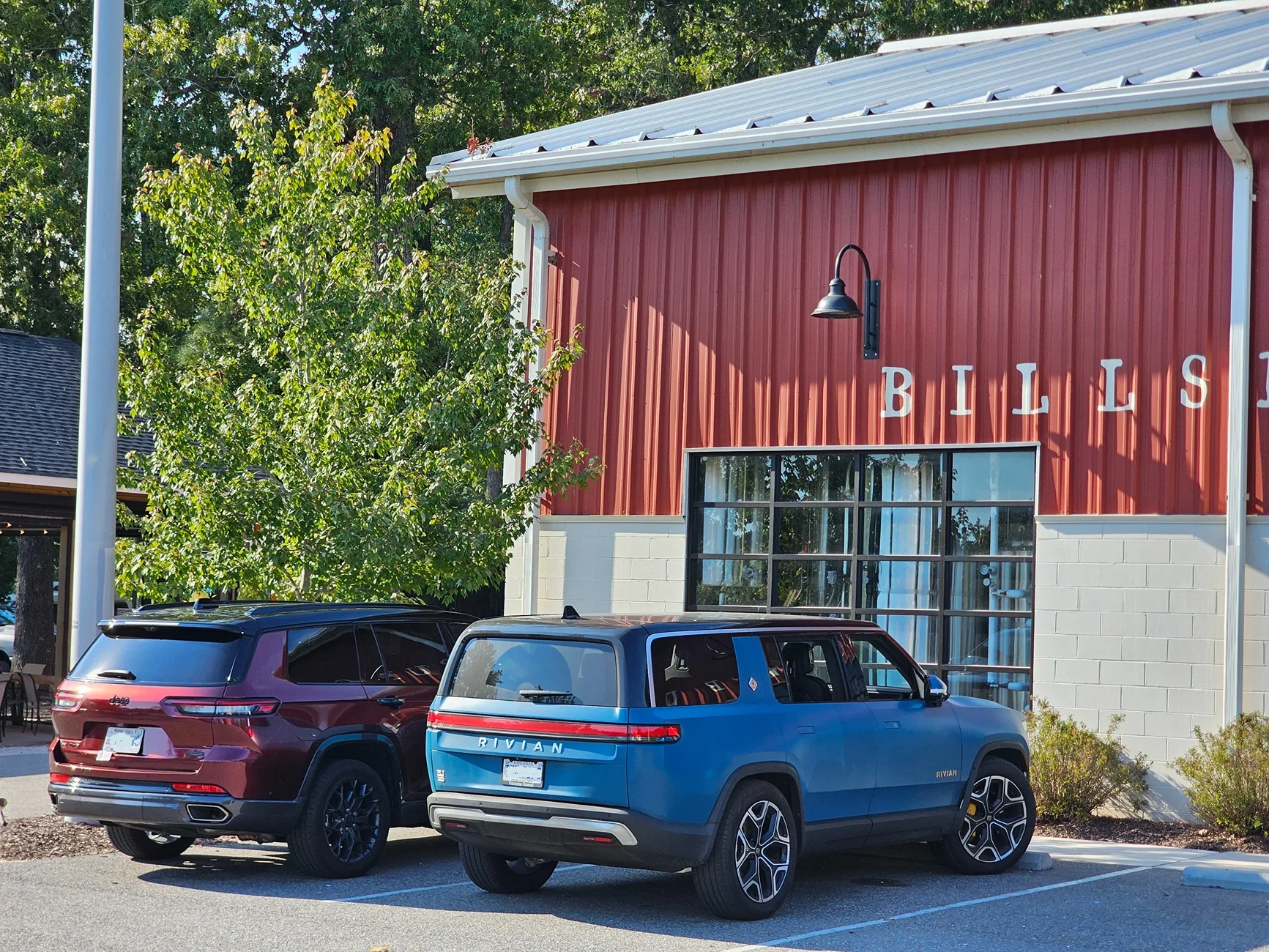

My wife's Jeep Grand Cherokee is wrapped. It is the first vehicle I have ever had wrapped and I didn't understand the consequences until after it was done. It looks beautiful, but it must be hand washed. I did the same research you did, AFTER I got it wrapped. And I got the same results you did.
After about a year of washing it by hand (or just neglecting it) I got fed up and ran it through a car wash. It didn't cause any peeling probably because the wrap guy did such a good job wrapping around the edges. He disassembled much of the body to get it wrapped properly.
After the automated wash it looked good but when looking carefully I could see tiny scratches on the surface in some areas. After a few washes I imagine those tiny scratches accumulate and make the finish look dull.
So I have not run it through again. But I did just get it detailed and he buffed the surface, removing all of the tiny scratches. It looks new again. Going forward I plan to have it detailed yearly.
Coincidentally I just discovered a local car wash has a touchless option on the screen, which I am definitely going to test out in the near future. If that works, it will be what I do in between yearly details. Otherwise, I am just going to bite the bullet and wash it by hand. Grrr.
It would be better if PPF, but it is standard vinyl.
Rivian R1T R1S Auto car wash with wraps? 1000001797
We have received a lot of compliments regarding the color. It is very similar to a color found on a stock GC. The difference is we didn't wrap all the gray parts. We left the top black, and the bumpers original gray. I think it looks a lot better with the contrasting gray and dark red.
Rivian R1T R1S Auto car wash with wraps? 1000001809
Rivian R1T R1S Auto car wash with wraps? 1000001811
Rivian R1T R1S Auto car wash with wraps? 1000001805
Rivian R1T R1S Auto car wash with wraps? 1000001803
