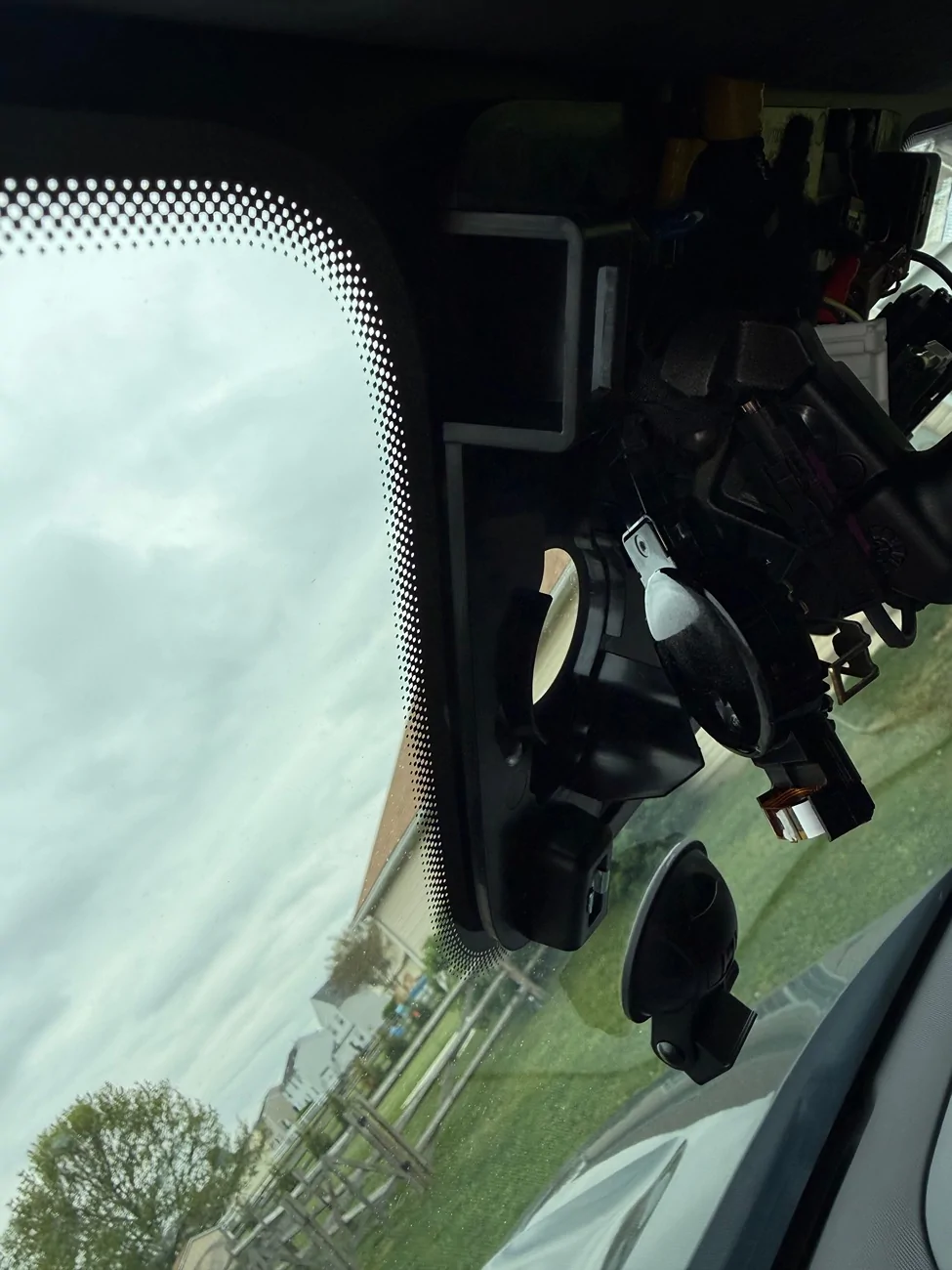

They don't work on our new 2026 R1S. Going in fro service tomorrow. But I can clearly see that the sensor became detached from the windshield so it should be an easy fix.
I'm going in for it to be replaced again!

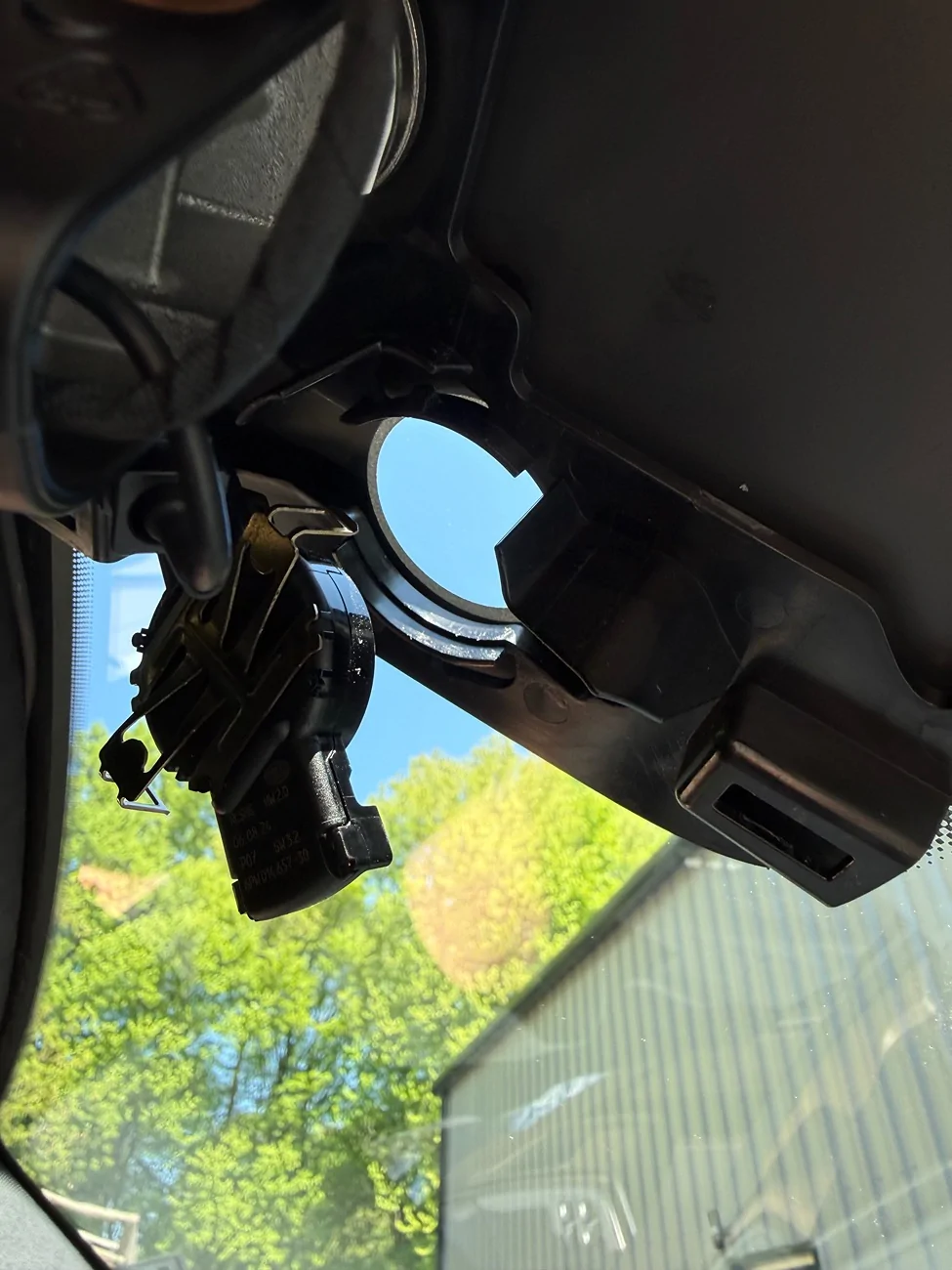

So the root cause for my issue was the sticky glue tabs that hold the bracket that contains the cameras and the sensors had failed on the left side. The retaining tab for the auto wipers also wasn’t clipped on for the inboard side. Some kind of manufacturing defect I got blamed for. With some 3M epoxy and time it’s glued back up there. No issues since.
