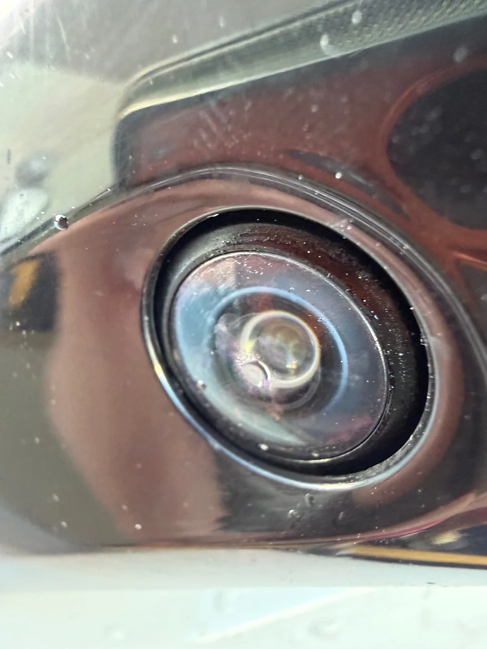

My R1S is in the shop now for this issue. It appeared 2 months ago and after finding this thread a month ago and saw mention of water, I could clearly see a drop of water sitting in the lens. I assume it occurred after getting a carwash, but not positive. They are replacing the camera module, but unsure if it’s a revised part and will still have water ingress in the future.

Fixing this camera requires replacing the entire mirror which is kinda crazy to me. I had to have this done a few months ago (and now the left mirror has a meeeaaaannn whistle above 50mph).
The problem was water ingress.

Aside from the wing camera issue, I’m also having a door rattle be addressed (for the 3rd time?) and during the ride-along with the tech to reproduce the noise, I asked how long he thinks it will take to get the camera fixed and he said replacing the camera/mirror is fast, it’s the calibration that’s time consuming. Makes sense, but also makes me nervous when my R1S is out of warranty and I can’t just get another wing camera off eBay and call it good - will still need to pay for a calibration.
