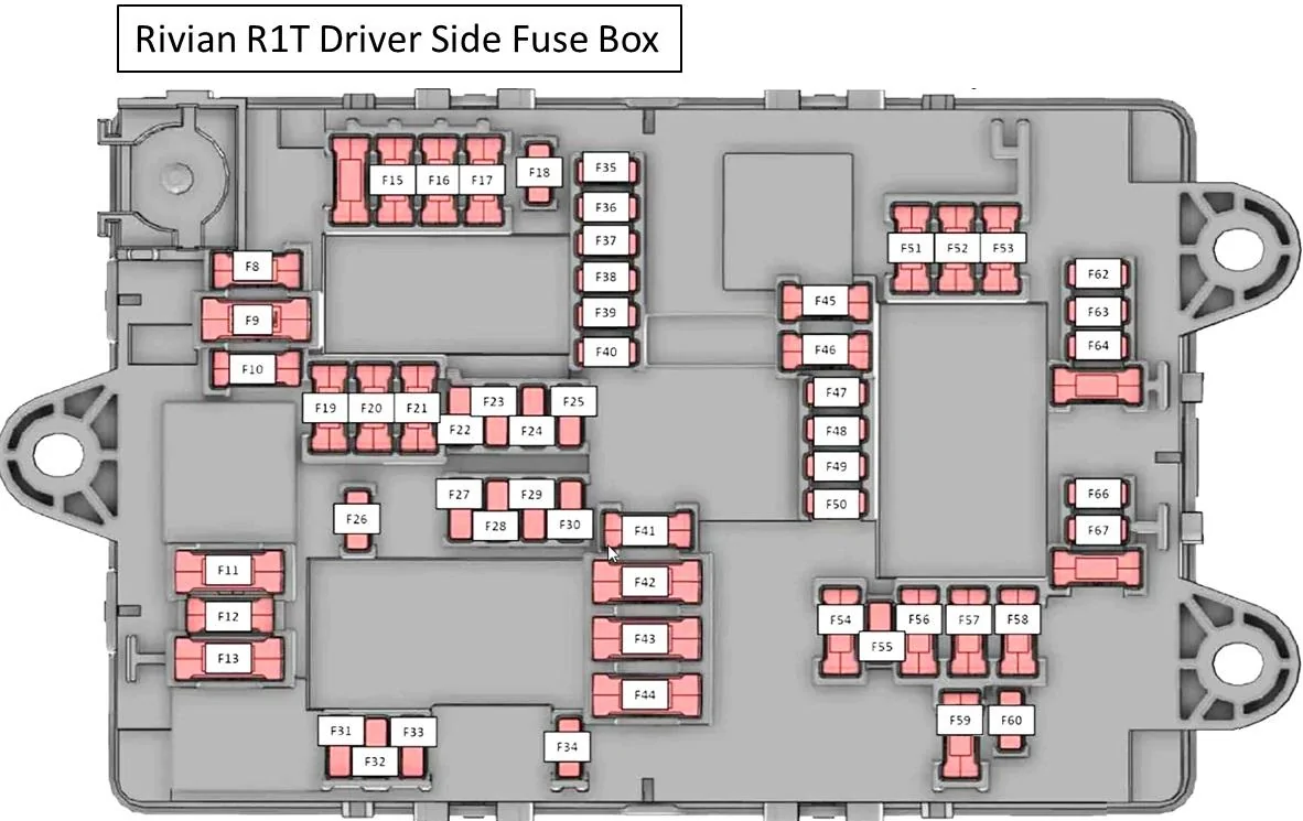

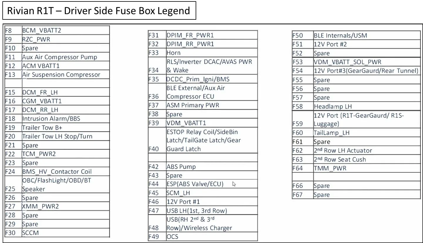

Rivian R1T R1S Back up light fuse location Rivian R1T Driver Side Fuse Box Legend

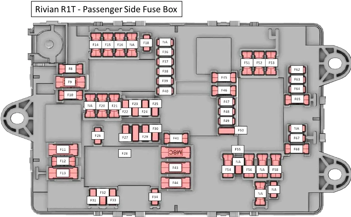

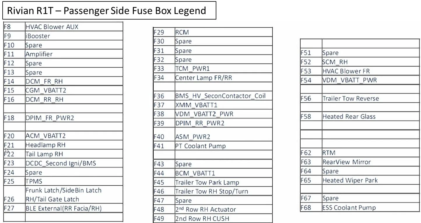

Rivian R1T R1S Back up light fuse location Rivian R1T Passenger Side Fuse Box Legend
