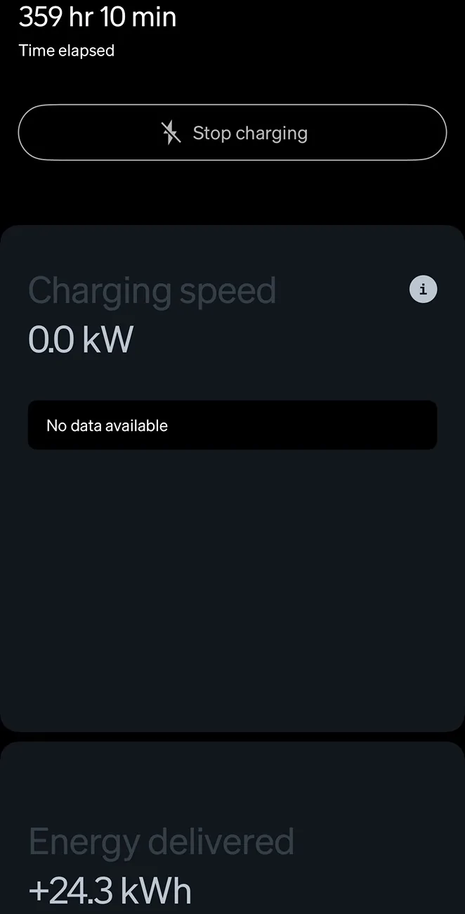

I was out of town for 2 weeks over Thanksgiving. My Gen 1 R1T and R1S were parked and plugged in side by side in my carport in Phoenix (mild weather this time of year) and SOC set to 70%.
Energy usage was identical in the cars @ 1.62 kWh added per day to maintain the charge level. That’s a pretty reasonable estimate of the vampire drain while plugged in.
1.62 kWh/131 kWh usable (although this has to be somewhat less now given the vehicles’s ages) = approximately 1.23% loss per day.
I wish this were better. Between both cars I needed 48.6 kWH to maintain the charge levels while sitting idle for 2 weeks. That’s stupid and wasteful but I don’t believe it’s going to get much better at this point with the gen 1 architecture.
