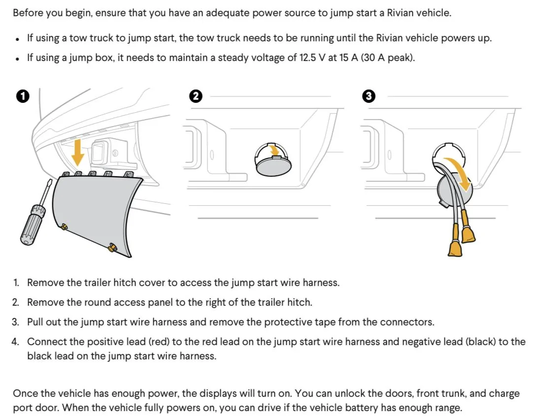

I am curious. How do you jump start a EV?
I'm not sure you do but it may be possible in some cases. What people are talking about here is getting enough charge into the 12 v batteries (and I note with great interest the use of the plural in the manual) that it can operate the computers and contactor(s) which connect the high voltage battery to the car. If there is enough juice left in the high voltage battery to operate the car you should be able to go at least a few miles. While Tesla has always warned against it and Rivian has recently reversed it position on this to agree with Tesla, the vehicles can be charged by towing. Rolling down a long enough hill would also get you a couple of miles without incurring the displeasure of the manufacturers.
If it's me, I'm using my first year of free membership to call Rivian to the rescue. And unless it is a ridiculous monthly price I'll probably continue it.
