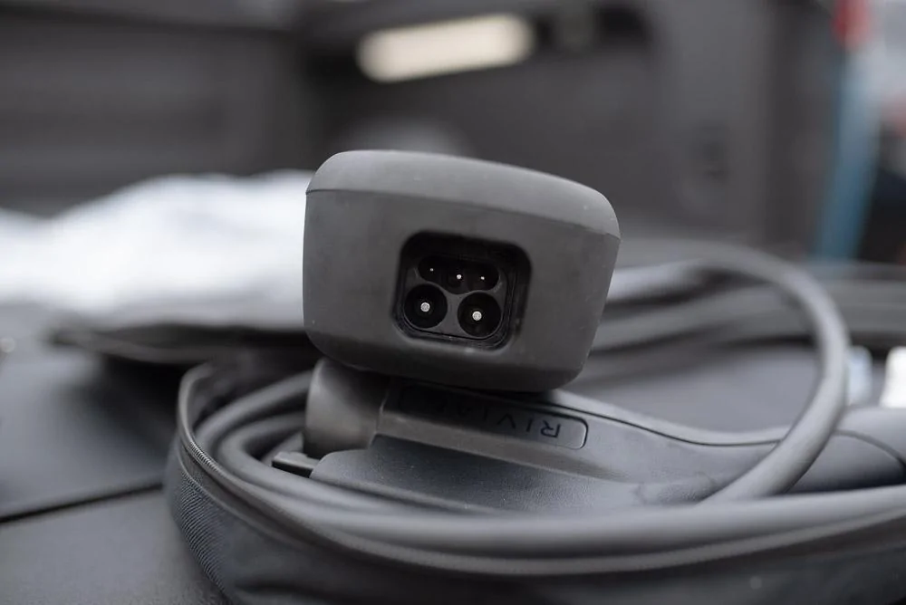

Oh, it wasn't in this thread. I shared these close up photos elsewhere...
There are extra pins on the pig tails. I'll let one of the paid influences tear theirs down, but I would absolutely bet that the pigtails have identifying circuitry in them.
Thanks - and yes that is encouraging! It does seem very likely that one of the extra pins is used to identify amperage.
If that is the case, I bet that even if Rivian doesn't sell other pigtails someone else will. Just like there are 3rd party pigtails for Tesla's mobile charger.

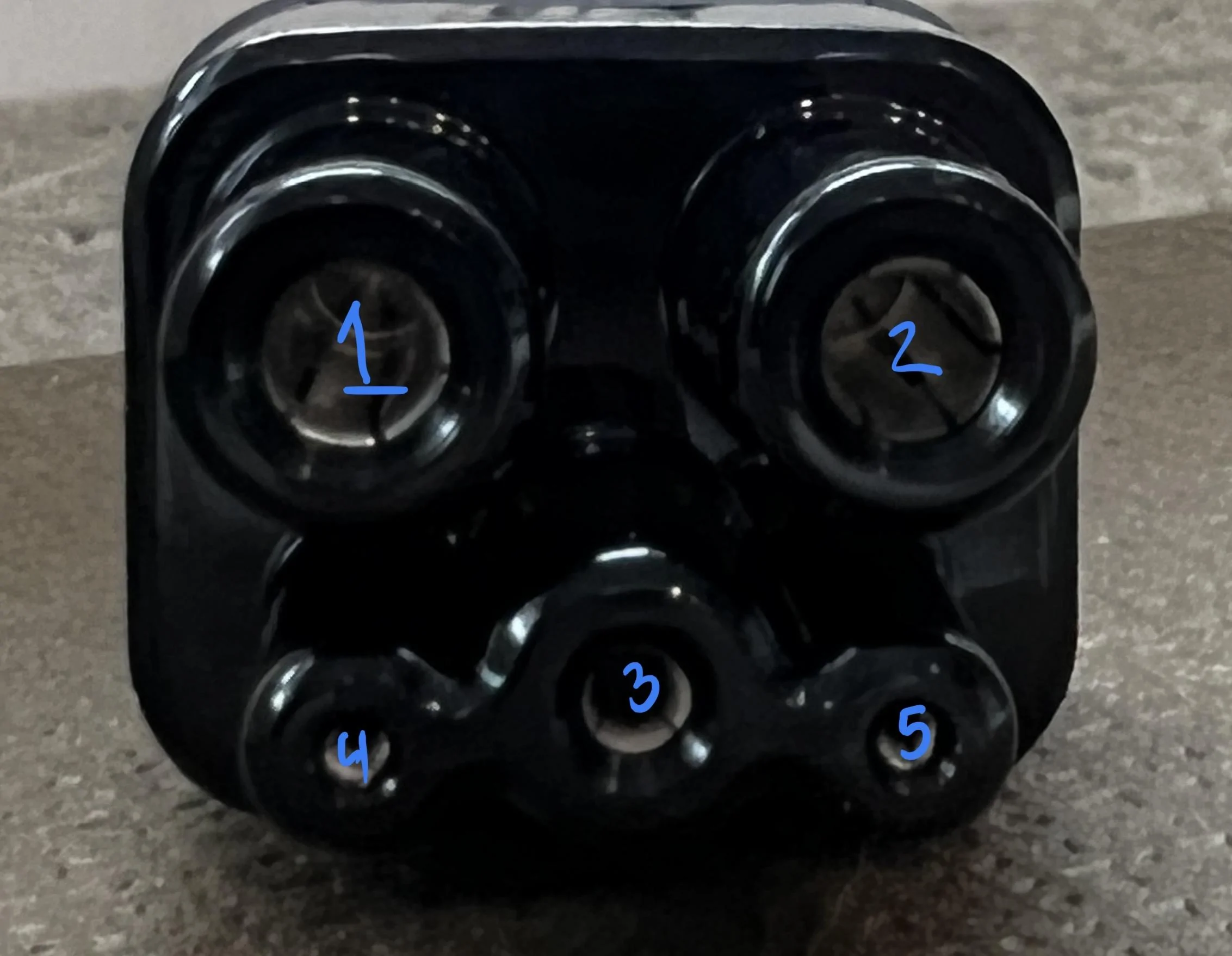

I'm locked out of the frunk while I'm waiting for the software update to complete, but I'll measure the resistances across the pigtail pins later and report back if I find anything noteworthy.

Keep in mind that 4 are used for 220v, so only 1 extra.
The pigtail may well drop the neutral when using the 240v plug since it shouldn't be needed. That'll be an easy test with the multimeter...

Some initial findings:
Rivian R1T R1S Beginners' guide to EV charging? IMG_8503
  • Pin 1 is always hot.
  • Pin 2 is hot for 240V, neutral for 120V.
  • Neutral is dropped for 240V dongle.
  • Pin 3 is always equipment grounding conductor
  • Pins 4 and 5 have a resistance across them. My multimeter probes are too big to make good contact, and I was only able to find something too small to make a good connection. I'll try to find something just right to stick in there and report the ohms. I'm kind of expecting them to match the Level 2 control resistances -- in which case custom dongles might be totally reasonable.
