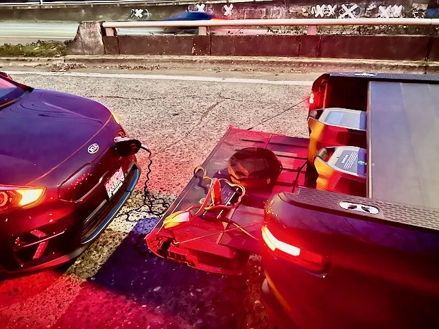

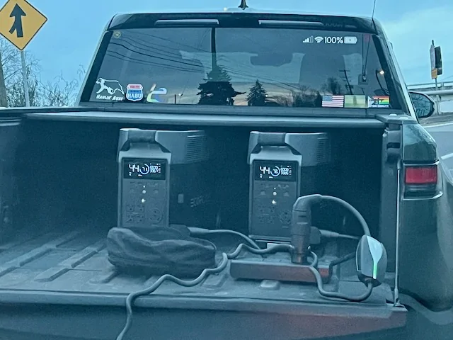

I have rescue-charged other EVs using my dual EcoFlow + 240V combiner before. Note that most of these portable batteries have a "floating ground" or no ground connected at all; and nearly all portable EVSEs insist on a proper ground. My Tesla Gen 1 Mobile Cord is the only one that works with this setup without neutral and ground bonded. And my Rivian mobile cord doesn't work even *WITH* a neutral-ground bonding plug. (The official one by EcoFlow or a cheap third party one that EcoFlow recommends against.)

The big EcoFlow Delta units pictured do have neutral and ground conductors in the sockets - because both operate in "grid-tied" mode when you plug them into grid power - fully passing through grid power to all three leads in the NEMA 5-15 and TT-30 sockets.
And they have a ground bonding adapter that when operating a single unit in 120V mode you plug in to one of the 120V 15A sockets on the front, and it also connects to a data port on the unit, so the unit can control when to bond neutral to ground. (The bonding adapter has an RJ-45 on one end for the data connection, and a standard IEC C14 socket on the other - you use the same power cable you'd connect the unit to the wall to charge it.)
When using the 240V combiner as pictured, that 240V combiner has two NEMA 6-20 sockets (three-pole: hot1, hot2, ground) and one L14-30 socket (locking four-pole: hot1, hot2, neutral, ground.)
In my picture, I'm using an L14-30-to-14-50 adapter to connect the Tesla Mobile Cord at 240V.
The official EcoFlow recommendation for using the bonding adapter with the 240V combiner is to connect it to one of the two NEMA 6-20 sockets using a NEMA 6-20 to IEC C14 cord. I don't know how it then combines neutral to ground, since the 6-20 socket doesn't have neutral - it must pass it through the "data" connector. (In fact, when connecting anything to the plug you connect the 240V combiner to, it disables the units' onboard 120V sockets.)
With the 240V combiner, you can draw 120V off either hot lead on the L14-30 socket plus neutral.
