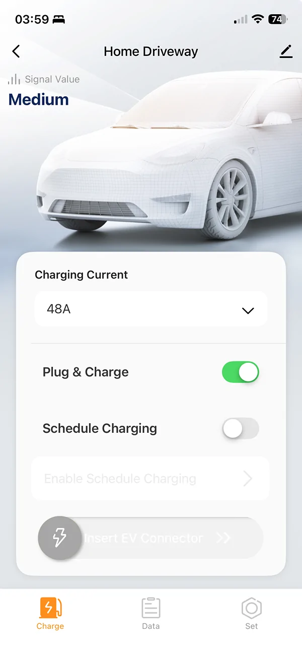

the WOLFBOX charger allows you to activate from the app or RFID cards that come with it. You can even setup profiles for different cars to track how much electricity you’ve delivered in each car. But that’s driven by the app or and rfid card if you want to use that feature.
I leave mine unlocked with Plug and Charge turned on by default. Nobody I don’t know is parking in my driveway.
My daughter drives a Bolt and I have the Riv - and we share this charger.
