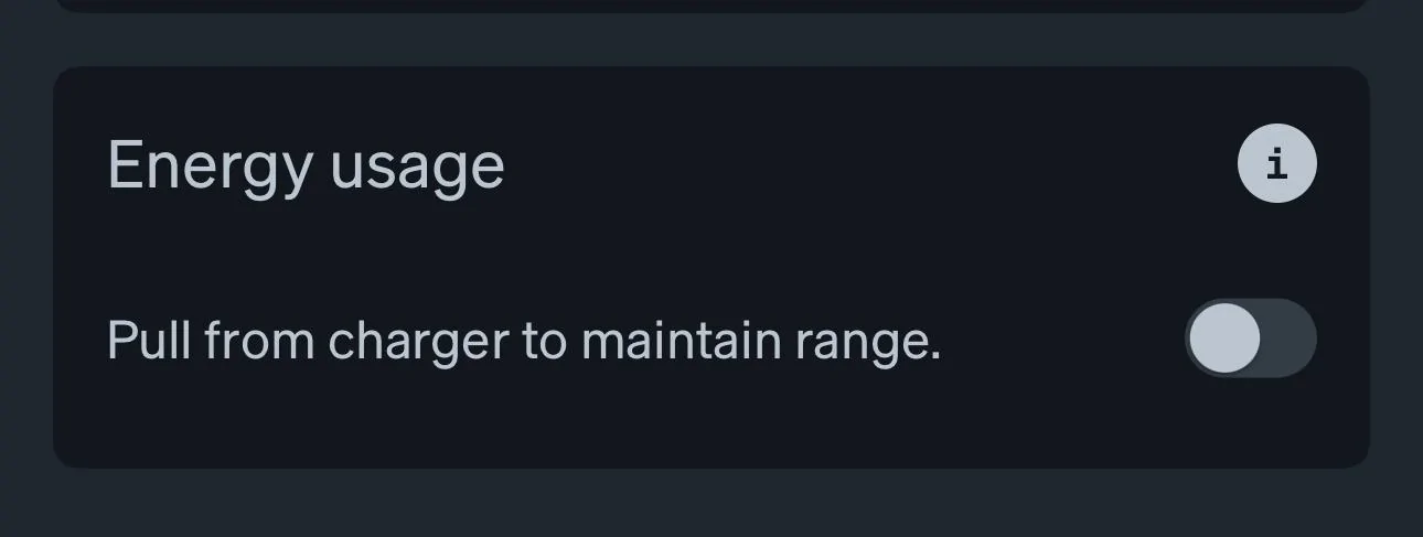

Yes, when you set up a new scheduled preconditioning time, there is a toggle at the bottom of the configuration page:
Not seeing this menu. Is this on the phone app or in the vehicle? Gen 1 or Gen 2? Or both?
For the Gen 1 within the mobile app its under climate at the bottom, click schedule and when you configure a schedule this option appears at the bottom.

Unfortunately not available in Gen 2. Reportedly coming in a future update.
This. If there’s one thing I’m annoyed by it’s this. I got the Gen2 expecting the widest set of tech features, including this that my Tesla does very well. But this is weirdly not available despite Gen2 being out for several months now. Living in Maine, and actually having a cold winter this year, I really need this feature turned on asap Rivian. Please?
