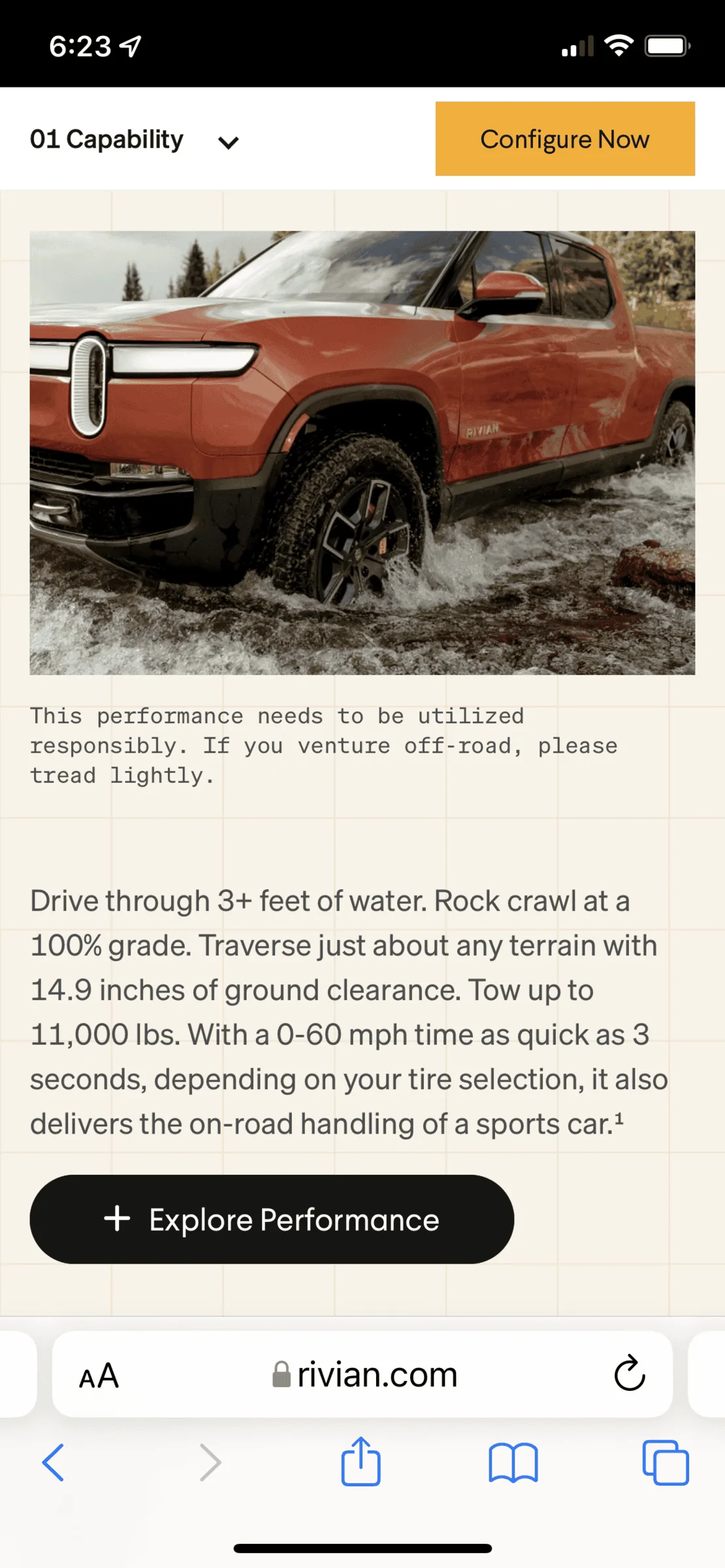

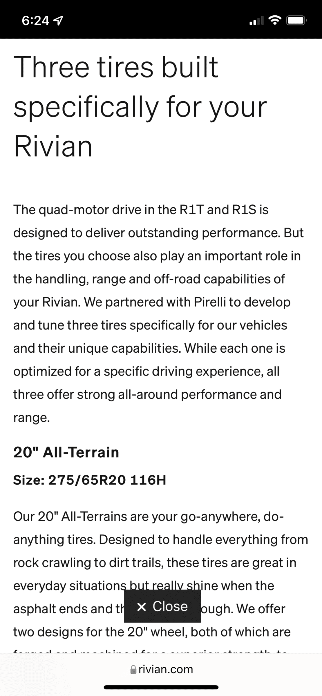

@DuckTruck : The only place I’ve seen Rivian note the tire load index is on their site, Capabilities, then explore Performance. The 20” & 21” are both a 116H XL and the 22” is a 115H XL. These tires look to be stronger than say an run of the mill 111H but much lighter in weight than a 126H.
BigE,
I'm with you all the way on that. The Pirelli's are nice, sturdy tires, and I certainly understand why they would need to be, given the capabilities of these vehicles. The GVWR certainly drives need, as does the performance and the off-roading mission. I'm hoping to hear soon what the lowest acceptable Load Index is for us when specing out new tires, just so we can consider all of our safe options.
Thanks!
