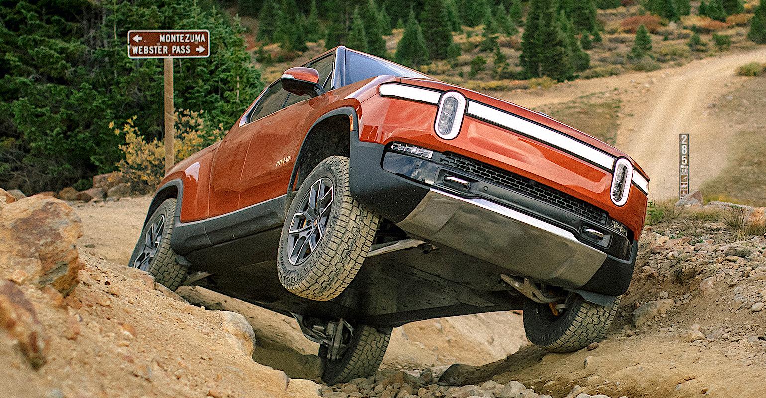

I’ve done this procedure many times and as recently as last week on my work pickup (ram 3500) on some logging roads…. Nosed off the logging road at an angle and floated the rear tire iHaven’t done it on a Rivian yet but I never use a jack offroad…. I find an off camber style spot that when driving through lifts tires off the ground. Drive into it and get the tire that needs changing floating freely in the air and then change the tire. Milwaukee battery impact speeds up the process
pull your Rivian into something like this…. Much easier than messing with a jack. But if you are in relatively flat terrain with not much of any off camber you may need to jack It up.
these pics, not mine but you can easily see how easy it is to lift a wheel and would be easy to change.
I like it! No jack required. I'll definitely keep this technique in mind, and it should be much easier with a full IFS vehicle like the R1T!
