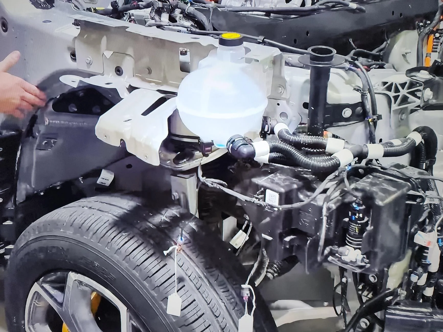

Update 1/22/25 - Still no response from ATL on the ticket, still waiting on a review. I pulled the plastic back and peeked up inside the wheel well, it appears it may be associated with the reservoir in the below image. What is this holding? It is not washer fluid, my fluid is orange...this is not.

That looks more blue than the teal droplet you showed. So it would point to coolant for motors and HV pack. If you have a ticket, from the mobile app, you can call SC and try to escalate. Meanwhile, if you do drive it, keep an eye on pack and motor temps in gauge view.

For reference, here is an image from the Munro tear down showing that area of the front end...looks like one source of fluid around the wheel well, besides the washer fluid fill port.
BMS related?
Rivian R1T R1S ? Blue fluid from front wheel well 20250122_190227

Also found this, relating to another owner on the forum with a similar leak...
The mobile tech saw the leak under the coolant pump when he removed one of the underbody plastic panels to perform the accelerator recall service. He showed me where the coolant tank is, which is under the top plastic trim panel along the top of the fender, rear of the washer fluid tank. He checked the level of the coolant and it was still plenty full and that the leak was minor and OK to drive for now until service appt. in a week.
