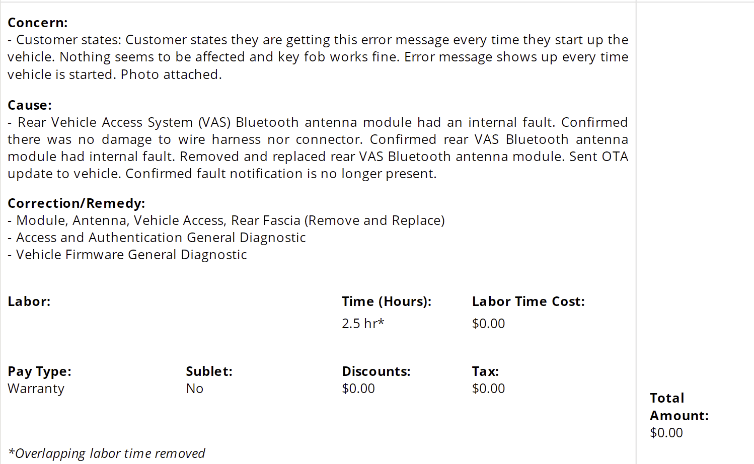

Not sure about @EveryAmp but my fix was a replacement of the bluetooth sensors at the rear of the vehicle. The service center determined that was the issue, so they replaced them and I have not had the issue since.

@EveryAmp: It's been 3 1/2 months since your original post - can you give us an update? Is it fixed for you now, and what did the problem turn out to be?
Thanks for the reminder! Yes got it all sorted out at the service center. The Bluetooth antenna module had an internal fault. They had the part ready and was a quick fix at the San Jose Service Center.
Here's the work order too:

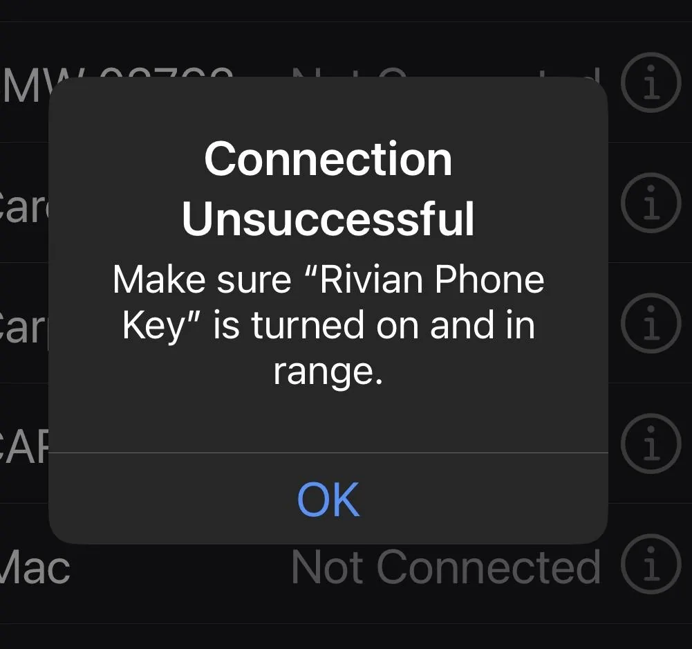

Thanks for the update @EveryAmp and @Ladiver . My R1S is currently at a SC for a similar issue/repair which started around the time of a successful vehicle software update (24.07.02). None of my key cards or key fobs work via Bluetooth, even when held at the door handle for 8 seconds.
The Bluetooth connectivity error also affected the onboard air compressor in the rear cargo region. The SC stated that it was a known issue and verified the blown door handle fuse by noting the onboard air compressor was also affected (inoperable). Both are on the same circuit. I am currently waiting for my door handle replacement.
I had an additional issue that affected my phone's ability to connect via Bluetooth. I was told this was a separate issue that may be related to a bug in the latest software. Various attempts at the SC failed to correct this issue.

Did they give you any more info on your phone not being able to connect and correlation to the latest update?
Fairly certain I'm experiencing this issue. After the 2024.11.2 update my phone app stopped being able to manage the truck features or unlock through the app, but would show correct status info.
In troubleshooting I removed my PaaK to re-add it but it just times out during the actual bluetooth connection/prompt step. Never had this issue before when having to re-pair my PaaK....
