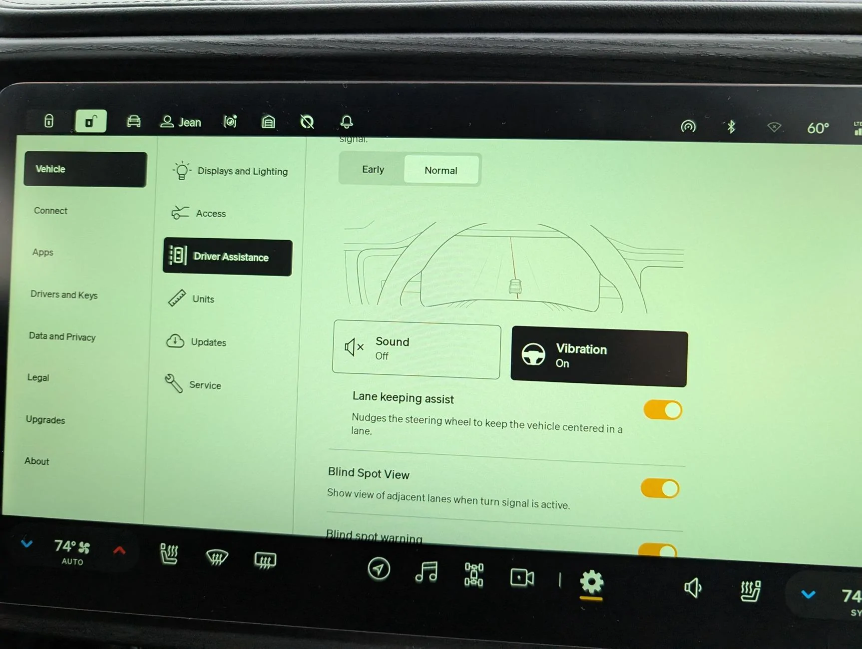

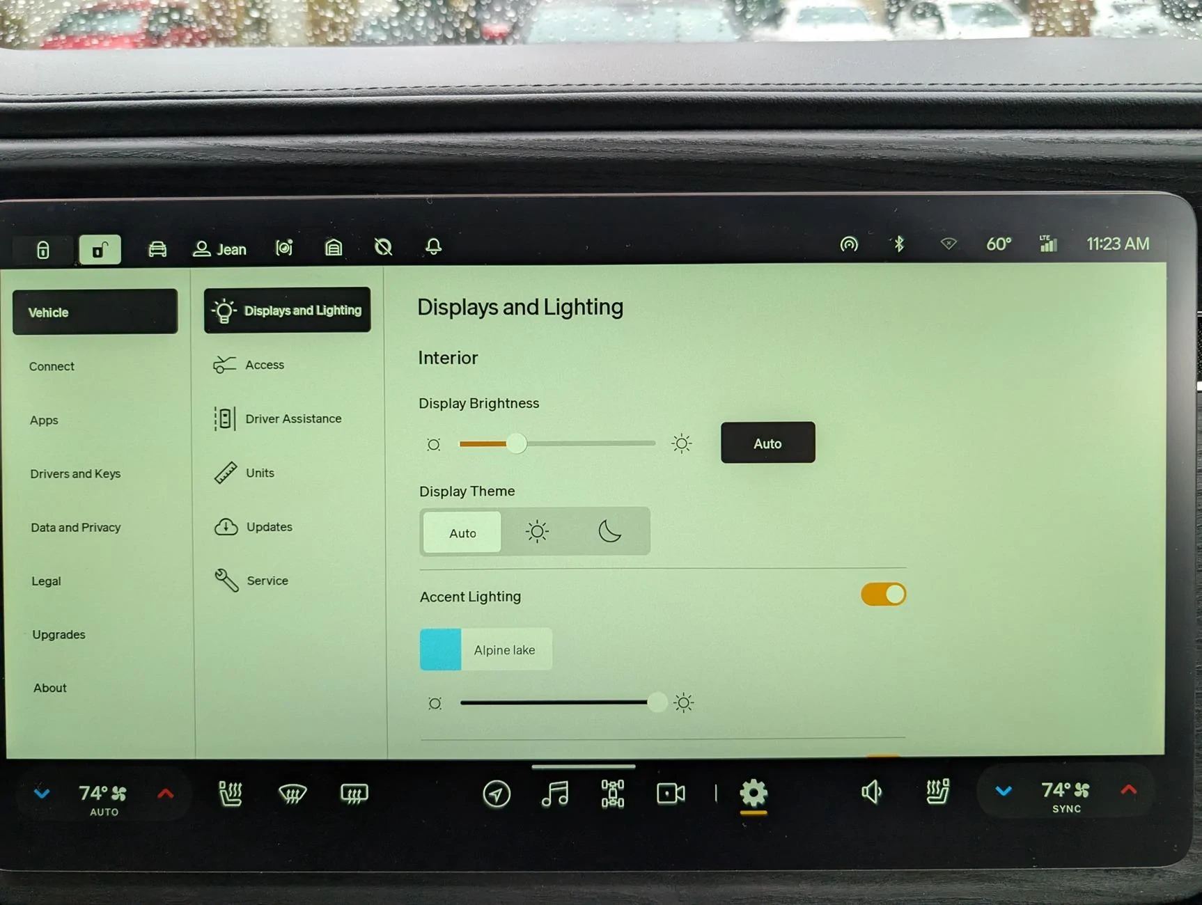

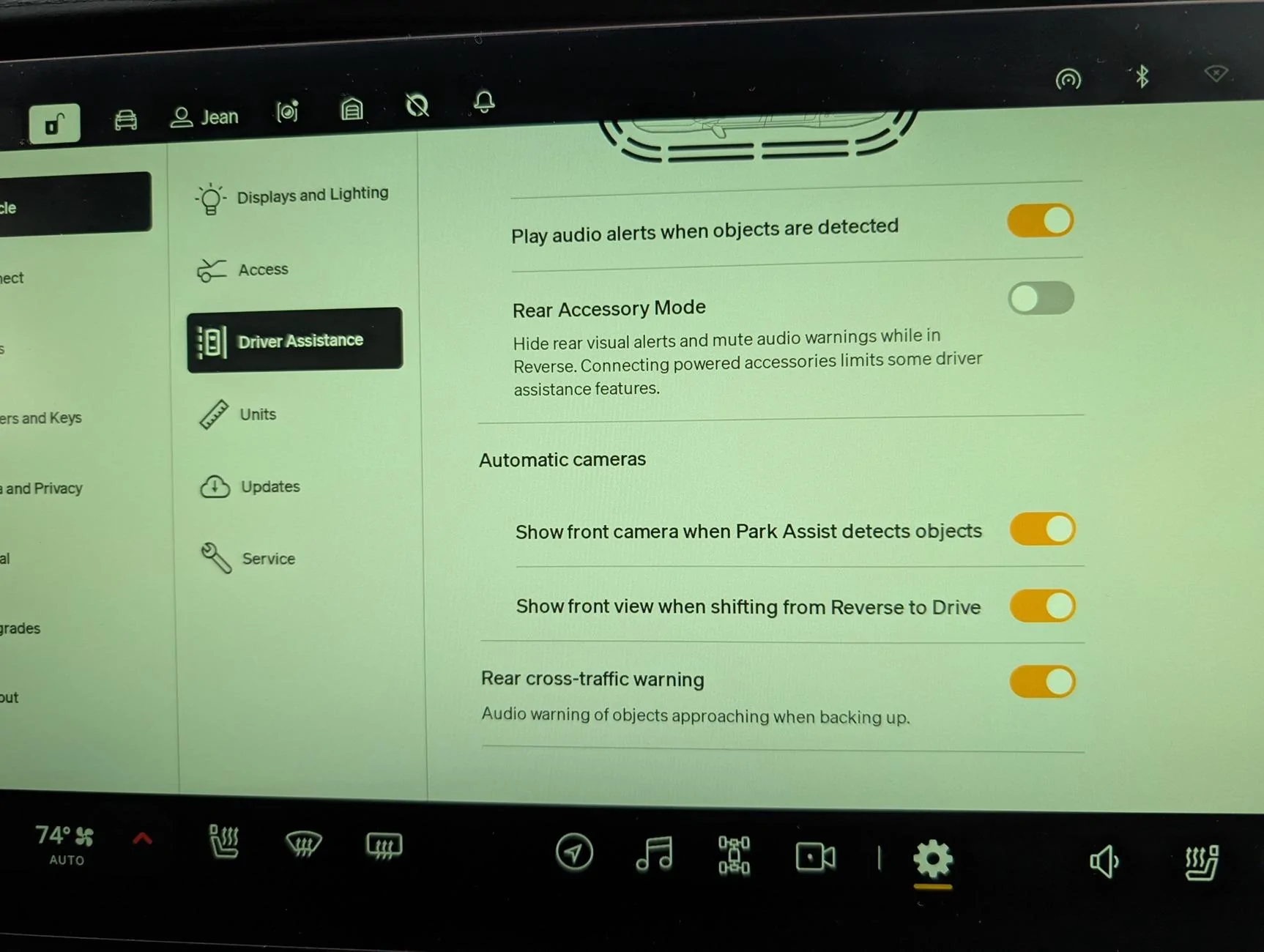

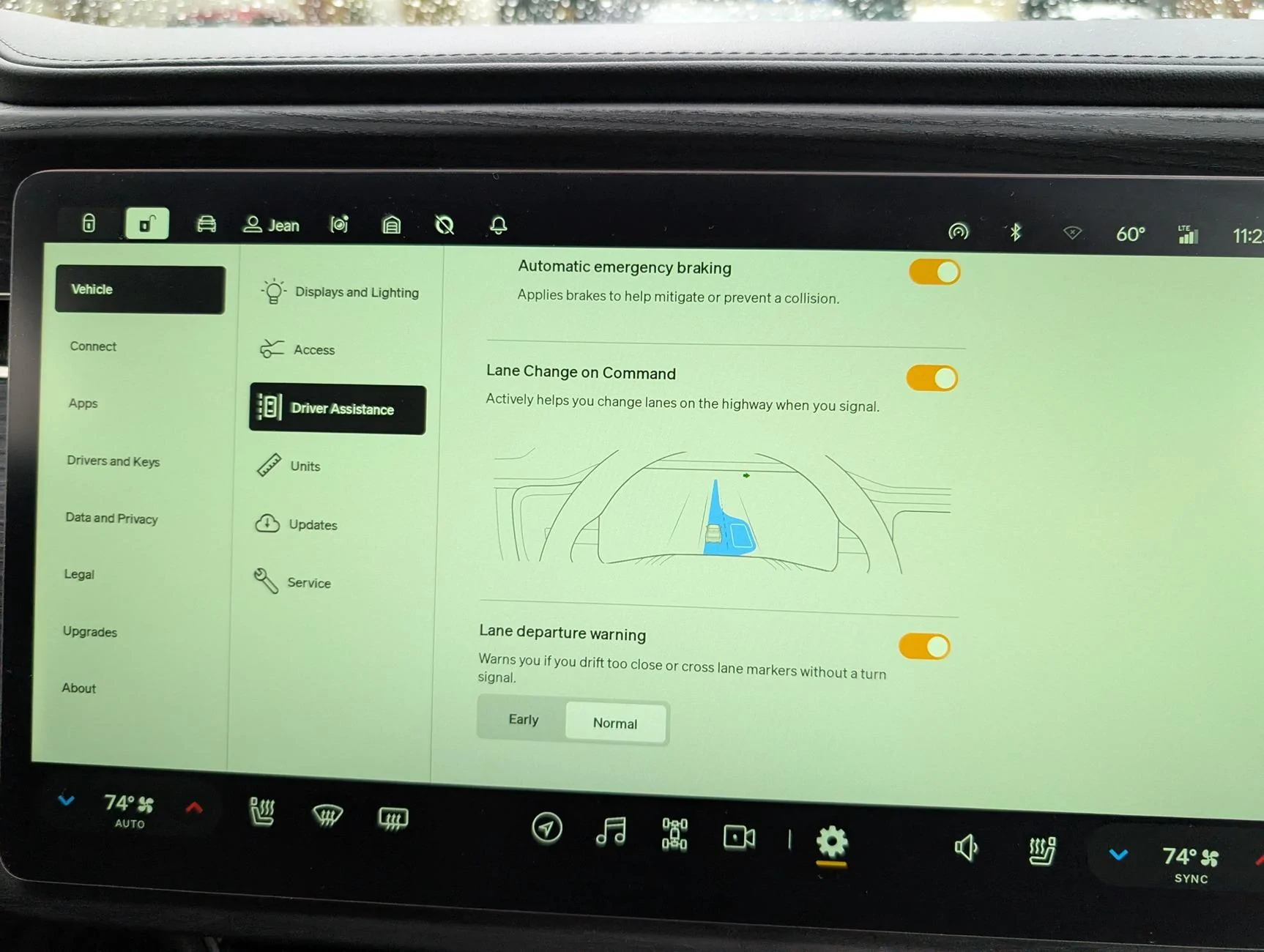

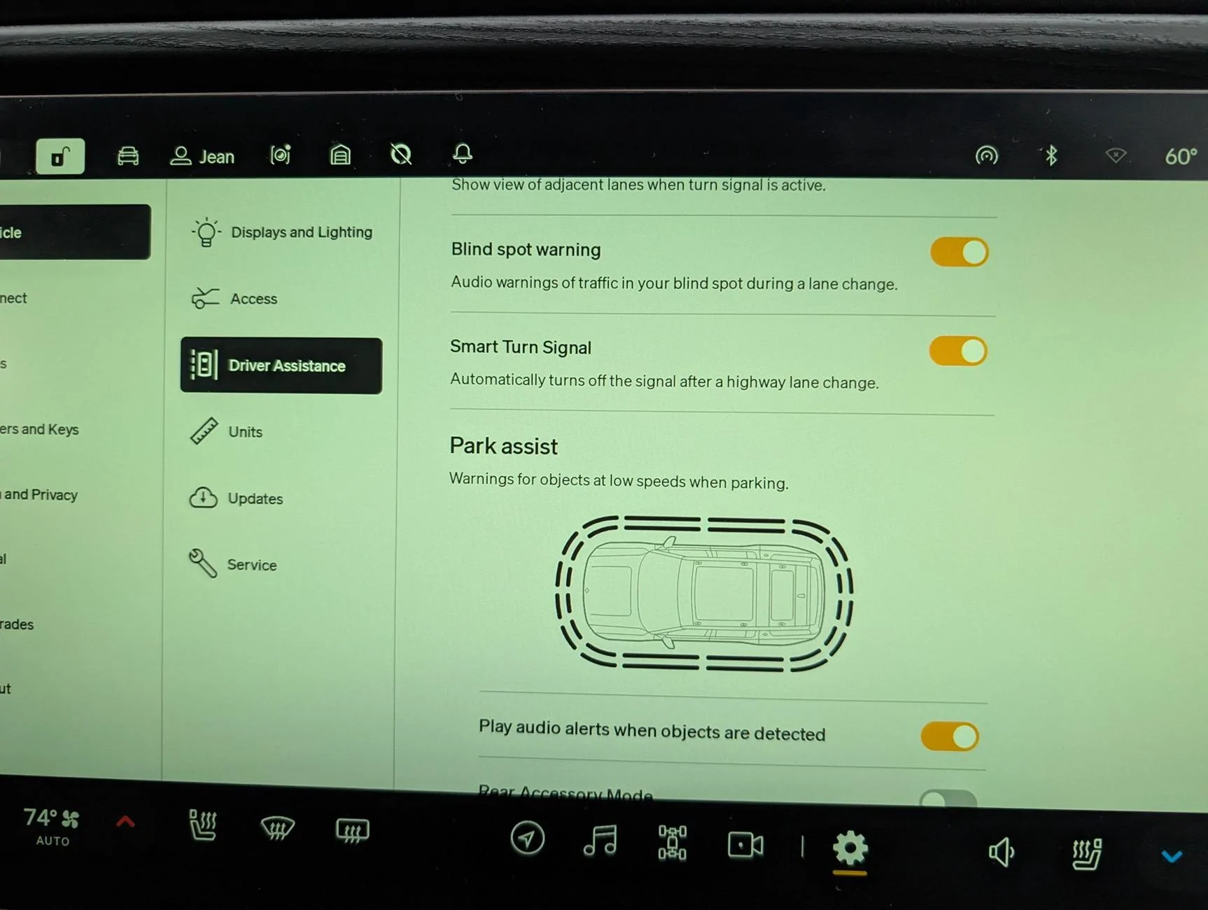

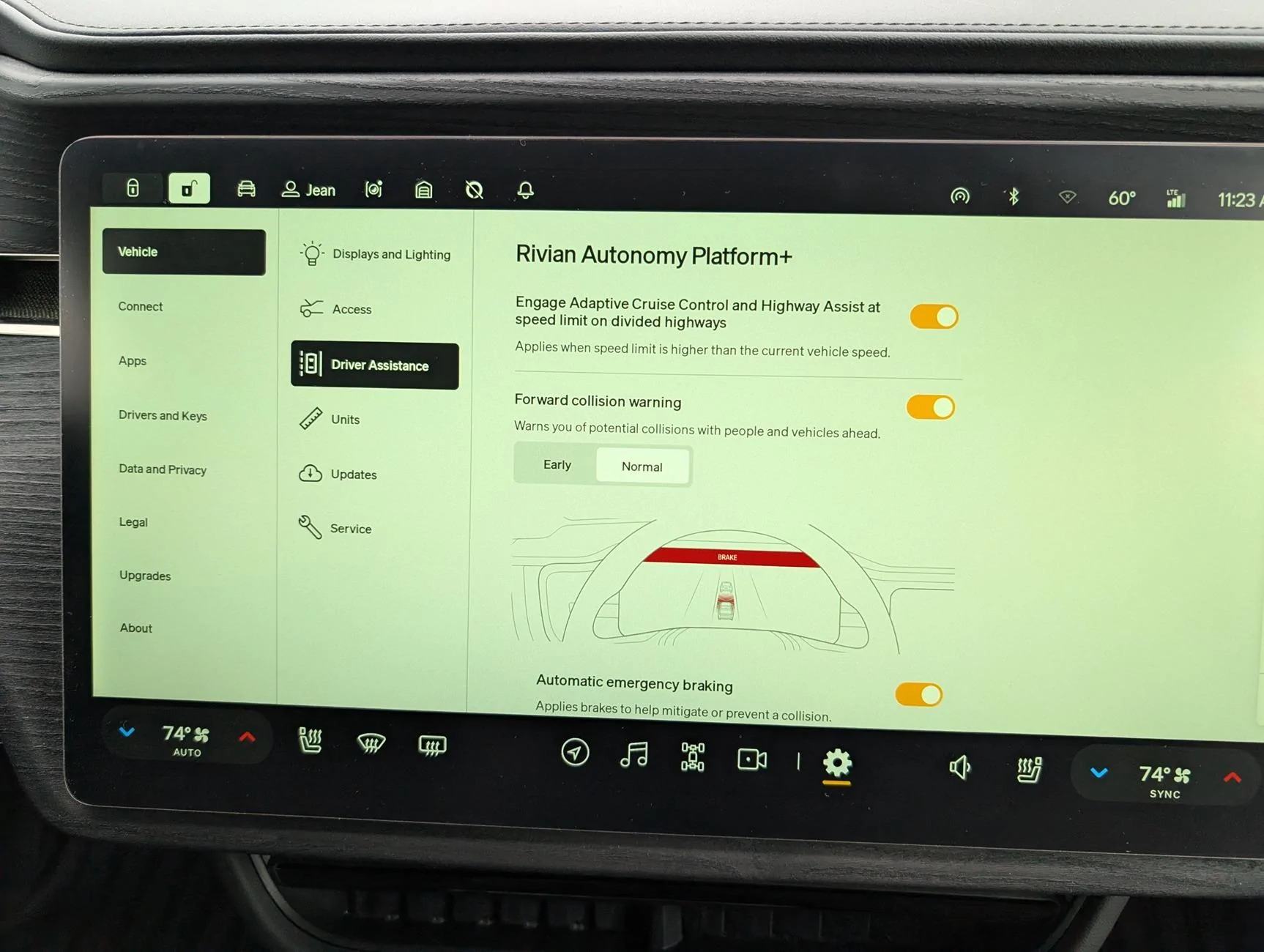

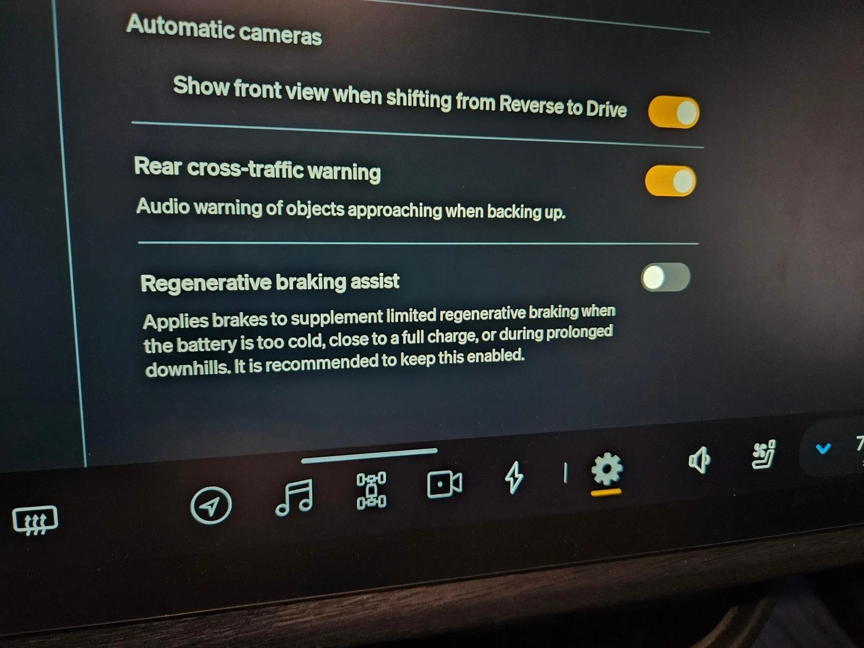

I guess I don't know where to find " Settings > Driver+ > Regen Brake Assist. "
In settings I have no "driver +" option. I have a "driver assistance" option but there's nothing about "regen brake assist" in any of those options. Here are some screenshots:

Brake assist was introduced with OTA 2023.50.01. Settings > Driver+ > Regen Brake Assist. It's set to on by default, hence, referred in other posts as an opt-out if you wish not to have it. As described in the onboard UI, it blends in the hydraulic brakes as needed under certain conditions—where regen is reduced due to high SOC or during long descents. What isn't known is if the hydraulic brakes are also used, without driver's knowledge, outside of these conditions. And some people are speculating it does because of the uneven wear they are observing.
