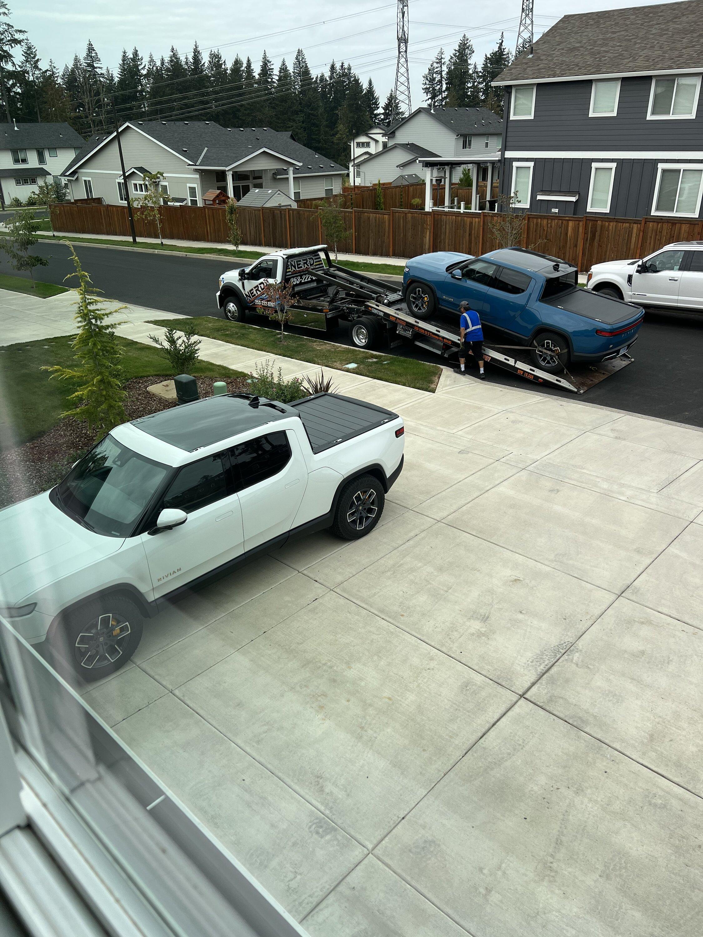

9/15 update. I have a working truck… too bad it isn’t mine.
Headed back to Bellevue today. No word so far on what they plan on doing to fix it but they may not know. Fingers crossed they get it right this time.
At least I got a Rivian loaner this time, which they towed down and swapped out. I was clear though that an Enterprise rental wasn’t going to work this time because I have vet appointments I need to be able to get to.

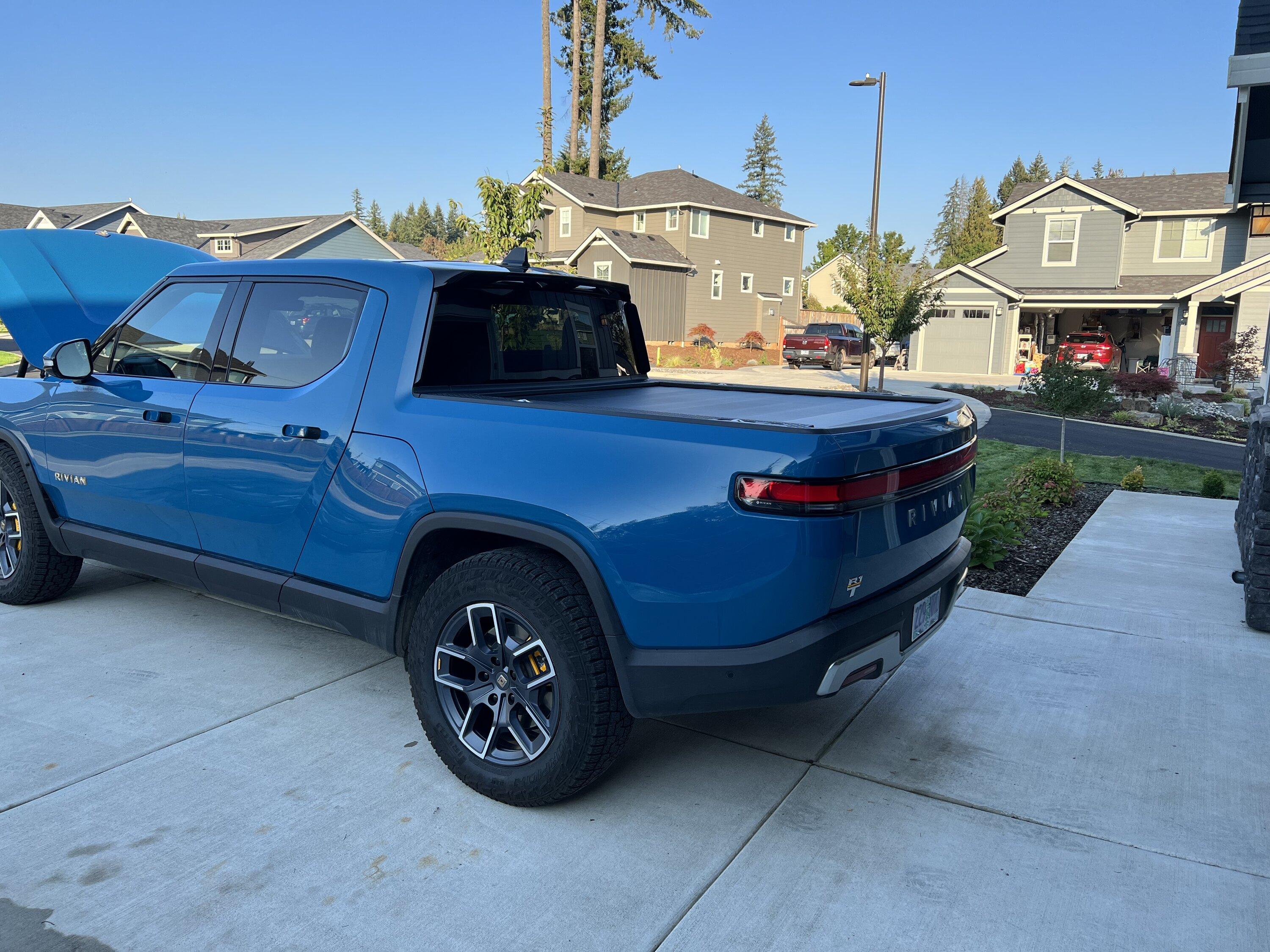

She’s home and it goes up and down again… only took a month. Hoping no more service needs for a while 🤞
