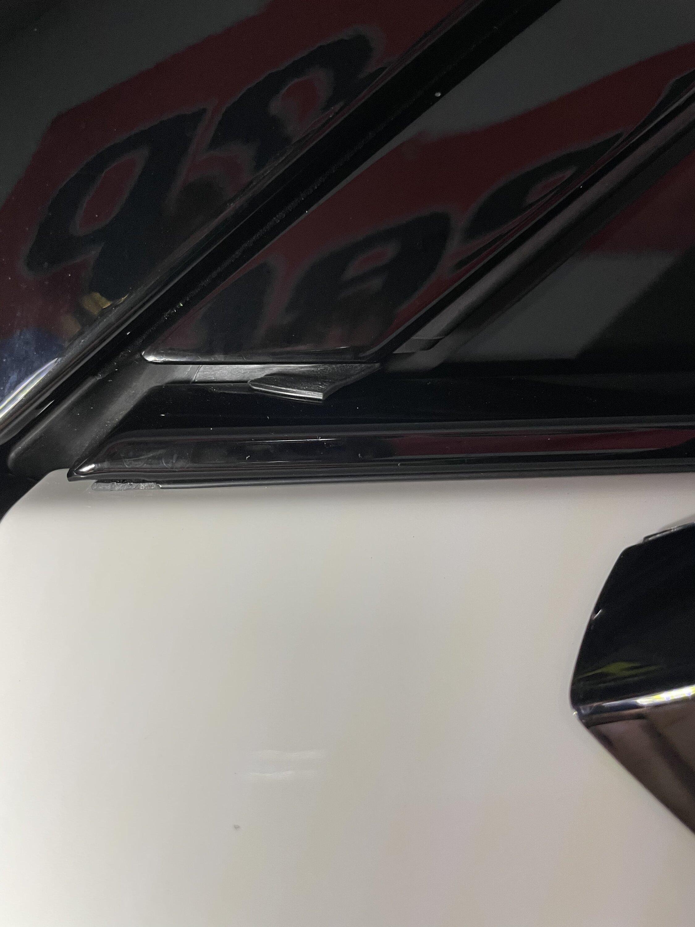

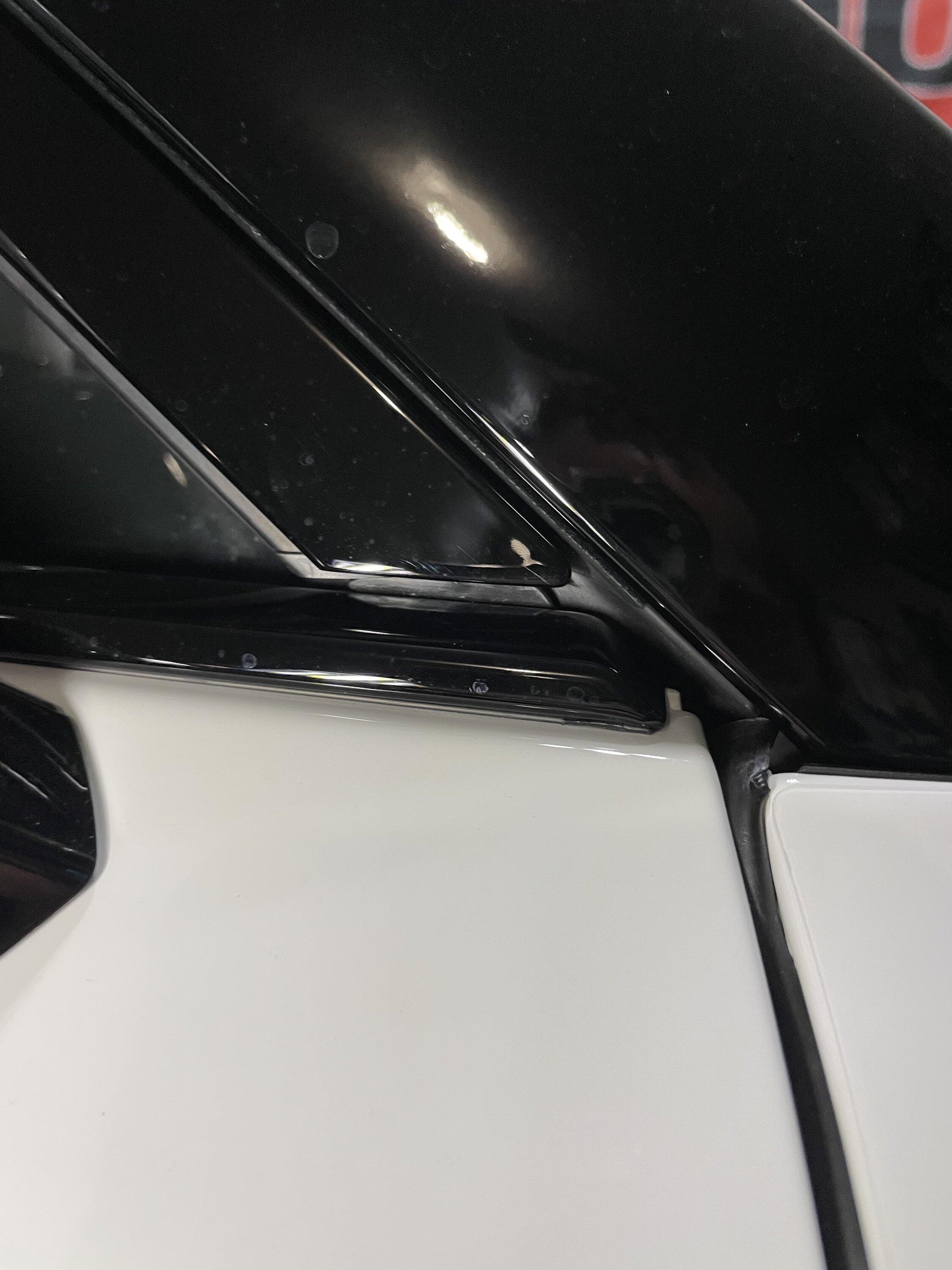

I had wind noise on my driver’s door as well. I inspected everything a little closer. I had already found/fixed an issue with the rubber trim between the A-pillar/fender on the driver’s door, but that did not fix my issue.
I just found another issue on the driver’s door compared to the passenger and fixed it. I can report back later if that fixes my issue or not.
First image is the passenger side and second picture is the driver’s side. The rubber trim was not tucked behind the molding on the driver’s side like it was on the passenger side. I could see this kicking up some wind noise.

Corner of your trim looks quite a bit worse than mine did. It's certainly a noise contributor for you.
The cabin noise is reduced after I fixed the rubber seal, but it’s still louder on the driver side than the passenger side (pretty much silent on the passenger side). I have taken a picture of the gap to add it to my mobile appointment on 9/23. They’re already replacing the trim on the rear door, so I might as well have them replace the driver’s side too.
